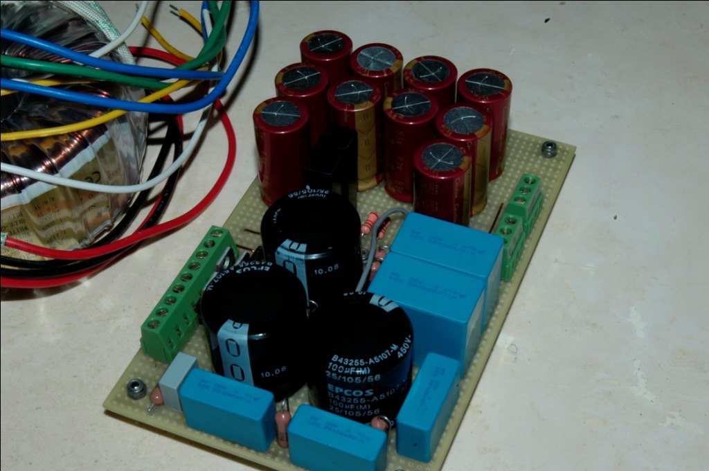

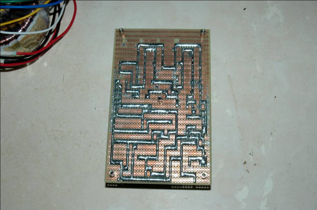

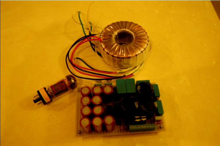

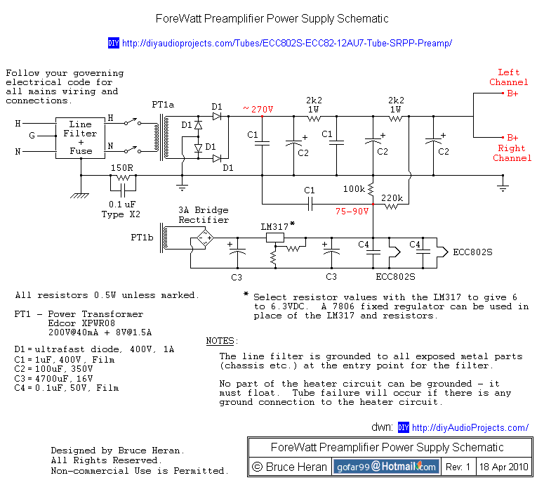

One thing that I have already completed is the power supply. Is there a circuit that I can build on a small board that will get the voltage down and constant current that is needed? I can also change some of the resistors in the circuit to knock the voltage down.
I just didn't want to scrap the PSU and start over. I am using a AnTek 200v 100va Toroid that has two 115v inputs and two 200v outputs.
Attached is the schematic and a couple of photos. I did use a handful of Elna Cerafines on the heater side that I had on hand instead of the 2 caps that the diagram called for. Probably overkill, but it works.
Any ideas would be helpful

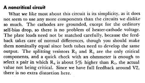

There is always the danger of fashion in audio. However, this phase splitter can provide poor balance. Essentially, the second triode is acting as an anode follower - like the inverting op-amp configuration. Two snags arise from that. A triode does not have the near infinite open-loop gain of an op-amp, so the gain of the circuit is not the -1 that simple theory predicts. The 47K resistor loads the error voltage at the junction of the two 220K resistors, so a lowish gain is reduced further. The effective open-loop gain might be only 10-15, so you could get imbalance of over 5% quite easily even with perfect resistors. The two triode anodes have quite different impedance, much lower for the second triode so there is a risk of HF imbalance as the two halves of the output stage will have similar input capacitance.Out of curiosity, why does no one like the 'paraphase (seesaw) splitter/driver'?
The first imbalance can be improved by adding a resistor to one of the 220K. The HF imbalance is harder to fix. At least your circuit uses 6SL7 so you have reasonable gain to start with - I have seen this done with 6SN7 or similar where the open-loop gain for the phase splitter might be only 5!
That power supply work you've done is very nice, great soldering work! But on the original topic, my go-to tube for moderate gain/high linearity is the 6SN7 or it's 9-pin equivalent, the 6CG7, an Aikido using these makes a very nice low noise, low-gain (about 10) linestage. I have several 6CG7 waiting to become a cathode follower preamplifier myself, although a 12B4 is also an excellent choice, I just simply don't have any.

Your easiest answer is a Voltage regulator.
there should be a high voltage example in the National Semiconductor app note for the 317 voltage regulator chip. Its explained on Page 342 of Morgan Jones "Building Valve Amplifiers, Third Edition".
The other option is to download PSUD2 and experiment with the resistors until you found a solution.

Or swap the lower 270K for a 330K - although this might take it too far.
I wouldn't worry about it.
I would. It's the classic, "Yes, it's nonlinear, but feedback cleans that up." It's always better to have a good, linear, well-balanced circuit to begin with, THEN apply feedback to drop the source impedance and increase linearity further. When feedback is limited (which it is with the posted circuit), the imbalance and nonlinearity is not well suppressed.
It's no harder to start with an intrinsically good circuit.
