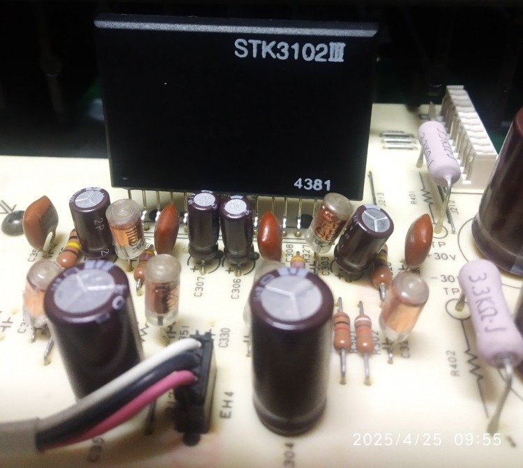

Right (R) channel not working.
Components found faulty during diagnosis:
  • Short-circuited ICs: Q301, Q302, Q303, Q304, Q305
  • Burnt resistors: R306 and R305
  • RT301: Open circuit
We replaced the STK module, but the same problem persists.
  • Issue: On pins 10 and 11 of the STK3102-3, we measure + and -59V DC (measured with respect to ground).
  • We isolated pins 10 and 11 of the STK3102-3 from the amplifier circuit, but we still measure 59V DC on them.
  • We removed ICs Q301, Q302, Q303, Q304, and Q305 to isolate the amplifier section.
Tests performed:
  • Correct measurement: On pins 5 and 6 of the STK3102-3 (Left channel), we measure + and -1.2V DC, which is correct.
  • Resistors and capacitors in the STK3102-3 bias circuit are within correct values:
    R301 & C301, R302 & C302, C329, C307, C304, C305, C306, C303, C308
  • Continuity test passed on the -B and +B power lines
