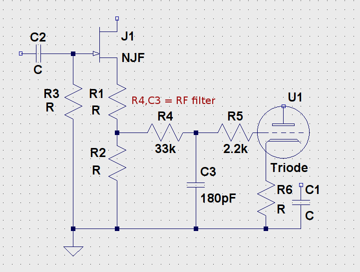

...if anyone has advice on how to best implement the 34k/200pf low-pass filter, whether on the source follower or first triode, I'd appreciate it.
Why not between the input JFET and first triode? (See attached schematic.)
This assumes the triode is properly biased, negative voltage on the gate, perhaps achieved using one of my previous suggestions in this post.

...I might just live with a positive bias. I'll try that filter before the triode, thanks!
You're quite welcome. 🙂
If bias is positive, and there is appreciable grid current flow, that series filter resistor will drop voltage across it, which will affect both the DC operating point, and the distortion signature, of the signal emerging from the triode.
This may or may not turn out to be a bad thing, in terms of how it sounds. But keep an ear open for it!

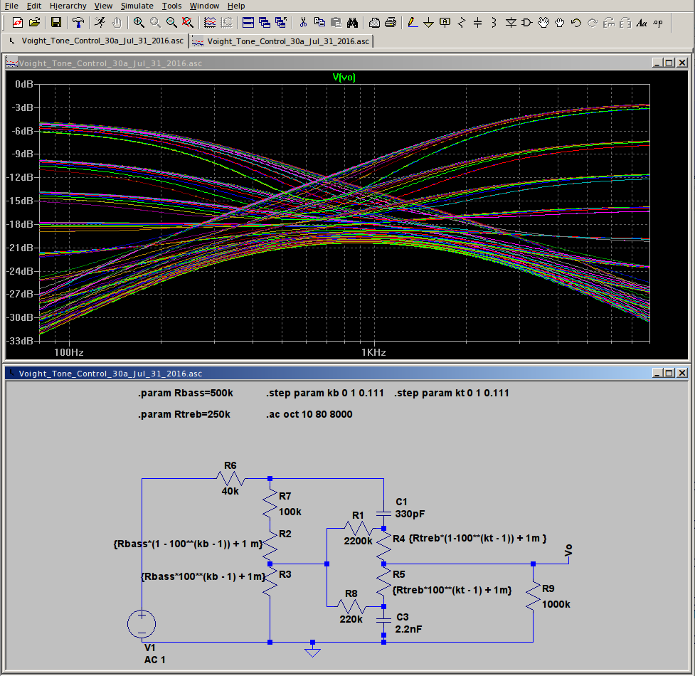

After lots of tinkering, here is my favorite passive guitar tone control so far - see my post #1902 in this thread: http://www.diyaudio.com/forums/inst...ndred-buck-amp-challenge-191.html#post4788755
What I like about this circuit is that it is very easy to use. Tone changes are very linear with pot rotation, and the two controls are almost completely independent of each other, so setting the bass doesn't muck up the treble, and vice versa.
In fact, this circuit behaves a lot like the good old active Baxandall tone controls that used to be on virtually every Hi-Fi amp, until an idiotic swing of audio fashion caused the complete disappearance of all tone controls from Hi-Fi.
From my perspective, the only real weakness of this modified Voight tone control circuit is that you can't load the output with anything less than 1 megohm, and 2 megs is better. If you load it down more than that, you loose bass boost capability.
My tweaked version of the Voight does have substantial insertion loss, but this was necessary; in a passive circuit, you cannot substantial boost and cut range without also having substantial insertion loss. If you want, say, 15 dB of boost, you have to start out with 15 dB or more of insertion loss!
I created this particular circuit, starting with the Voight tone control implementation in Merlin Blencowe's preamp design book, and tweaking it heavily until it worked for me. I really like the results, but, as far as I know, I'm the only person on planet earth using this circuit.
That means I have no statistics on what percentage of guitarists like it. So, you may like it, or you may not, I have no idea!

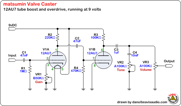

Recently another thread here brought up the "Valvecaster", and then the "Valvemaster". Both are low-voltage, 12AU7 based guitar overdrive/distortion circuits. These appear to already have a following, so may be a good starting point.
These two are considerably simpler, and very different from, Merlin Blencowe's and Andyholme's approach. Perhaps better suited for someone entirely new to electronics.

Gnobuddy said:
After lots of tinkering, here is my favorite passive guitar tone control so far...the only real weakness of this modified Voight tone control circuit is that you can't load the output with anything less than 1 megohm, and 2 megs is better.
That looks quite promising actually, although the dB loss at flat response is a bit more, that can probably be dealt with. I've been toying with the MOSFET stage at 2Meg input impedance anyways, so that wouldn't be a problem.

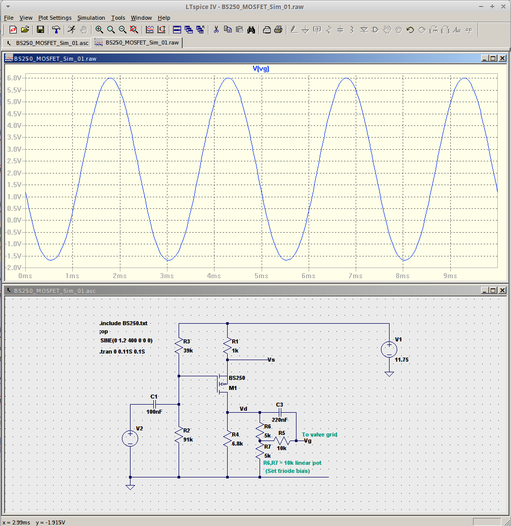

What I've been hung up on ATM is clipping at the negative rail in the MOSFET stage. I don't want to clip so much at that stage so a higher operating point at drain makes sense, but the drain operating point is also setting the grid voltage of the following stage. Even running with a positive grid bias (so the cathode is lower than the grid), Vk is still about 3V or so when I'm getting enough swing out of the MOSFET to drive the triode to clipping. I tried isolating the grid with a capacitor and biasing the triode separately, but couldn't seem to avoid a farting negative Vgk.

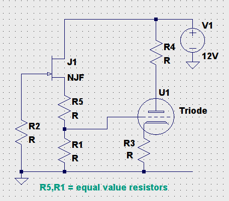

...clipping at the negative rail in the MOSFET stage...higher operating point at drain makes sense...drain operating point is also setting the grid voltage...
Three possible solutions are attached.
Possible solution one replaces the FET source resistor with two equal value resistors. You lose 6 dB of voltage gain, but you also get double the DC voltage at the FET source, while still maintaining the same DC voltage at the triode grid.
The open question is whether this will improve your clipping problem or not - you now need twice the voltage swing at the JFET source to get the same swing at the triode grid. Perhaps the benefit of having twice the DC voltage at the source will be lost because you also need twice the AC swing.
Possible solution two is the same as solution one, except the upper source resistor is bypassed with a capacitor. That takes away the 6 dB loss in AC gain, but re-introduces the possibility of (triode) DC bias shifting in response to grid current flow through the cap. However, the fact that there is a fairly low-value resistance in parallel with that cap, should minimize this effect, by providing a rapid discharge path for the capacitor.

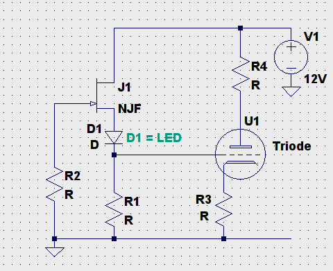

Possible solution three uses an LED to drop some DC voltage between the source and triode grid. The DC voltage at the JFET source can be higher by a couple of volts (the LED voltage drop). The catch is that there is the same DC voltage as before across the FET source resistor - so you might still have the same problem of insufficient headroom for AC voltage swings.
Yeah, grid current flow and coupling capacitors don't mix well. I've spent a lot of time fighting this sliding-bias problem, and haven't found any clever new solutions yet.
Thanks, these approaches are quite ingenious. My problem is in fact with the MOSFET stage, but I've still tried to apply the same approaches. I figured I'd run some simulations before I threw this on the breadboard, although I've left the triode out since the models don't simulate well at low voltages.
As you can see the results don't seem to improve the situation, although I may be misunderstanding the theory behind it, or it may not be applicable in this situation. You'll have to let me know what you think. Other than that, I've had some minor progress fine tuning the bias with a signal generator.
Andy - too many things to explain, and I have little time, so I'll have to be brief and selective.
  • Your MOSFET stage works quite nicely with around 1mA of source current.
  • The quiescent current through the MOSFET has to be larger than the largest peak (current) signal. If you have 1 mA DC current, your AC signal swings have to be smaller than +/- 1 mA - otherwise, the device will clip.
  • You can't dial the DC bias current up and down without also having the AC headroom affected (see previous comment).
  • With a bypassed source resistor (cap), the MOSFET has a voltage gain of around 33 times. Max peak-to-peak output volts is less than 6.6 volts; divide that by 33, and max input volts is only 0.2 volts peak to peak.
  • If you want a larger input signal capability, you have to lower the gain of the MOSFET. Take away the source bypass cap, and you can handle 2 volts peak to peak (see attached LTSpice screenshot.)
  • Trying to mix DC and AC operating conditions in one FET stage is a recipe for frustration - but I may have found a way to do it (see attached LTSpice screenshot). R6+R7 is a 10k linear pot to set the triode bias. This pot will sound scratchy when turned, because there is DC voltage across it - but at least it won't mess up the MOSFET operating point every time you try to change the triode bias!
  • All FETs have huge parameter spreads. The one you use probably won't work exactly as LTSpice modelled it. You may have to adjust R3 and/or R2 to get 1 volt DC dropped across R1 (this sets 1 mA through the MOSFET).
  • Biased to 1 mA, the circuit can spit out a 4V peak-to-peak signal without clipping (see screenshot).
-Gnobuddy
Gnobuddy said:
too many things to explain, and I have little time...
No worries, I've been a bit busy myself lately, and hints are enough for me...usually.
You're right, actually that's right where I had fined tuned to used a signal generator, but why is that so? Did you discern that from the datasheet somehow?
I see, I think it makes more sense how voltage swing relates to Id now. In this case I've kept the bypass capacitor since this stage is right after the tone stack (lossy). Once I switch to a lossier tone stack I may even need more gain to drive to distortion, in fact.
Yes, this works perfectly. I still have some more to read about triodes but this is letting me tune the biasing exactly how i had wanted, brilliant!
