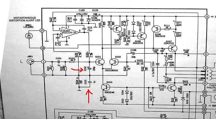

My Adcom GFA-555 MkII is blowing supply fuses on the L channel. I found some GFA-555 schematics here but they don't match what I found on the actual PCB. Even the reference part numbers are wrong.

Can someone kindly share a GFA-555 MkII schematic and parts list if they have one?

Input power amplifier.

Did you ever find the parts list?
I have a bad amp as well and suspect the input side.
Of the schematics I have seen, they were too small to read.
Can someone tell me what values correspond to the numbers on the input board capacitors?
One listing says C101 and C151. THey look like big pink square blocks. I have never seen a capacitor that was a pink square.
The do not measure like most capacitors. They both have a fixed resistance of around 1000k ohms, they don't change value on my multimeter diode setting. What does that mean? IS this really a resistor?
