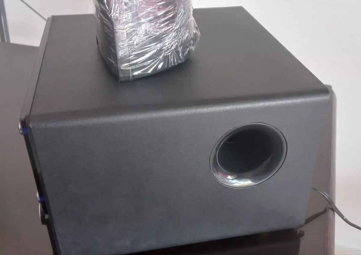

Hi there.

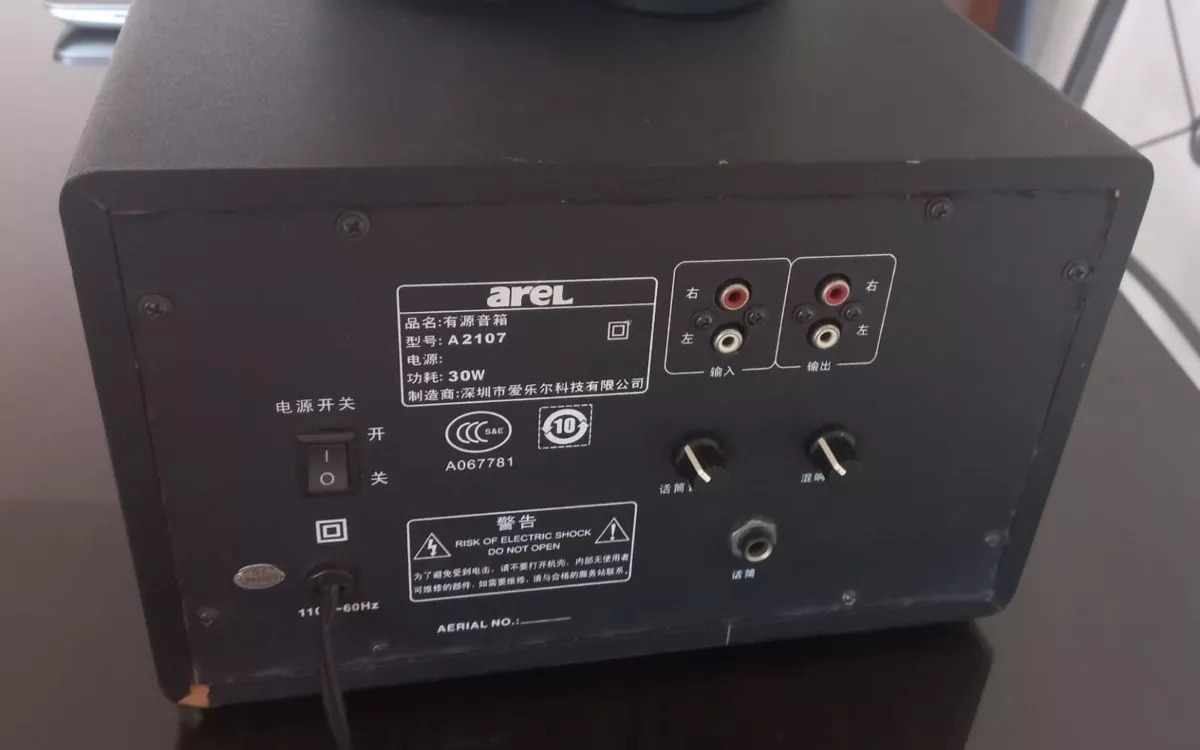

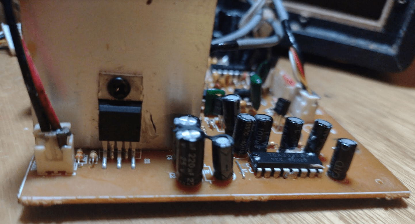

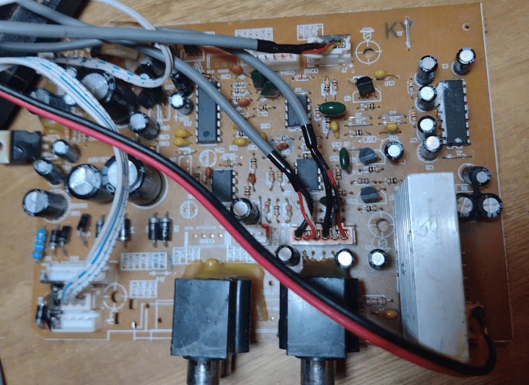

I got a used wooden amp box cheap, 7USD. It has a TDA2030a for the bass and it worked in a test when I moved cables, the main output is burnt, shorted speakers were connected.

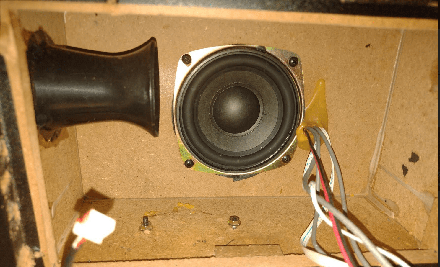

I found it interesting because it has a 4th order band-pass in the box. I hadn't seen it before, but I hadn't seen too much so maybe this is common. The back of the speaker in the photo is isolated with the sealed part. I couldn't find similar devices it with image searches nor with the model in the label.

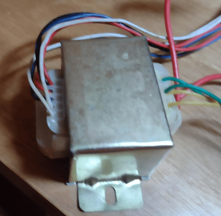

The transformer gets hot, wondering if it's because something's shorted in the board. I'll test in a few days.
I think I'll try using a TDA7850 for 2 full range drivers and 2 tweeters and a Tpa3118 for the speaker that came in the box. I watched this review for the TDA7850 and by reading the datasheet I think that by pulling less watts and using 8ohm it could sound good.

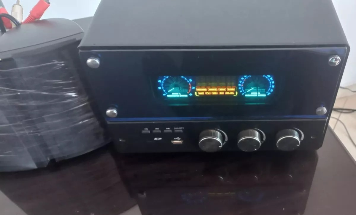

I could build another front panel and reuse the glass if I put a Raspberry PI I have around, with display.
Thoughts welcome.

One restriction is that if I change the volume of the transformer too much I will ruin the computation of the bandpass.

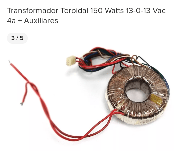

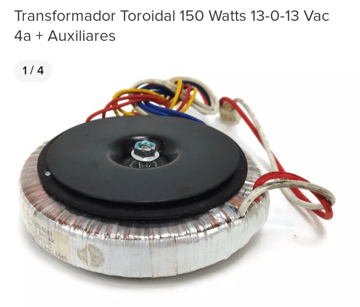

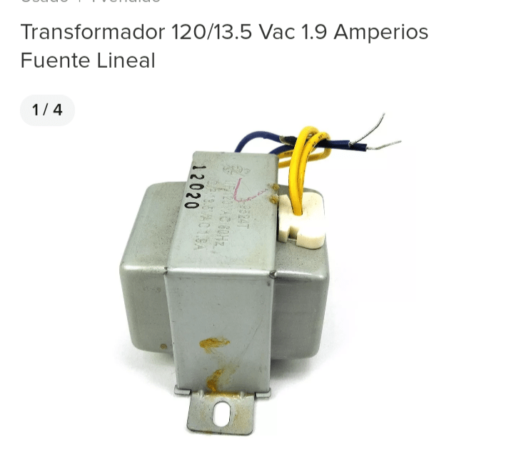

I noticed that I could get used toroidal transformers here with a 30 day warranty. Price was good. So I grabbed two and a smaller one.

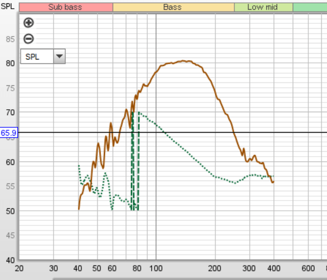

I measured the 4th order band-pass with no eq. Graphs follow. I could use the enclosure space for electronics and use an external sub.
It would be nice to keep the 4th order band-pass working though... Would you?
Port 1/48:
50cm 1/48:
