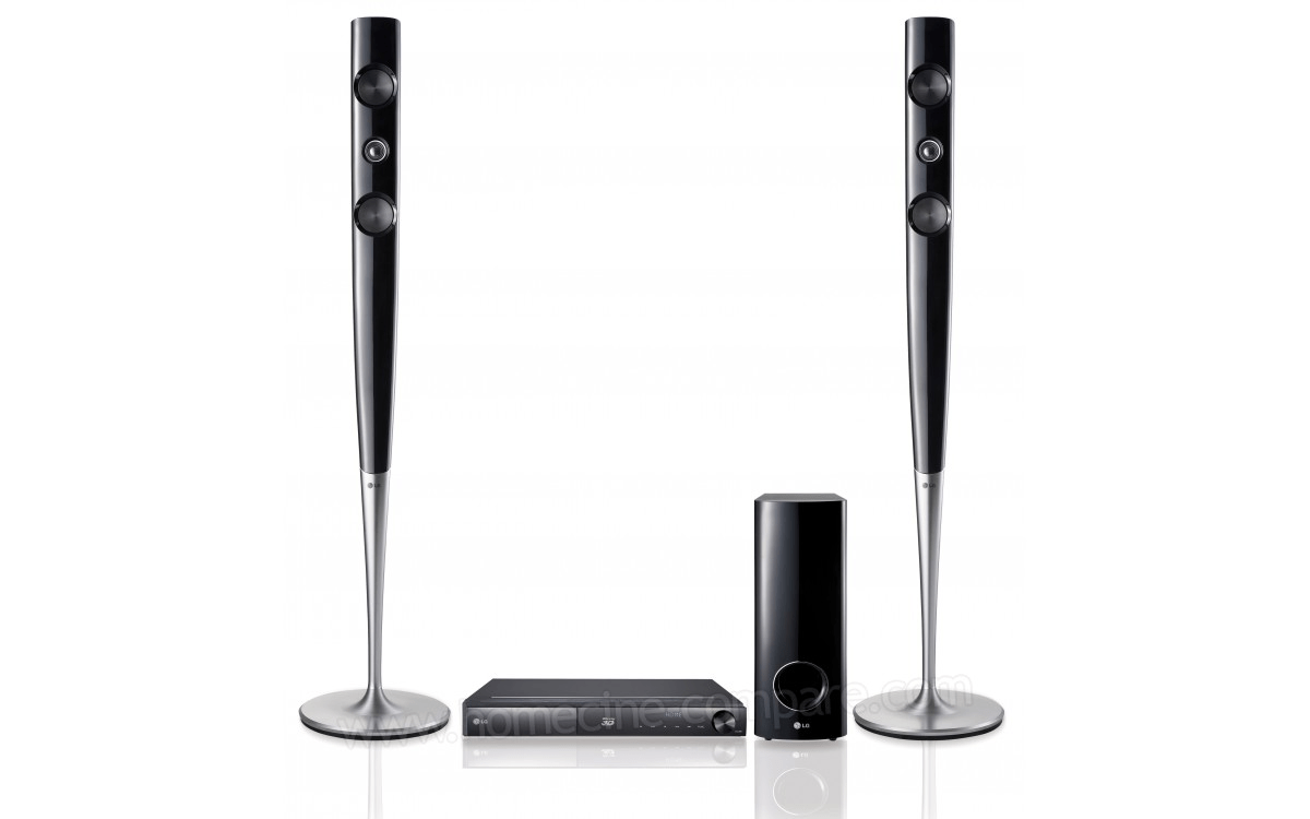

What I currently have are two speakers and a subwoofer :
I love their style, but it's a shame that the quality of the amplifier is mediocre, with issues of freezing. I've already fixed a freezing issue myself (I tried many solutions and don't even remember which one solved the problem). Right now, I don't really feel like trying another repair

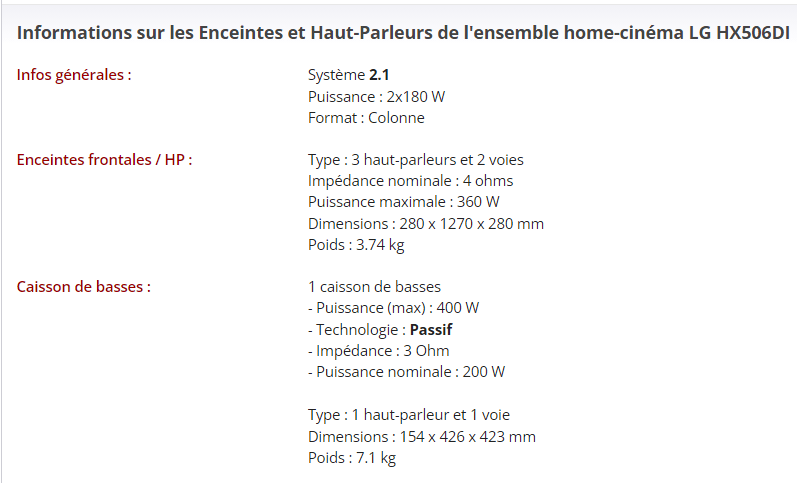

Satellites specified as 4 ohms, subwoofer 3 ohms, those i would call low impedance. This rules out many designs, and in case of tda7294/7293, you may even need several ic with master/slave parallel connection, to handle such loads. Or use single ic's , but underpowered .
