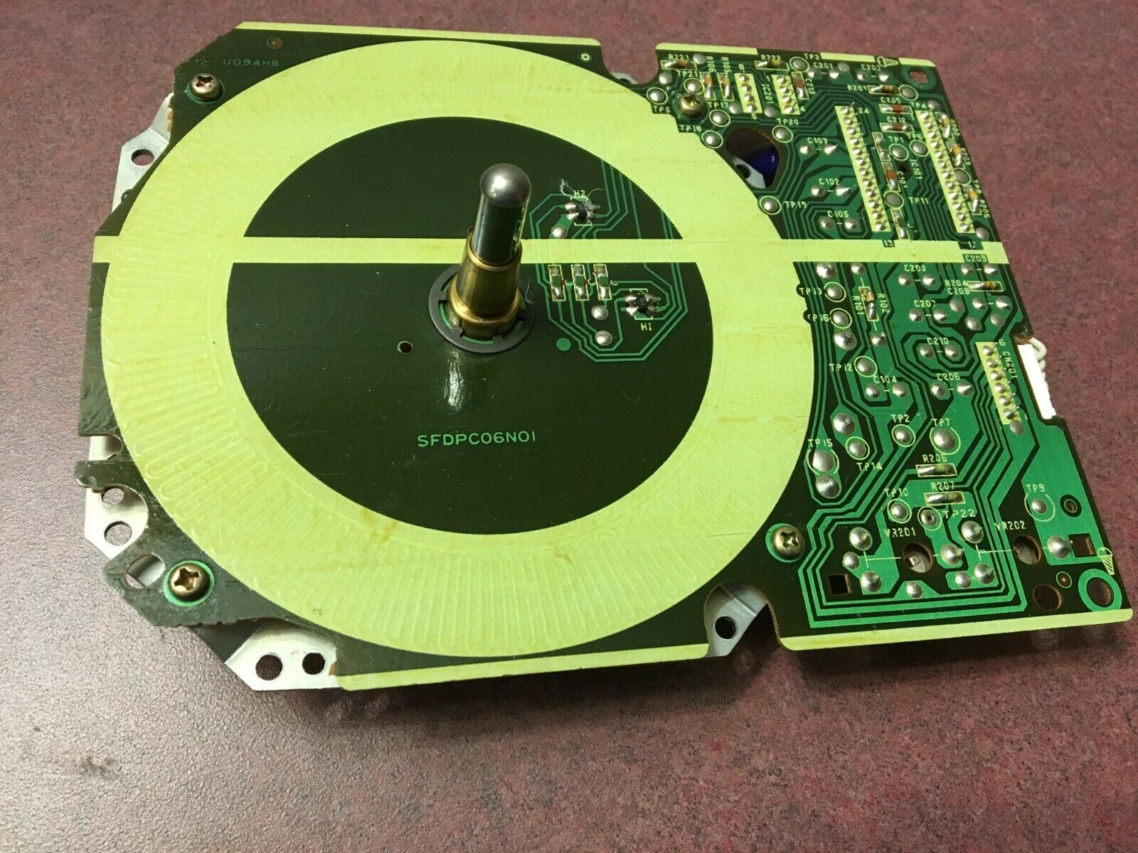

I recently purchased a Technics SL-6 linear turntable on eBay. A crucial piece of the tonearm assembly was cracked. I ordered a replacement part on eBay and again, that same piece was cracked. So I'm a bit convinced this problem may be due to a design/manufacturing issue. Of course, these things are thirty years old, so there is that.
I wondered if it would be possible to save the motor/platter assembly, and make my own non-linear turntable by adding a more conventional tonearm I'd source on eBay.
The mechanics of mounting the motor are simple enough for me. But the motor has a board with a 6-pin connector. The connector has one brown and five white wires.
I'm not sure if there is a way to apply power to this board and simply have it spin the platter at 33 or 45-RPM (honestly I don't care about 45-RPM). I'd think if that was possible, I'd see a three-pin connector?
So I figured I'd ask here, maybe someone knows whether what I want to do is possible, or if some of the circuitry needed to control the motor is on the larger "logic" board, to which this board is connected?

I've posted pics of the model of motor, any thoughts or ideas?

You need the rest of the electronics and power supply that go with this motor. Alternatively if you have the schematics and sufficient experience you may be able to cobble up what is needed. Based on the questions asked I believe you would be best off to salvage the other bits of off the original table.

Edit to add: Wife left so I had a chance to tie 3, 4, and 5 together and it spins at some high speed. With 4 and 5 tied together, it is spinning very near 33-1/3-RPM. There are two adjustments on the motor itself for 45-RPM and 33-RPM, with instructions to adjust them in the service manual. So I'm fairly confident that any adjustment needed is simply because I switched the power supply, perhaps to a switching supply.
At this point, I'm just curious how I could get the motor controller to spin at 45-RPM...
(My earlier post follows)
Alright I studied the service manual last night and was also able to power-up the old turntable today even though I can't operate the unit because the top cover/tonearm is disconnected.
Pin 1 (brown) seems to be common, pins 2 and 6 are +12vdc. I cut the end off an old wall-wart and wired it like that, and plugged the wart in, no spin but no smoke.
So I added a jumper between 3 and 5 (I think) and the platter spun quite fast. I moved the jumper from 3 to 4 and the unit didn't spin. Finally, I moved the jumper from 4 to 5 and by the looks of things, it was spinning at 33-rpm. I think. The wife came into the workshop area and was showing me something and I stopped.

Final follow-up, in case anyone is following along...
In looking at the schematic they show L being 33-RPM and H being 45-RPM.
I figured I needed to connect pin 3 to 12v. But that didn't work (just super high speed again).
Then I remembered the table has a 33-RPM/auto/45-RPM switch. I had previously tested with the switch set to 33 or auto. So I re-tested with the switch at 45-RPM and saw that pins 4 and 5 now had +12v (whereas there was no voltage there before).
So a quick test with the motor does indeed show that sending +12v over pins 4+5 yields 45-RPM.
So I think I have a working solution for a DIY table motor + platter.

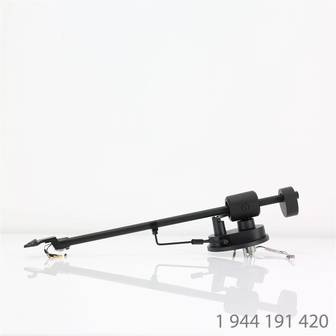

The Pro-Ject Elemental tonearm (1944 191 420) is available as a new replacement part here in the UK for only £60.
About as simple as it gets. Don't know about USA availability though.

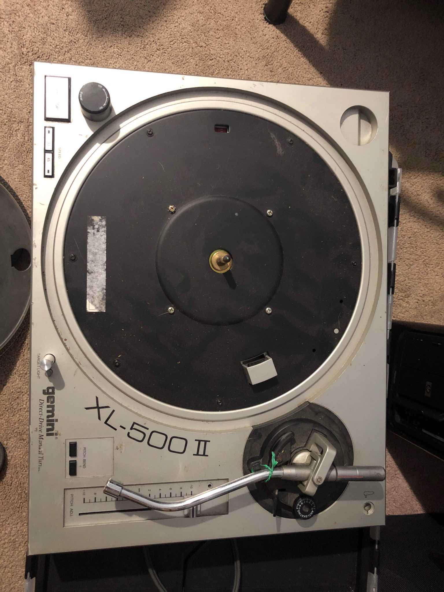

I may have an old table or two laying around that you can have for the shipping fees
I’ll have to look and see what parts are still there and what tables I have. Let me know if you want one
Well I'd be very interested if there is a tonearm I can harvest. If you let me know the model #'s I should be able to google some images and see if the tonearms would work.
Gemini XL-500II
Sorry it’s missing some parts
View attachment 1 View attachment 1
Funny, I was looking at a Gemini tonearm on eBay earlier. I think it checks all the boxes.
I’ll pull the arm out ,that way your not paying for all the weight of shipping, it’s a pretty heavy TT
That would be appreciated!
I'll PM you my address and you can let me know how much for shipping and how you'd like your money (PayPal or whatever).

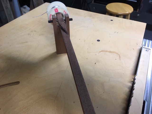

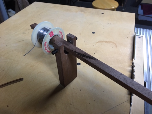

So while I've been looking for an economical tonearm solution (thank you Carl!!!), I decided to try a little experiment.
I had also been looking at DIY tonearms and tried to make half a gimbal using some material I scrounged up from the junk drawer and parts cabinet.
The "hinge" is made from two steel ball bearings pushed into the "arm," and two cup-type set screws.
Resistance is higher than I'd like. I'm not sure if a different size ball bearing or set screw would help. If the ball is riding on the edge of the cup, resistance might be higher.
I can see the advantage of the Schroeder tonearm where resistance is concerned, but I have a workable tonearm solution on the way so I'll likely just wait for that now.
But I figured I'd post some pics for fun.
You need pin type, hardened set screws for minimal friction. No additional bearing balls, but very small bearings without inner rings instead. And I'm quite sure this wooden arm will resonate like hell .
Best regards!
Because of the shape, or because wood arms resonate a lot?
Because this is just a test to see if I can make a very low resistance joint.
I'm going to get some smaller ball bearings. The current bearings are too large and are riding on the outside of the cup. I need bearings where the D is < the D of the cup, so there is a single point of contact.
