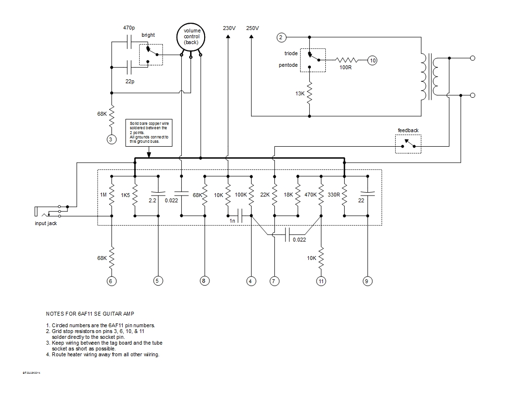

I'm actually thinking of getting my feet wet with one of the designs from the hundred buck challenge. This 6AF11 layout caught my eye:
