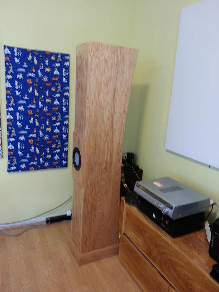

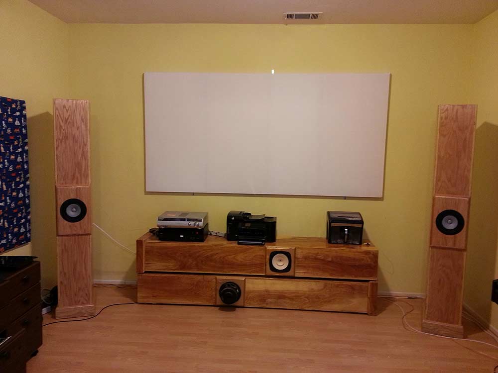

So I have been positioning the Aveburys as shown and playing through a DIY F2J clone and the sound was nice, clean and sweet.

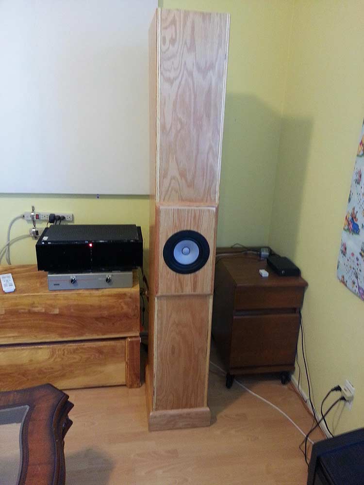

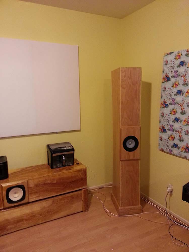

Then I built a bottlehead 2A3 SET and the sound is much sweeter, much more 3D. Then one day I decided to reposition the Aveburys so they are toed in, move them back toward the corners, and the backs face the corners and got rid of the file cabinets that were in the corners, it was just an experiment, I was anticipating that stereo imaging will suffer because of being closer to wall boundaries, but wow what a surprise, stereo imaging became much sharper, pin point accuracy. It feels like you can reach out and touch the vocalist. Sound almost like the sound I used to get from a pair of home made 150hz square front horn loaded with FE206E as far as the pin point accuracy goes. The tonality of the A12P and FE206E are no way near the same

They do sound huge, but the Sakikos I used to have I think sounded bigger. But positioning the Aveburys facing the corners do expand the soundstage to the point they rival the Sachikos. The Avebury's bass beat the Sachikos hand down. It was the addition of the 2A3 and repositioning that when the magic happened and ever since I look forward every night to go home and listen to some musics. I had a buddy over who has good ears and younger ears, but who is new in all this DIY HiFi stuff and I gave him a blind A/B test between the F2J and the 2A3 to see which amp he prefers, and after the test, he picked the tube amp with no hesitation. He said with the tube he was able to hear more details. In one song, he said he could hear the backup singers in the background that he could not hear with the F2J.
