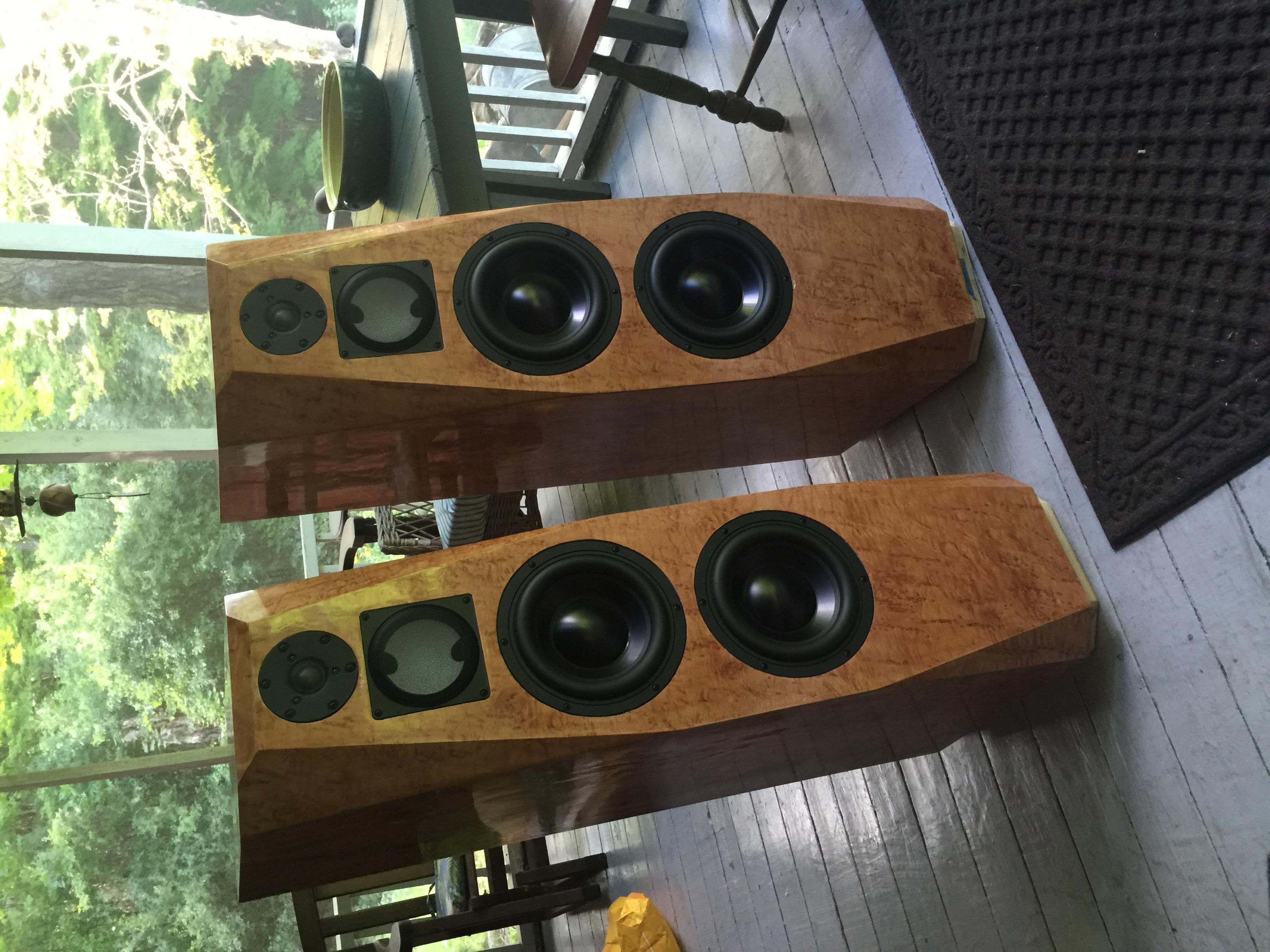

Does it count if a few years ago I said I could never do that but ended up doing it? Not really a clone, but an Avalon inspired design I found at HT Guide. Never thought I could cut the facets or do a decent job veneering.
http://www.htguide.com/forum/showth...nt-Reference-Thread-How-we-realized-the-Dream
When properly placed with decent electronics and recordings it has that 3D imiage out in space that fatmarley wants. Does a nice job sounding at least as good as the Avalon Time that inspired it.
Sorry about the sideways picture. It stays upright on my computer and phone.
