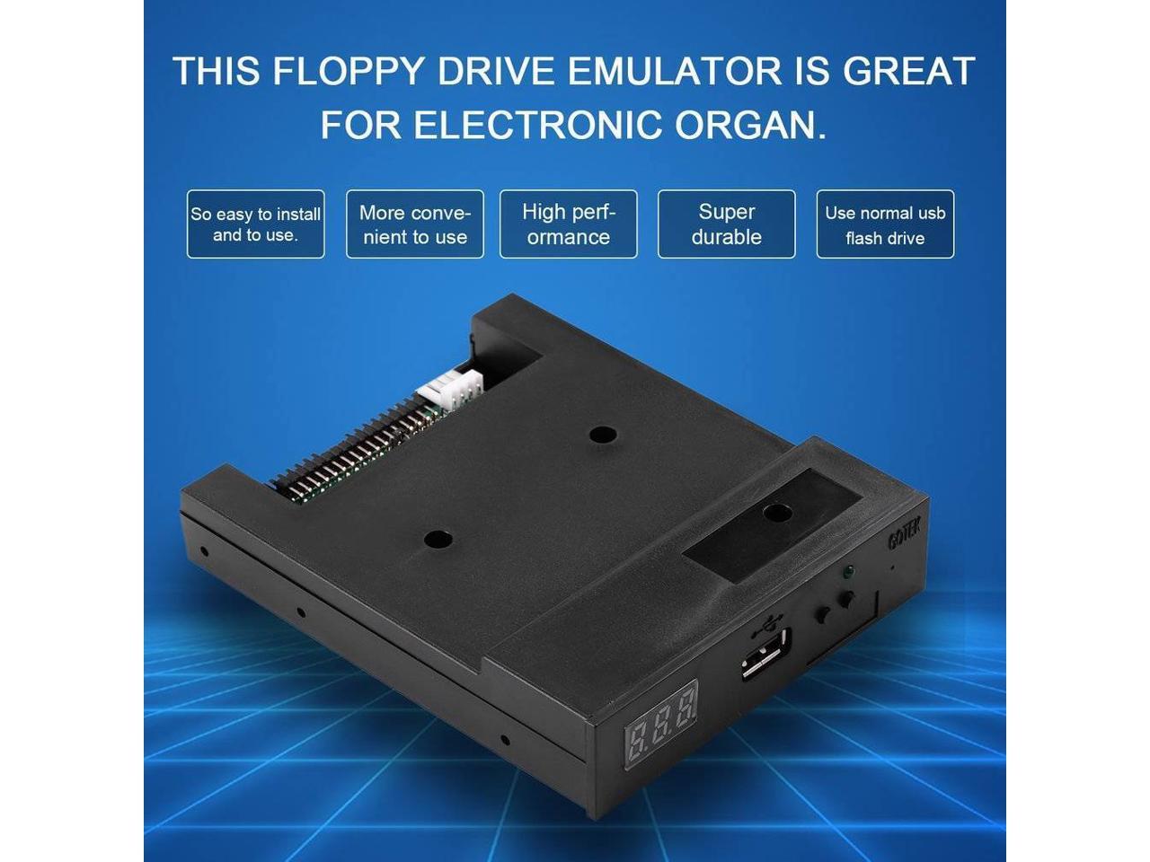

Floppy Drive to USB Flash Disk Drive Emulator
On the back side, your PC (or 'scope) thinks it is a 34-pin floppy drive. On the front, you think it is a USB thumb-drive hole. Everybody happy for $27.
I have never tried one, and have no idea if it is 99.9% compatible (and Tek uses some detail not emulated).

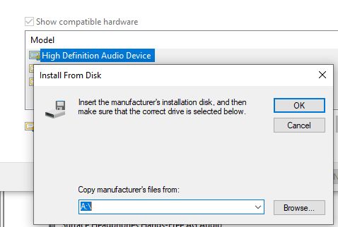

As a side note - I just today ran into A:\ as a path.... and on Win10 no less. Every time one tries to load a device driver manually via Device Manager it still after this many years defaults to seeking it from a floppy drive - amazing legacy. I should but one of these devices - my Windows would be so happy I'm sure.
