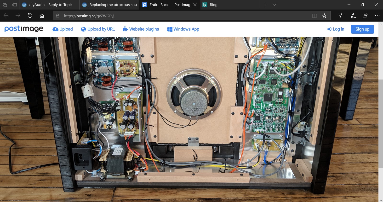

I spent some time today and drew up a schematic of the way the sound system currently works.
Looking at it, I have several questions:

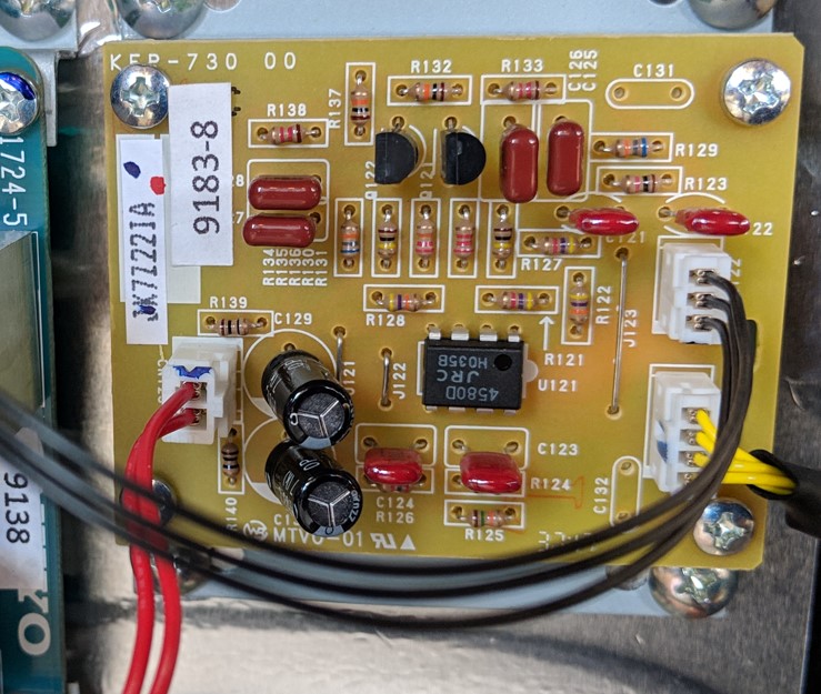

1. It seems that the mainboard has separate audio outputs for L/R channel and bass. I assume this means a digital crossover for the bass woofer? This is one issue that I may have to figure out that could impact driver selection.
2. I do not understand the pinouts or number of wires used on this system, it does not seem logical. For example, there are five wires coming off of the mainboard for the L/R channel output, which corresponds with five pins in the input of the Amp. But when the output of Amp 2 is daisy chained with the input of Amp 1, there are only three wires. Why?
3. Why does the bass signal need to be pre-amped, but the L/R channels do not?
4. Is there a way I can find out whether or not the signal coming off the mainboard is flat or processed to hell?
Here are some more pictures of the system. I would really appreciate any help!
View of the action with the cover off
Amplifier Section
Bass amp and Preamp
"Crossover"
How the drivers are mounted to the lid of the piano
View with back cover removed
Close up of L/R channel amps
Mainboard
Mainboard 2
Mainboard output section
Additionally, I just verified by unplugging the amps and then trying them just one at a time that each channel definitely has it's own amp.
With just the 8in woofer plugged in, I can hear even the top note on the keyboard coming out of it. So it appears that this may be a full-range signal passed through to the woofer.
With just the left channel amp plugged in, the entire left channel plays (tweeter and two woofers). I can push the 4in drivers to quite extreme xmax here; I am wondering if this is also a full range signal.
Would they really go through the hassle of having two separate outputs on the mainboard just to send two duplicate full-range signals? Seems like a waste?

Without proper documentation and circuit diagrams it all becomes guesswork... even if educated guesswork ;)
The preamp board with the 4558 opamp looks to be more than just a gain block. The quantity and appearance of the passive parts suggests some kind of (probably) standard opamp type filter circuit. The transistors could be for muting to ensure silence when no keys are depressed.
The best way to gauge what the main board outputs are like could be to rig up an AC coupled feed to output to some external amplifier and see what the results sound like.
Do can you think of any logical reasons they would use one 5 wire output and one 4 wire output instead of simply using two wires for stereo? I may start unplugging pins one at a time and see what impact it has.
One good thing about this piano is that it does have a line in, so I can play whatever test tones I wish through the speakers.

Oh wow, I am an idiot! There is a pinout on the amps printed on the PCB! Pin 1: mute Pin 2: Hot Pin 3: Cold
Not at all :) Its very difficult trying to figure out and reverse engineer stuff with no documentation. Its even more fraught when its such an expensive item.

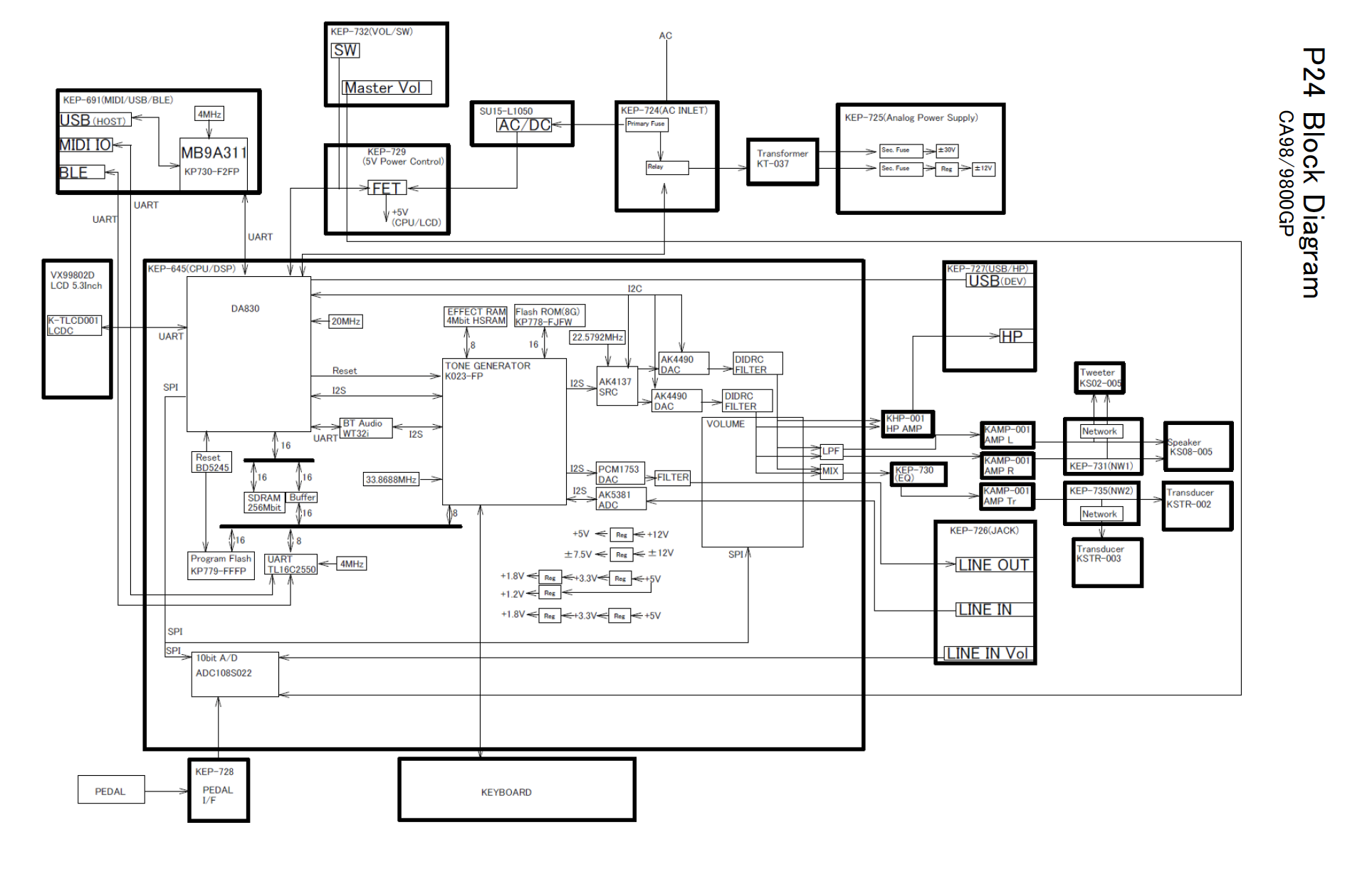

It does have a headphone output, but it has an entire EQ section in hardware that is designed for headphones. I found the block diagram of the circuit in a service manual so now I have a bit more clarity.

So, this is the block diagram for the Kawai CA98, which is the same internal motherboard as my NV10. The main difference to keep in mind is that my instrument does not have the KSTR-003 Transducers, and has a different speaker arrangement. So everything "inside" the block of the motherboard is correct, while there are some differences outside the "block." - for example, on my piano the "mix" output does not go into an EQ, but rather right into the L/R channel amp.
But based on this, it does appear that one of the outputs has a LPF on it, and the other one sends out a full-range signal?

I am wondering if I am overthinking this.
Since the goal is to have the DSP/amp/speakers contained in the enclosure, and have the ability to use either Pianoteq via line-in from my computer OR the built-in Kawai sounds, and I am willing to cut/solder/fabricate, why not just do this:
Install a second line-in jack on the cabinet routed directly to a minidsp (dedicated for Pianoteq). Then, route Kawai's line out to a second input on the minidsp. Then I can replace the amps and speakers and have total control. Is minidsp capable of automatic source selection? Or is that something I would have to have some sort of control scheme to switch between?
Thoughts?
The electronics is the easy part.
Again, this thread PA speakers for home HiFi use
has some recommended "studio monitor" speakers which are designed to be listened to from two feet, between the pair. It won't be realistic on the zero octave, but what else is? You could put studio monitor speakers in the cabinet instead of the Kawai pair. If the kawai has high enough power to reproduce an ff hammer hit, then that may be all that is required. If not, then going off the usb output to a D/a board and your own 200w/ch amp may be required. Or on 80 db 1w 1m sensitivity monitors, even 400 w/ch. I'm all analog here on the hifi end of the room, so no knowledge of dsp etc. Don't know why you would want a digital processor, anyway. those are for frequency equalization curves & effects like reverb, flanger, etc. IMHO. The line out may be entirely adequate, but you may have to replace the line in from a microphone with a resistor to keep the internal processing from compensating for room effects.
It appears Kawai is using digital boards to make up for the inadequacies of their loudspeakers, with feedback from the inputs to cover up room effects like standing waves. I would ditch all that and buy decent speakers. But you have to treat the room to eliminate the standing waves, with soft furniture, drapes on walls, carpet, etc. Or go for the treatment in an actual studio,black sound absorbing foam on all the walls & ceiling.
