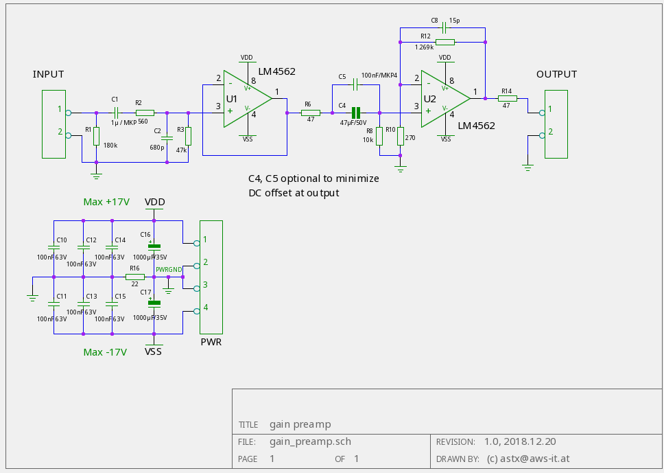

The 2nd and maybe better option is to use the LM3886 with gain 20dB and in front a high performance opamp (e.g.LM4562) with gain 15dB.
Think the overall performance would be better as the STK ...
BR, Toni

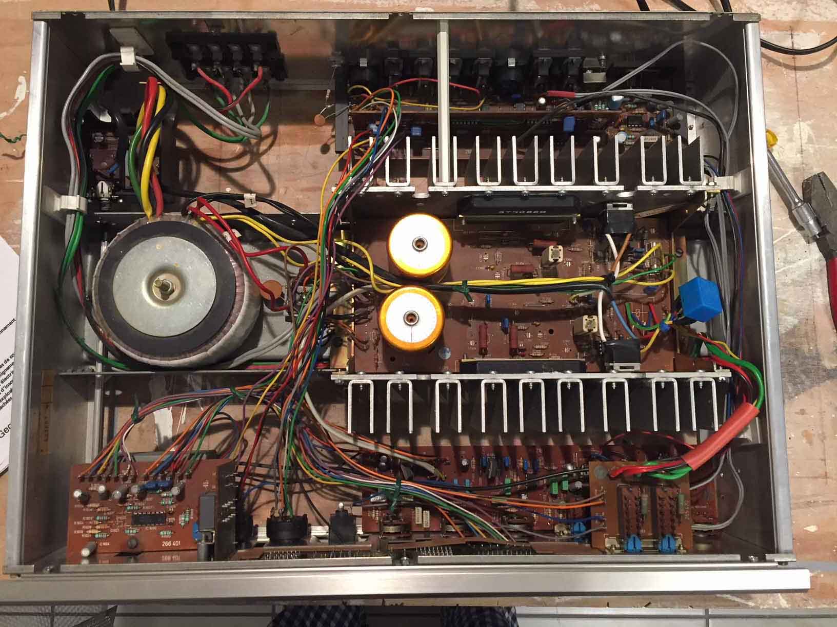

From the pictures found of Google, the heatsinks should be large enough for the chips.
Of course I don't know what pic you've found exactly, but I'm afraid that it might be deceiving. The heatsinks aren't massive extruded ones, but they're assembled from a sheet of aluminium with several U-shaped fins screwed onto it. Strange :rolleyes:. As the thickness of that aluminium is not more than 2 mm, I'm afraid there ain't no sufficient heat spreading from the relatively small contact area a chip like LM3886 or TDA7293 has. So at least paralleling two chips appears to be the safer way, or new extruded heat sinks (which of course are more expensive than a 2nd chip), or going discrete with power devices that have to be considered as brute force.

...The heatsinks aren't massive extruded ones, but they're assembled from a sheet of aluminium with several U-shaped fins screwed onto it. Strange :rolleyes:. As the thickness of that aluminium is not more than 2 mm, I'm afraid there ain't no sufficient heat spreading from the relatively small contact area a chip like LM3886 or TDA7293 has....
I would order 2 pcs 6mm lasered aluminium from e.g. cutworks.de with the outline of STK-068G including holes for LM4562/LM3886 pcb and IC. You can remove the old STKs, clean up the PCB from unneeded components and mount and wire the new PCB instead of the STKs. 6mm heat spreader should be more as save enough.
BTW as you are the owner of the Dual CV1450 you could post a picture form inside the case...
BR, Toni

Simply buy 2 pcs 5 - 10mm thick aluminium heat spreaders and you can add LM3886 and the LM4562 gain preamp.
Get +/- 15V from +C and -D power supply with a small ripple filter 10R series with a 330-1000µ lytic.
The gain preamp is easy to solder on a developer pcb.
