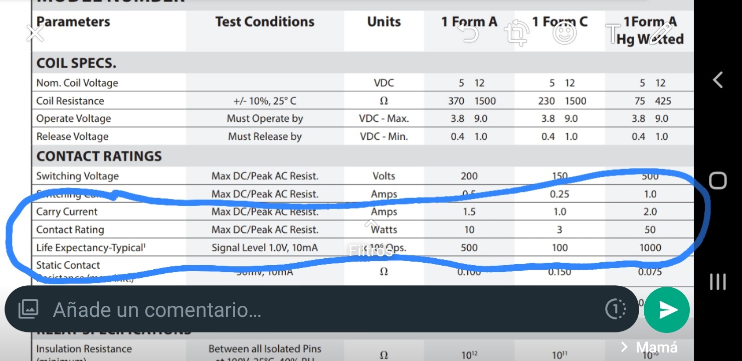

Most low power relays are warranted to 100K actions, or ever a millon. So using them, say, 10 times a day it means 10000 days or 30 years, rougly. So don't care them unless it became faulty. One example taken randomly: 500 millions of operations.
