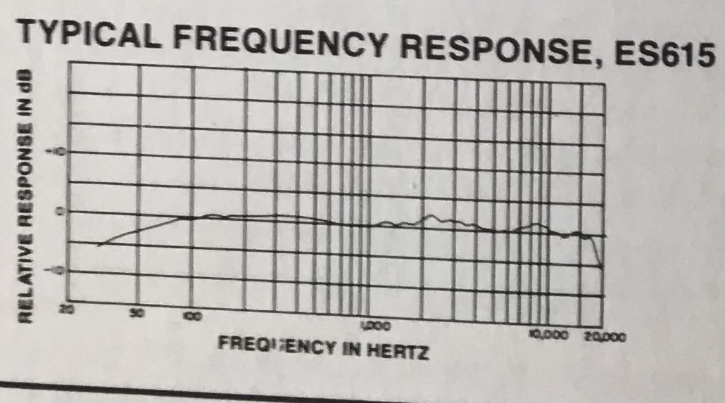

The ES-615 is an omni mike. That is correct for speaker measurement. There is a low frequency roll off, I cannot read it. Flat to 100 hz maybe, one line down at XX hz? I cannot read now many db down that is on the left axis.
Depends on the speaker you are building. I am building a 54-15000 hz speaker, so having 54-100 hz down 10 db from the mike would mess up my measurements. If you are building 100 hz up with a 6" woofer or so, no problem.
The ES-615 is dynamic, so no phantom power required. Your cables had best be short and real twisted pair, to avoid 60 hz hum (or 50 hz in eastern hemisphere). Condensor mikes have a transistor in the mike that boosts signal up to 1 v signal and swamps hum up to 100' or so cables.
Yeah, ES-615 is 3 db down at 50 hz. 2 db rise at 2200 hz. Not too bad.
Box most likely is not tuned to have F3 below 50 hz anyway. Is box ported or sealed? Sealed response tends to end at 70 to 100 hz anyway.
