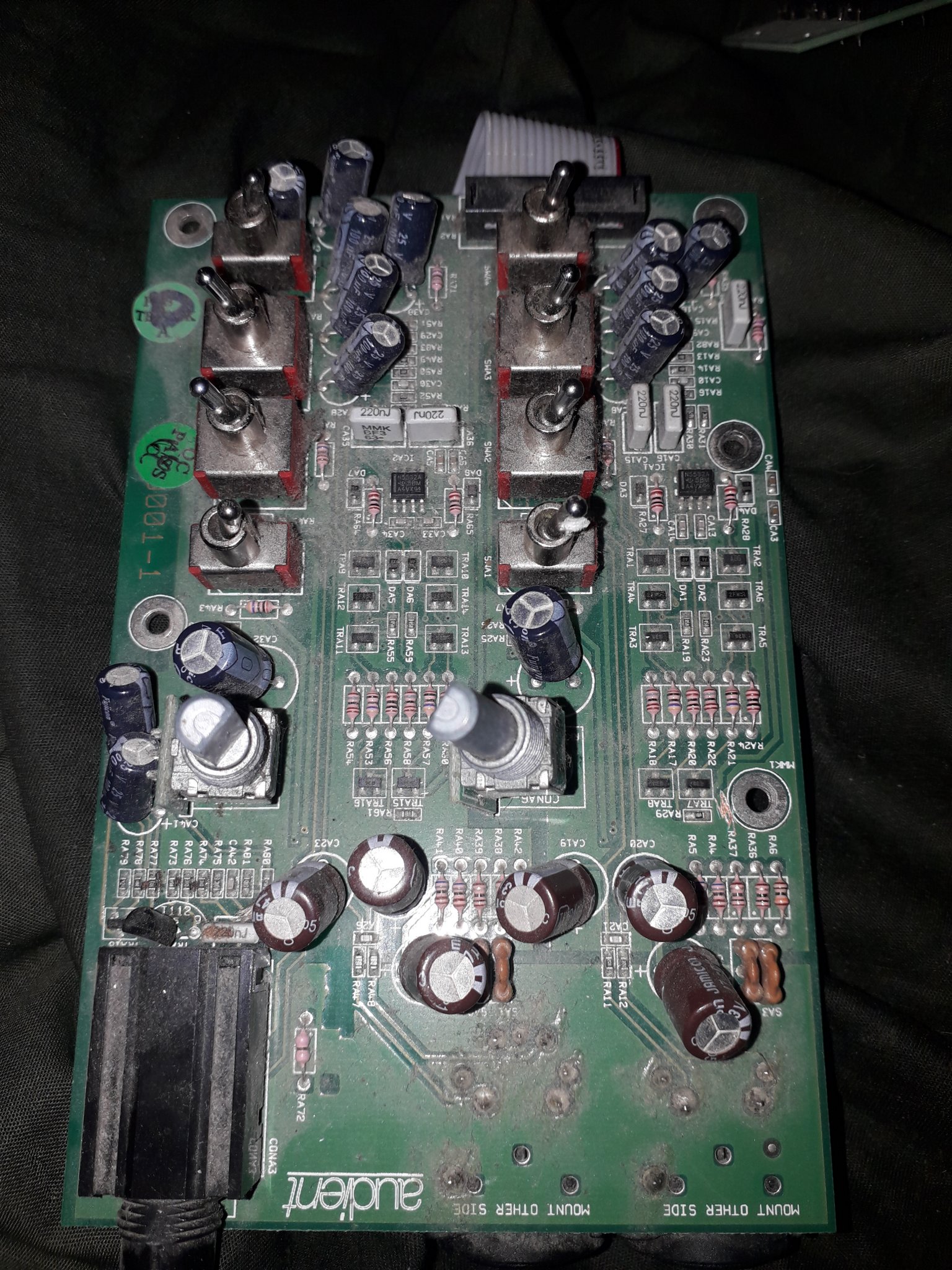

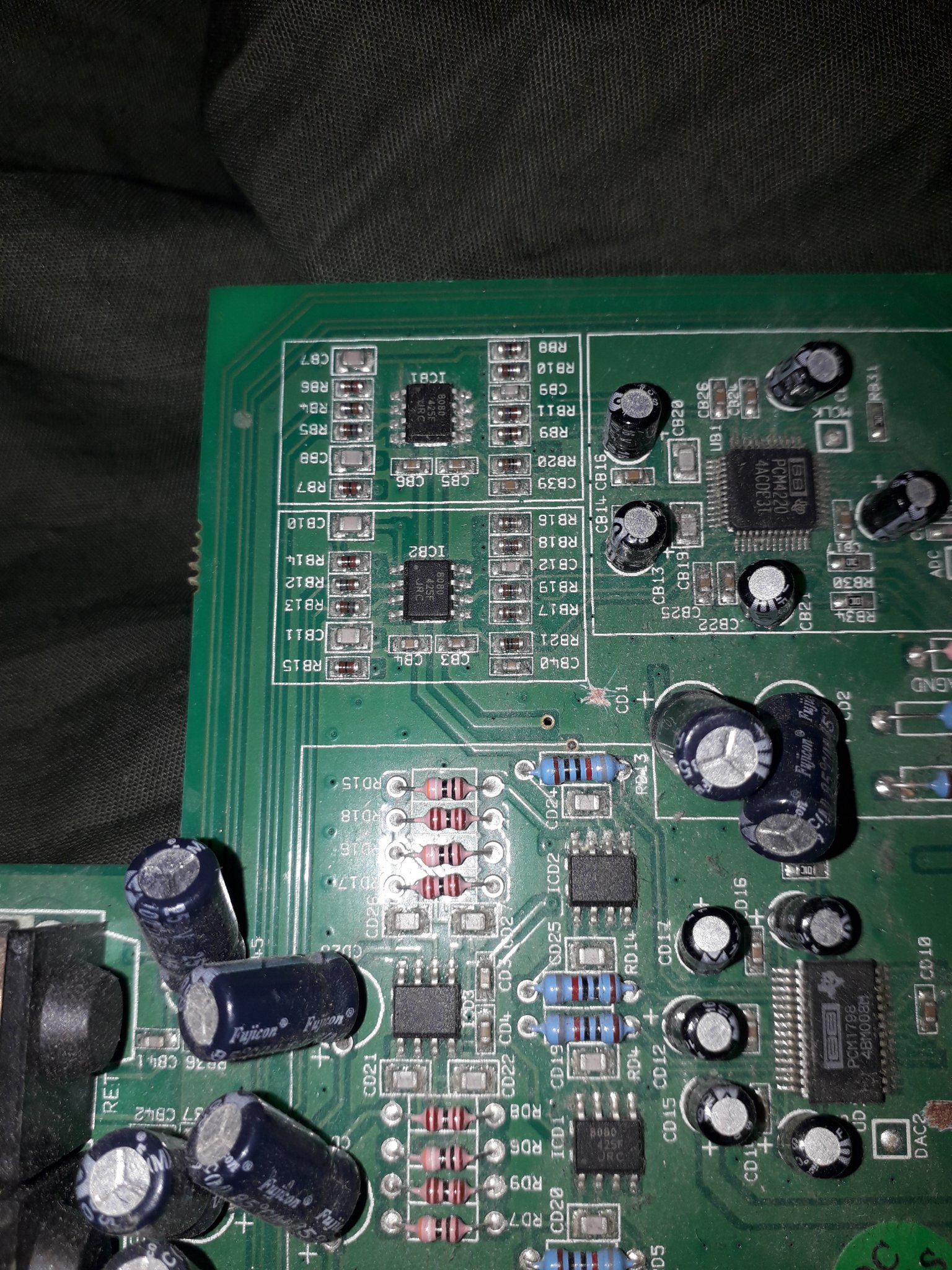

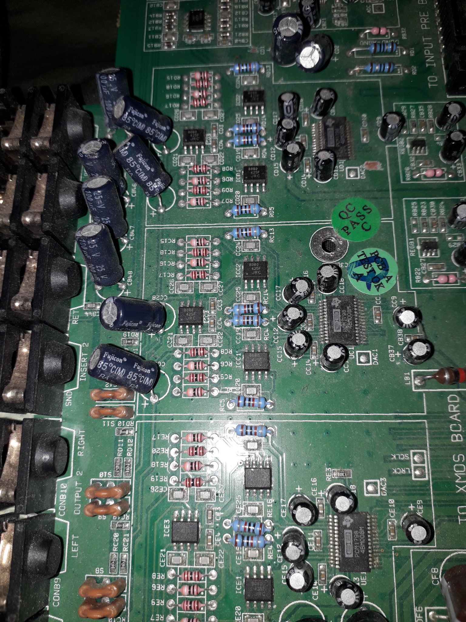

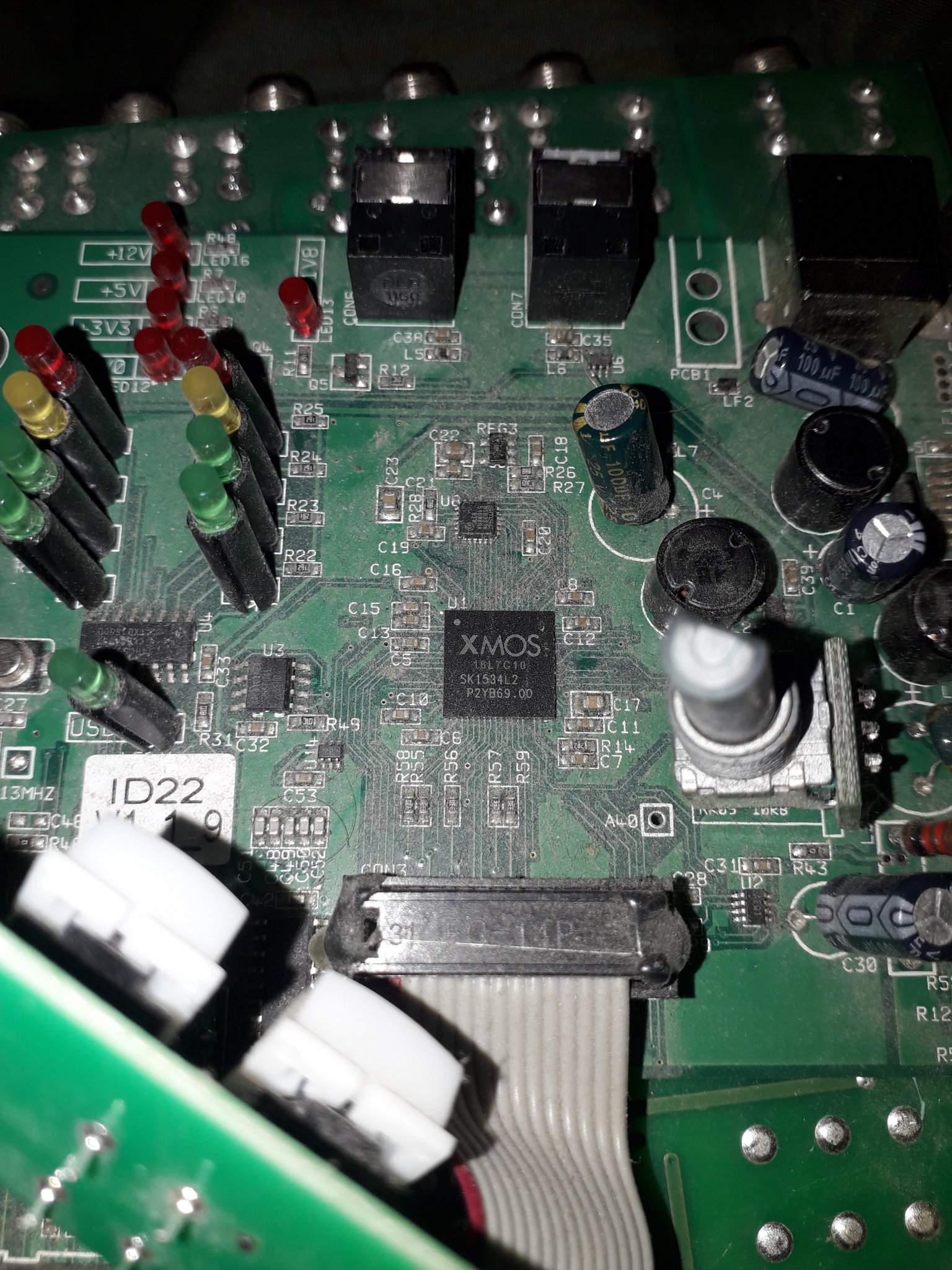

In early 2017 I had an intuition and I bought Audient ID 22.It used all good cheap technologies that are good enough.in 2018 it was no 1 soundcard for recording sold on Amazon.5 years later Audient has the best quality/price ratio with similar products and technologies.Not going into the crazy youtube reviews..
Since I got this soundcard it stays open on a table. I only bought it to study it as I'm not a music producer.
Check out its ne5534 mike preamp, its all NJM8080 analog signal chain, xmos based asyncronous usb ...When I bought it I thought I could improve it with lm4562, ada 4898-2, opa2132...which I had in abundance.
AFTER 5 years I'm glad I never touched it. Anyway this soundcard needs better regulators not op amps...Just checking the capacitor shelf life for now 😉

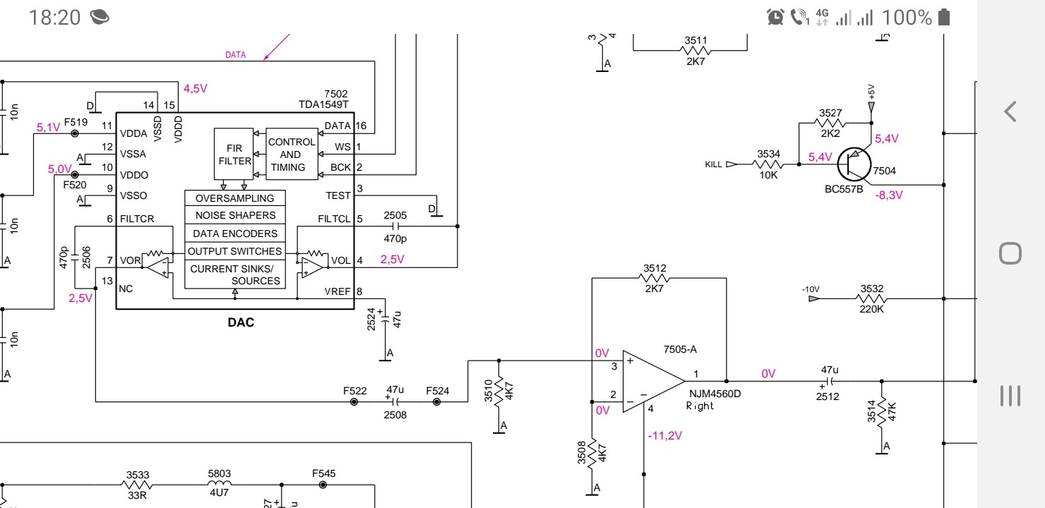

I think I have a Marantz cd 5000 cd player with njm4560...It played well...some say its tda1549 was the best Philips DAC, but there's a njm4560 after that...so you needed to listen that op amp too to evaluate the DAC...That's conflicting 🙂.
