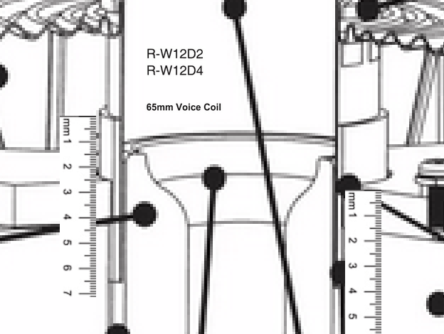

This chassis looks more interesting as I thought! Can we get usefull information for it like membrane weight and coil length? And 750Wrms from a 65mm coil which is mainly not even cooled in the gap ... of course ...
But I like their pole piece design, the scetch looks like they use a demodulating ring and the surround design is clever too! But no hint if these 20mm are real or some funny calculation like PA Chassis do.

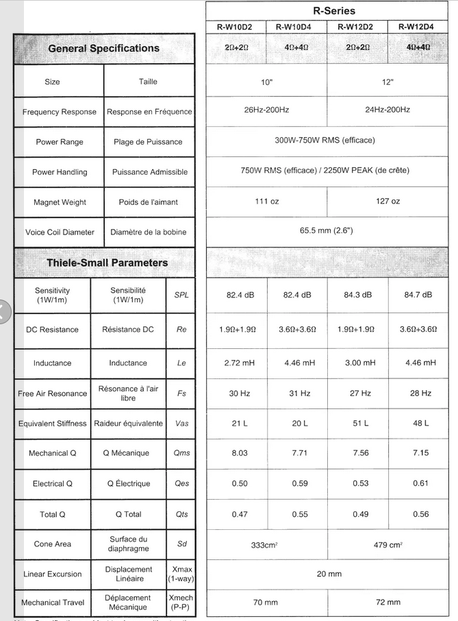

Not really, 91 dB is efficient only when comparing to driver specs designed for tiny boxes; at ~94 dB/m/LF my 515B Altecs are though, but require small refrigerator size boxes to go low at high SPL and require duals or a BLH to do 20 Hz at high efficiency.So what your saying is the SB acoustics is one of those rare breeds that is sensitive, has 20mm xmax and also plays well high. With a light cone.
It has 20 mm p/p, so 'only' 10 mm. Yes, with a 7.56 cm dia. VC it goes to ~34400/pi/7.56 = ~1448 Hz, everything above it is dustcap resonances.

I missed that the SB data sheet quotes its linear displacement in p-p rather than one way.

If the dimensional sheet is to scale, it looks like around 25mm of the 65mm coil is overhanging the pole piece, so 20mm Xmax seems quite believable.This chassis looks more interesting as I thought! Can we get usefull information for it like membrane weight and coil length? And 750Wrms from a 65mm coil which is mainly not even cooled in the gap ... of course ...

I printed the scetch and measured 15mm overhang compared to 65mm diameter (not the cutout, diameter of coil is wider). With some fancy PA driver math which acounts also a part of the pole palte height you get to +-20mm.

I was mistaken, you are right.I printed the scetch and measured 15mm overhang compared to 65mm diameter (not the cutout, diameter of coil is wider). With some fancy PA driver math which acounts also a part of the pole palte height you get to +-20mm.

I misread the Alpine R-W12D voice coil diameter for length 😳.
Looks like the voice coil length is only around 38mm, nowhere near 65mm.
Speaker exchange lists a Eminence LAB-12 Aftermarket Recone Kit (122133-U) 6 ohms. Parts specifications: Voice Coil: Kapton with 2.408″ inside diameter, 2.5″ form length, 1.3″ windings width.
If that is correct, the LAB12 coil length would be about 33mm. The pole plates for both look about the same, 9.53mm for the LAB12, which would mean only 2 or 2.5mm more excursion.
The strontium ferrite magnet weight is 160oz for the LAB12, only 127oz for the Alpine R-W12D, so without seeing a Klippel Bl verification, I've lost my confidence in this driver's Xmax rating.
The BMS 18N862 has a 50mm coil length, 12mm gap and over double the Sd of the 12's.
