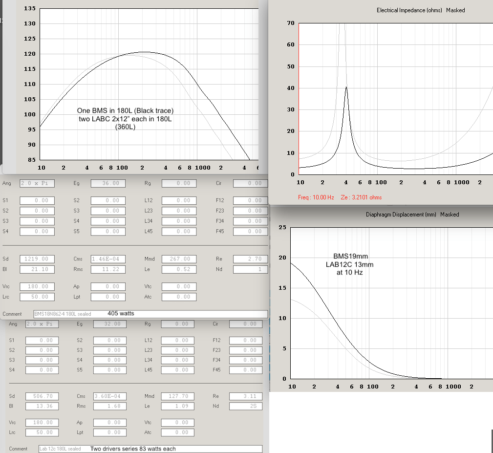

The four ohm LAB12C has the same 13mm excursion as the six ohm LAB12.
8 LAB12C drivers would be a fair increase in displacement and a lower Fs than the pair BMS 18n862.
Each cabinet could be wired in series for a nominal 8 ohm load, two cabinets per side would load your NU6000 at four ohms, at 1500 watts (peak) each cabinet should reach around 110dB at 20 Hz with no room/corner gain.
Each 2x12" cabinet could do a clean 120dB in the 100 Hz range.
Considering the KEF LS50 max out at 106dB above 80Hz, should be more than enough.
From experience, I'd expect the 12" cones at 13mm excursion may sound better in the midbass than the 18"at 19mm.

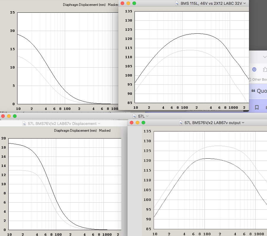

The smaller the box, the higher the rolloff slope begins.
There is nothing wrong with applying corrective EQ to a sealed box, the low end output is determined completely by displacement.
The BMS18N62 increases about 13dB between 20 and 100Hz in a 180liter box, 15dB in a 115liter box, and 19dB in a 180liter box.
A higher Bl, lighter cone is more sensitive/efficient in the upper end, but in a sealed cabinet the low end efficiency of the woofer is proportional to the cabinet volume and the cube of its cutoff frequency.
Smaller boxes, regardless of how the Sd is made up (single large driver, multiple small drivers) require more power to produce the same displacement/SPL.
Four LAB12C require double the cabinet volume for the nearly the same slope as the BMS18N62, you would be better off getting another pair of them and putting all of them in smaller cabinets.
Cut the size in half, they will use about double the power in the low end for the same output, but you can drop the cabinet volume to 57L and still be around 2000 watts per driver at 19mm at 10 Hz.
Since you plan on corner placement, you could make triangular cabinets and really cut the footprint down.

Really funny as I've been modeling too and it seems that getting another 2 BMS is probably the way to go. And build them in to the corners.The smaller the box, the higher the rolloff slope begins.

Sorry but that's "old" thinking!The 15 would obviously be better for the movies.
The GREAT thing from these closed subwoofers is that you can EQ them and adapt to the room as you like! You can boost 10-15dB if they can take the power! (I normally do around 6-8dB for cinema use but sometimes more is needed) Frequency response can be modified a lot - and that is often needed in a normal room cause the ROOM adds a lot of sh...marrn.
You can't EQ a reflex speaker under it's resonance frequency but for a closed box that's no issue. So - 2x 12" is very likely to give more output alt low frequencies as 1x 15" (but need to do the simulation).
I didn't measure the BMS but these HiFi Spekaers often have less THD and losses at low levels. But the BMS can take way more power.
You need to simulate if it reaches Xmax before the power maximum (which is often) then this benefit is not as important.
SPL in low frequencies is membrane area x travel, regardless of PA or HiFi chassis.
You could get a pretty good idea of what peak power your NU-6000 is putting out from the LED display:Wanting a 4 channel amp that can run the 4 X subs. No matter what they end up. Though probably sticking with the BMS in new boxes.
Actual power used is probably very little especially for music. Where they don't seem to break a sweat. But 4k lossless movies when buildings start falling down and things like interstellar are a lot bigger ask.again wattage wise I bet they aren't pulling anywhere near what the Inuke can actually put out.
Your subs are probably a bit lower than 4 ohms <16 Hz, so the 0dB light should be near 3000 watts/109volts peak.
There is no headroom after the 0dB light illuminates- any more input level just current limits the output.
The -6dB light is around 750 watts/55volts at the impedance minima.
When buildings start falling down, if you see a peak to peak excursion of 19mm or less when that illuminates, the speaker won't reach Xmax at full tilt boogie. There is a possibility the SPL at those levels if sustained will actually flap or loosen drywall- a Mackie HRS120 with a 12" and passive radiator with far less displacement than one of your subs could do that.
Looking sideways at a little white dot on the cone and a ruler makes it easy to see what it's excursion is.
With that information you can estimate what you want and the minimum size cabinets that won't choke the excursion at the power they use.
