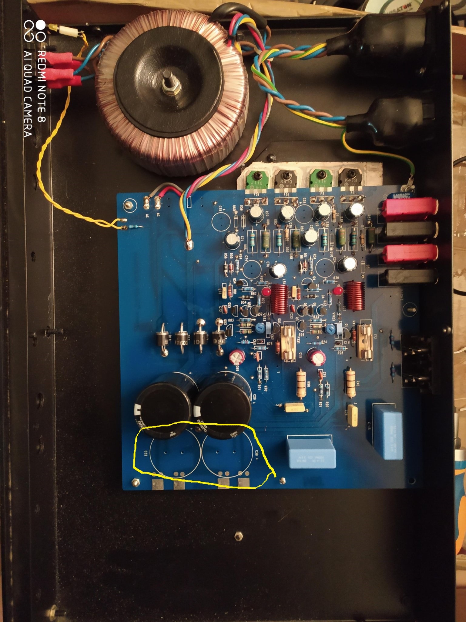

Seems, you´re set on modifying the amp, no matter what, but lack some electronics basic knowledge,
so why don´t start with the obvious?? Add som PSU electrolytics to (maybe) tighten the "mellow" sound??
If you look at the PCB, there´s room for an extra set. Just add two pieces similar to the two already there, and then listen 😉
Hi thanks a lot and yes that would be the easiest action But i am thinking to something more drastic ... like taking out the transformer entirely and put in a separate box No vibrations no EMI nothing Then enter the case with VAC-0-VAC a new robust diodes bridge and two big caps like 20-33mF each of the screwed typed Maybe with some additional bypassing
I will use some short wires to connect the caps to the board It would be the cleanest/safest way

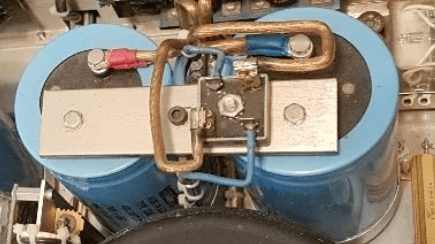

even with the rectifier mounted very close to the electrolytics ? Like this solution for instance

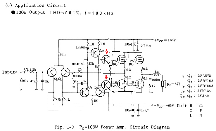

The problem is to discharge the gate capacitances of all the mosfets. A pair of current drivers should be added.

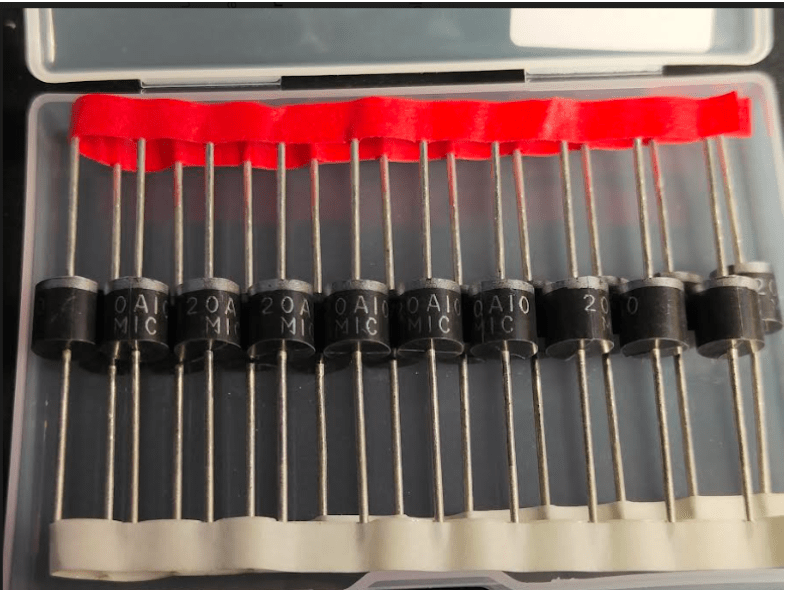

Thanks a lot but better be safe than sorry I do not understand why oversizing is so demonized I can understand for shoes but for electronic parts ?
I have already bought some I really do not know if they will make any difference i understand they are for solar panels
It will be my way to go green ... they are so beautiful Marked 20A10
Reactions: Boydk
