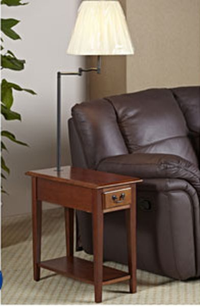

Okay, this is not strictly an electronic problem, but I figured an electrical problem was close enough.
I would like very much to purchase the lamp table pictured below. It can also be seen here:
Medium Oak Side Table With Lamp Leick Furniture End Tables Accent Tables Furnishings
However, from reading other websites I find that the socket in the lamp only takes up to 60 watt bulbs. The person this is being given to will use this for reading, and a 150 watt lamp is preferred.
Is it any big deal to replace the socket in the lamp with one which will take a 150 watt bulb?
PS: "Some assembly required" for this unit, so the lamp stalk will not be attached to the table yet when purchased.

The reason the lamp is limited to 60 Watts is not electrical. It is a heat issue. A 150 W bulb will radiate too much heat for the lamp and will damage it.
Get a different lamp, or concentrate the light with a reflector or magnifier.
I thought that the screw-in fluorescents of 150 watt equivalent were too large to fit into the windowshade mounting apparatus, but I have been advised by someone who uses the bulbs that this is not the case.
Thank you both very much for your advice, I now feel free to order the unit and install a screw-in fluorescent when I assemble it. I felt very leery of exceeding the manufacturer's electrical ratings, now I know I don't have to. 🙂
