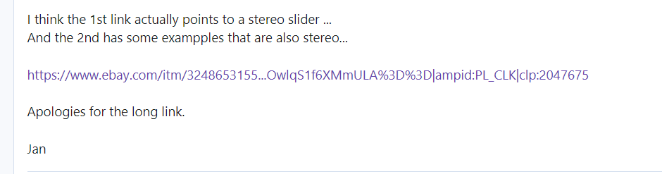

I think the 1st link actually points to a stereo slider ...
And the 2nd has some exampples that are also stereo...

See my post #5.I think the 1st link actually points to a stereo slider ...
