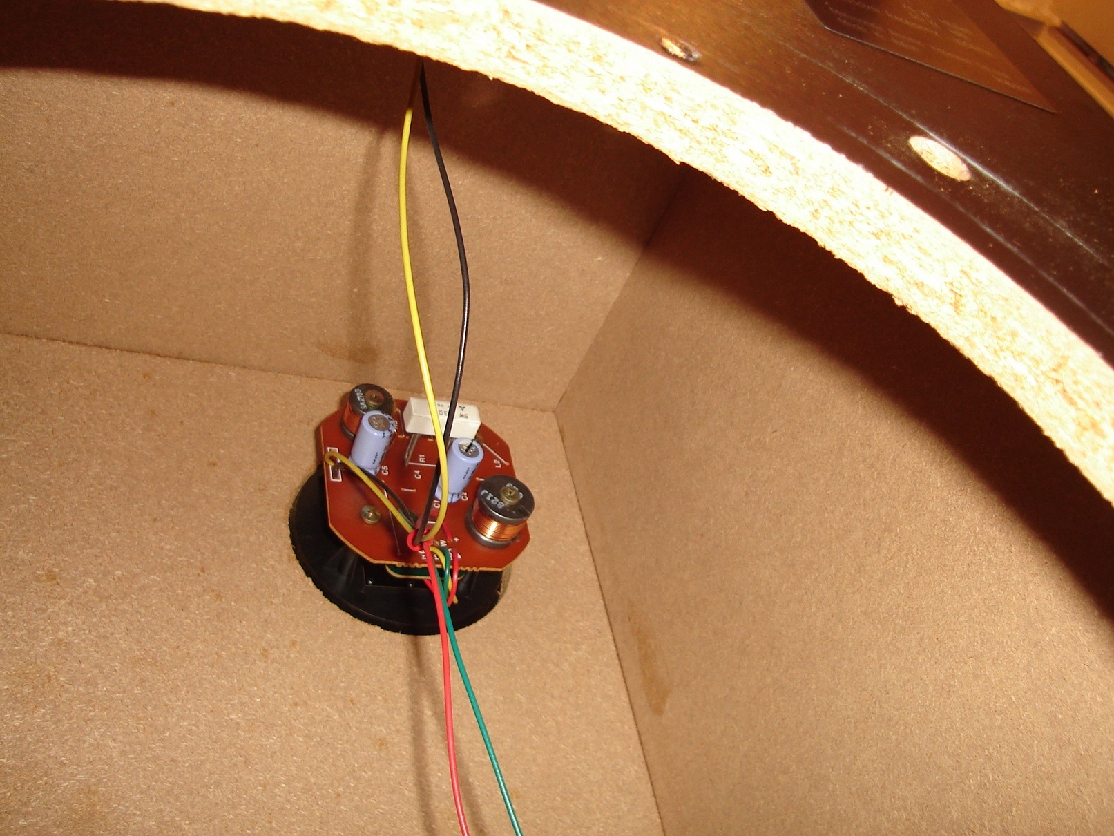

The poly switches appear identical but measure way differently. So at least one is "bad". I looked up specs on similar devices and it seems like they shouldn't have any resistance when "open".As far as I understand polyswitch, it should have some low resistance and will have higher resistance in a fault condition. Any chance you can draw a schematic from what is there? There is a good chance the polyswitches are good.
You may just need to get a replacement bulb.
Removing the bulb and polyswitch protection may alter to overall balance of the crossover. You may be able to do it, just may require some additional crossover tweaking in that case.
Also there is a good chance you can secure a close enough replacement bulb at your local auto parts store. Mostly look for 12V 2A.
A response I got from someone at ohm said "If tripped repeatedly, this device can become overly sensitized and it can clamp down at a much lower level than it should. The speaker wouldn't stop playing altogether, it would just sound strangely quiet". Not sure if the device he was referring to was the bulb or the switch.

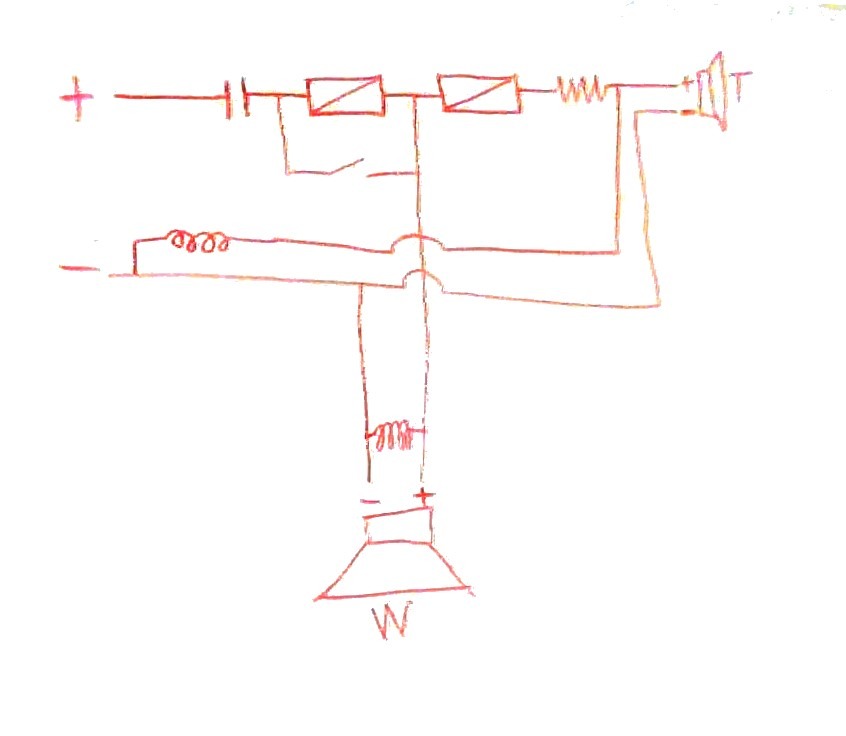

Could you trace all of the parts and draw a schematic? Looking to see how the polyfuses are attached along with the bulbs.

There should be a picture posted at the beginning of this thread that shows the bulbs in white fabric insulation. They are wired in between the large capacitor and the woofer and a resistor and the tweeter.

I could try. Lol. There's a picture at the beginning of this thread showing the crossover and here's something I wrote to try and explain all the connections while looking at that photo...
So...the red wire coming from the red speaker binding post connects to the upper lead on the 750 uf cap. Pictured below that cap is a pair of glass "light bulb" fuses in those two white fabric sleeves, and the one on the left has a polyswitch (looks like a small ceramic capacitor) in parallel with it. The lower lead on the 750 uf cap connects to BOTH the left lead on the "bulb" on the left AND to the polyswitch. Here's where it gets complicated. The right lead on that left bulb (which you can't see) connects to both the other end of the polyswitch, and the left lead of the "bulb" on the right. That three way connection travels down and is connected to the woofer's positive connector. The right lead on that "bulb" on the right connects to the lower lead of the yellow 4.7k resistor. The upper lead of that resistor goes to the positive connector on the tweeter. The white wire is connects to the negative lead of the tweeter (hidden behind the 750 uf capacitor) and connects to the negative lead of the woofer and negative speaker wire.
As far as the two inductors, the smaller one on the left is wired in parallel with the tweeter. It's connected to tweeter positive (out of view) and the negative connector on the woofer. The larger inductor on the right is connected in parallel with the positive and negative woofer connectors.

That inductor in parallel with the woofer has me a bit perplexed? I have built alot of crossovers and never done that unless the woofer had a limited low frequency range. Hoping it has alot of inductance and some DC resistance. Maybe paired with the 750 microfarad cap it is meant as a high pass filter to keep you from damaging the woofer. Should give a rolloff in the 30 hz range

Have you looked at both crossovers yet? I just want to be sure that inductor in parallel with the woofer is really right. Also have you listened to the one with a good bulb and can say it sounds right?
It would need to be in the 10-20 mH range to be right. If it is a small value, it may be that the previous owner attempted to fix something and did a bad thing. Does that inductor across the woofer appear to have a ferrite or iron core?
Also the yellow 4.7 capacitor should be in series with the tweeter and have the choke from tweeter to ground as drawn.

I made my first ever crossover diagram in post #31 if you were unable to follow my description while following along with pic I posted in post #1.Here it is, it doesn't even have an IC....

The conventional connection for a two-way xover is a capacitor in series with the tweeter to block low frequencies. In its place is a coil, which is typically used to block mid/high frequencies from going to the twoofer. (Which isn't always necessary, since if it's a large twoofer, those frequencies won't even tickle.)
So I think that this connection is the work of some manipulation by someone not very expert and that explains the horrendous manufacturing that is seen in the OP's photo.

You should be able to get away with shorting the first lamp and polyfuse. See how they sound. The lamp for the tweeter is more critical than the woofer.
Also could you get some pictures of the inductor in parallel with the woofer? I just want to make sure it appears to be an appropriate value. It would only be an appropriate use if it has a fairly high inductance. Just attempting to guess the value by sight.
