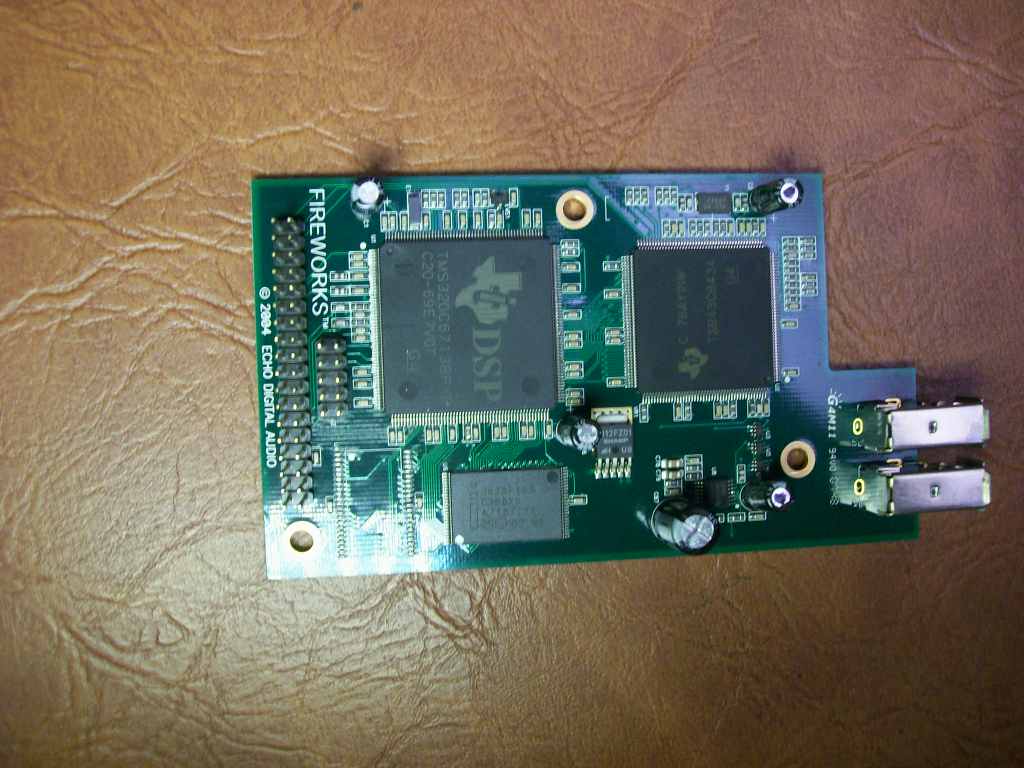

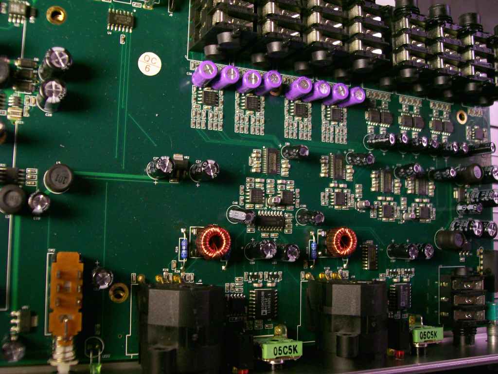

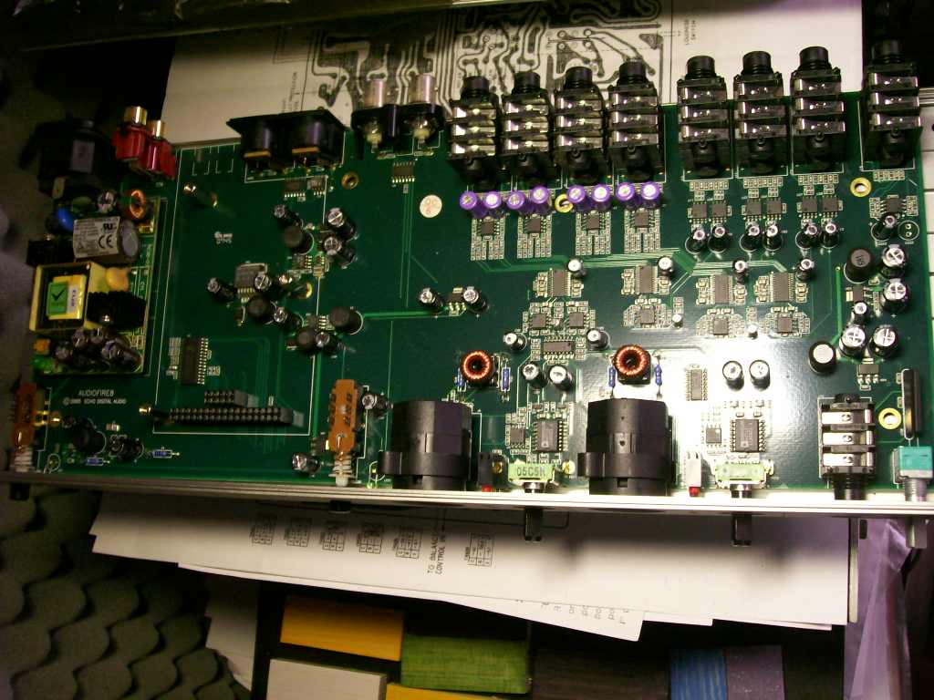

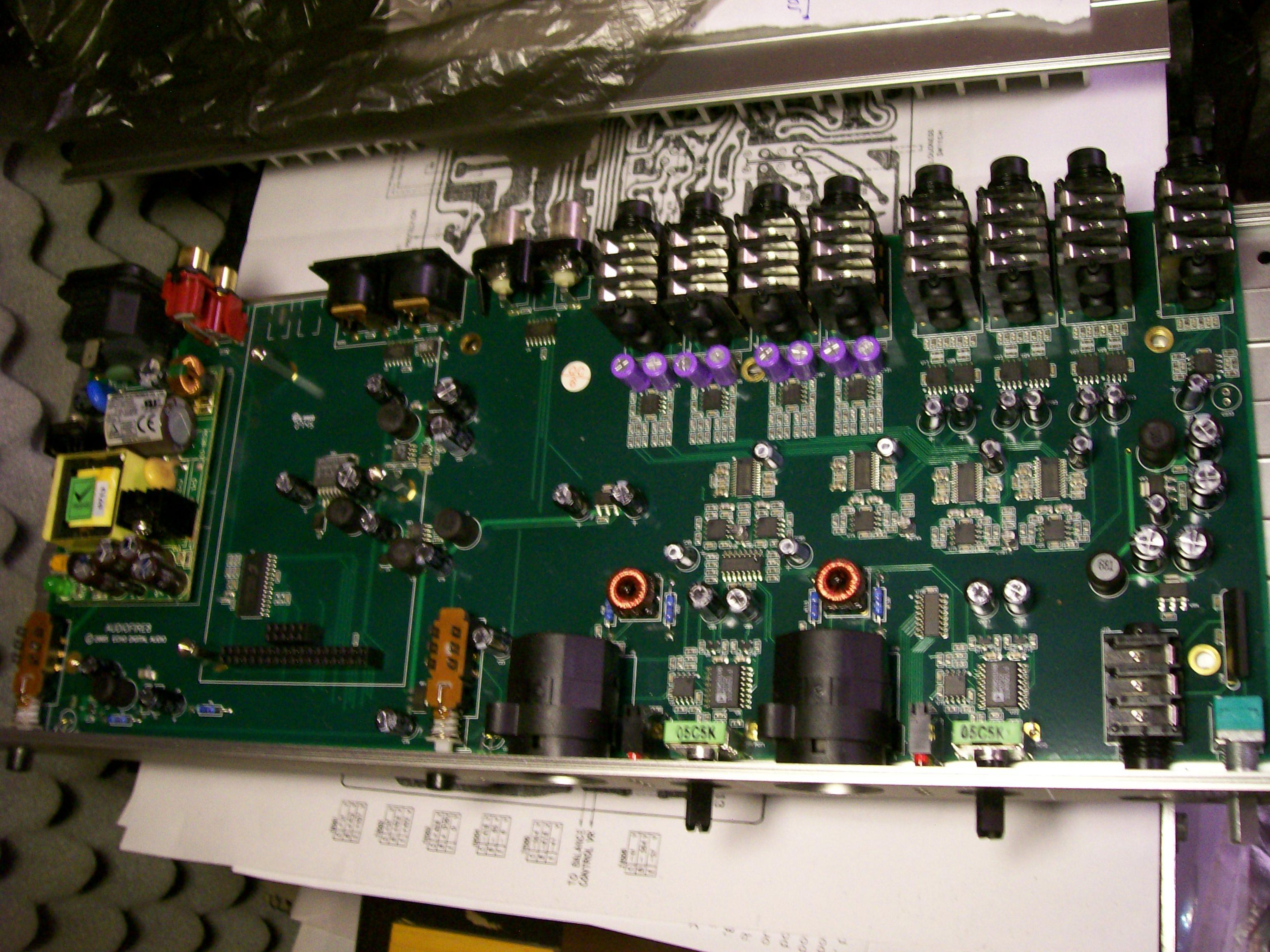

Replacing capacitors in soundcard Echo AudioFire with bigger caps 8
I need to replace all electrolytics in my sound card Echo Audio Fire 8
I posted some photos .
I already ordered over 60 caps but some of them have higher voltage tolerances ,
For example instead of 100uf 6,3v I will receive 20 caps having 100uf 10v .
Is there any problem if some have higher voltage tolerance ?.
I don't want to damage the board .
Also to replace all caps seems a very delicate complicated operation because the traces are very tiny and fragile .
Cheers

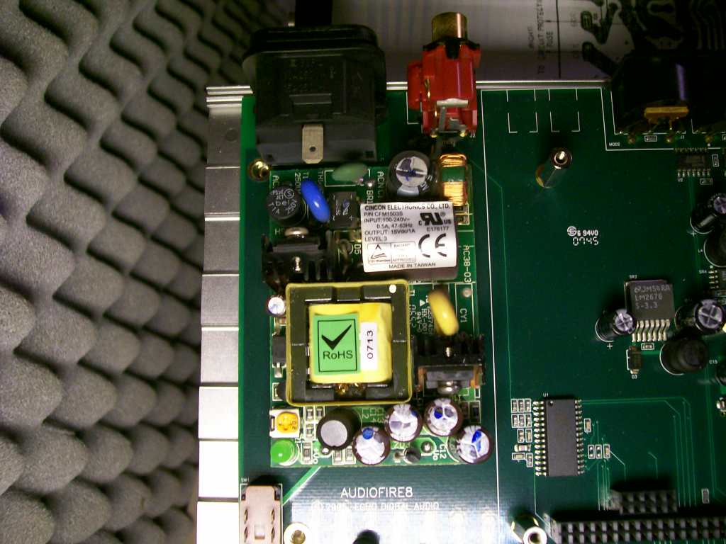

A higher voltage rating isn't a problem. Do you really *need* to replace all of them? I would be very careful replacing caps in the SMPS. First, the caps have to have at least the same ripple current rating. Second, the performance could be affected if you use a drastically lower or higher ESR cap.
The lead spacing and size should be the same or close so they actually fit, though. If you have to have excessively long leads to fit them, it's not great.

I checked some caps and they are almost dead . Those are some trash china caps marked "Rec" or "Trec" almost all of them . I ordered some Nichicon FG to replace those .Regarding the psu I will check the ripple of the new caps . I ordered some high quality parts . I was never happy with this board . The sound was not that great .
The power supply is a CFM1503S .Maybe those caps on PSU are ok and don't need replacement .

If they are really cheap generic electrolytics you will probably not have any issues with ripple current ratings. I would imagine almost everything you replace them with will be equivalent or better. I would not use Nichicon FG for the power supply though. They are not really meant to be in a switching power supply, though they might still be better than the generic Chinese caps.

On the board it is written 2005 and most of the caps are already almost dead but I think the PSU caps are fine because on that I see only Japanese caps but I will also measure those.

I already changed the smallest caps (those having Vloss between 5% to 10%) and the coupling output caps . The coupling measured ok but I replaced them with Nichicon ES the green one . Also I replaced some big caps with Nichicon FG and Panasonic FC FM .
I was never happy with the sound of this board .
Now it sound phenomenal . The depth and details has improved enormously. Also the sound is punchy and juicy .
I can't believe what I have missed my entire life .
I did not touched the Psu .
Also i MADE A MISTAKE one lead from the imput cap was in touch with the soundcard metal case so the input signal on channel 3 was full .I unplugged the card immediately and I trimmed all lead .
Now it is fine . I hope that nothing was damaged .
