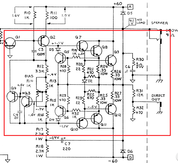

Ok, thanks guys. I got the amp for free so I'd like to use it as a learning tool. I have an engineering background, but not EE, so please bear with my beginner questions.
Attached is the likely problem area, correct? Is it possible to test the transistors in circuit?
If not I'll remove Q1-Q12 and test. If I need new parts, is there a preferred vendor? Mouser, Digikey?

test them in circuit first, if any seem shorted, pull them and test them. I am not a fan of wholesale parts removal and replacement, it adds more opportunities to screw up. If a part shows shorted, we need to test it, but there is nothing in a circuit that can make a shorted part appear not to be.
Thre are not that many transistors, I would check them all for junction drops where they sit, at least at first. Be aware that in various places there are parallel resistances that affect your readings. For example, Q8, Q9 have 492 ohms across their B-E junction. And Q3 E-C has a Q4 B-C in parallel.
If R28 burnt, then Q5 is suspect, but more than that, R28 had to become a current path, and I then worry that R24 may have opened due to a Q8 short.
Whenever you have to replace power transistors, always verify all the associated resistors, they often burn open.
If you replace an output, I'd replace the driver too, even if it checks good. The failed output could have stressed the driver, and for a dollar it is false economy to ignore that possibility.

The power transistors are especialky difficult to test in circuit, as their emitters are near shorted by their 0R33 resistors. So I would at least take these out. Removing all would be even better.
How would you test the transistors? Of course you can have a look at the BE/BC diodes with a multimeter set to diode test, anyway this will give you only a clue when the transistor is competely defective (e.g. shorted diodes).
As you probably have shorted power transistors, replace them all as soon as you find only one shorted. While they are removed, measure all resistors. Replace each one that looks burned. If you find a resistor that measures out of its nominal value, check if this makes sense in the circuit or desolder one side and measure again.
I can only state again that the failure may be complex and that several components may be involved. On way to go could even be to replace all semiconductors in the area in question. Plus all resistors that show the slightest signs of damage.
One thing I would like to add: I have been doing similar repairs for 25 years now. The moment when powering the amp up again time is still a moment of fear. I had more than one that blew again completely, immediately or even after some time during a load test. And I have a variac, a signal generator and a scope for this.
Do not forget to set bias to minimum before.

Tested a few semiconductors in circuit with the following results, positive lead on DMM hooked to first leg listed:
Q11, Mj15002 PNP
1. Base to Emitter: 0.35 VDC

Looking at these results, I think my best option is to replace all the semiconductors (Q1-Q16). As Enzo mentioned, the incremental cost is basically zero. I'll test the resistors in this section while I have the semiconductors removed and replace any which are out of spec.

If you have set your DMM to diode test mode, your measurements indicate taht all these transistors are faulty. In this case I'd check the remaining ones also.
Yes, as others said, MJ15004 is a good replacement for MJ 15002. Both share their electrical characteristics, but the xx4 withstands higher Vcb and Vce voltages. The MJ15024 is even beefier and faster and will also fit. Another option would be the MJ21194, same data as MJ15024, but extended SOAR due to it's Perforated Emitter Technology.
