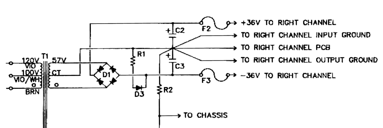

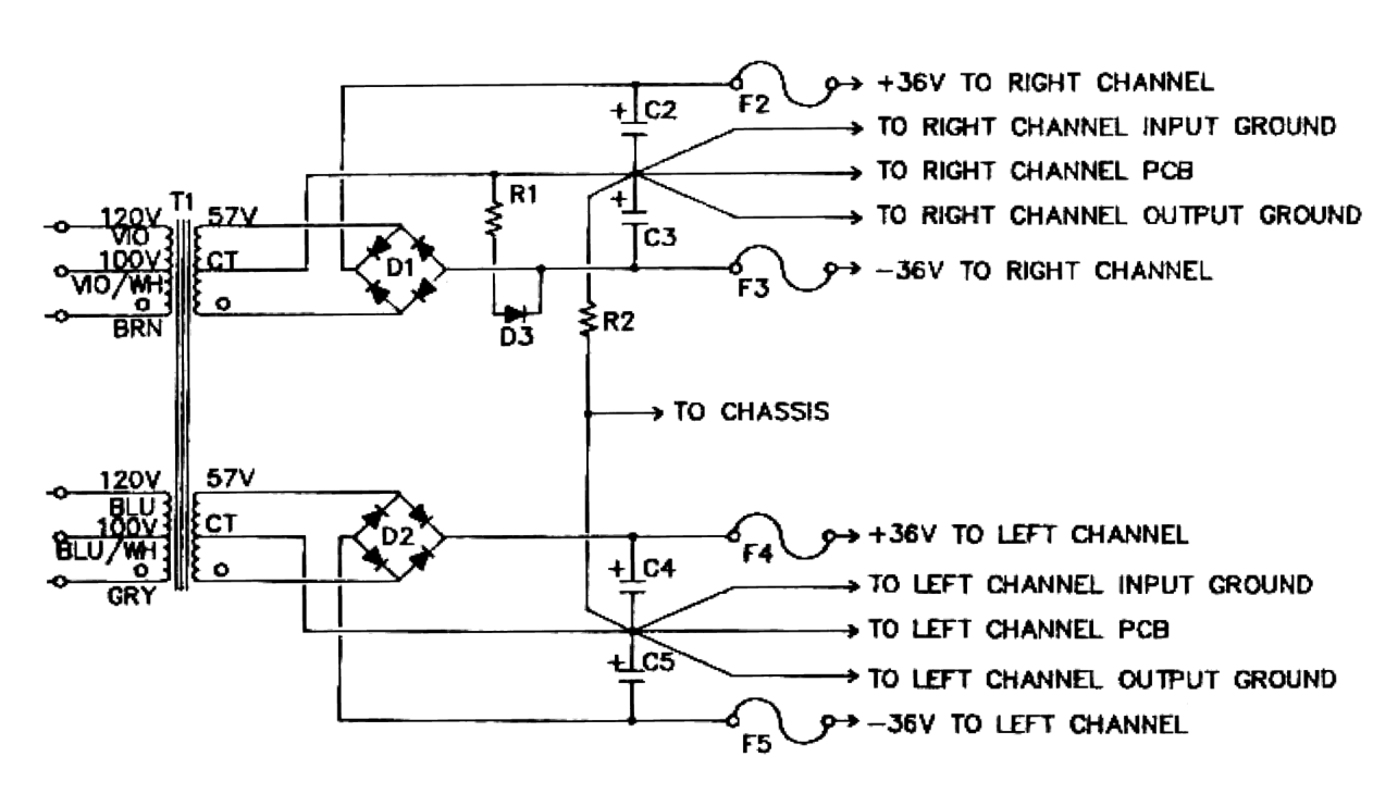

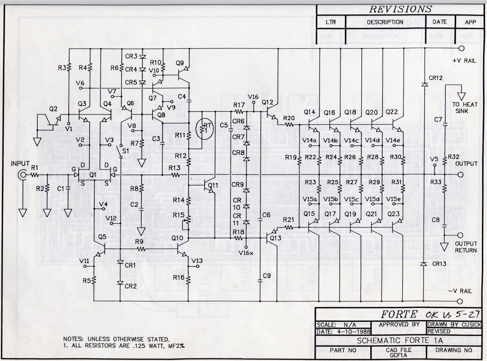

Do you by chance have schematics for the model 4 and / or model 6? I'm hoping to convert the model 6 to run class A like the model 4 so it would be super helpful to have any information how the power supply is wired up on both models.

3. Here's a bunch of detail that I was able to scrounge and am happy to share.
