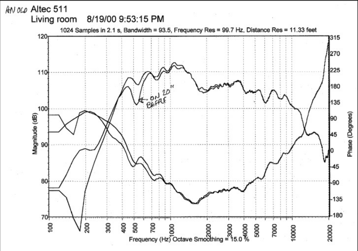

Regardless, still ideally need a 500*2^2 = 125 Hz Fc as you can clearly see in this Altec 511 expo horn's response designed for it.

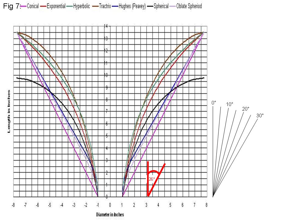

In his paper on horns, Kolbrek doesn't seem to think tractrix profile are as good at loading the driver as exponential or hyperbolic.
Absolutely! Just look at the profile comparisons........from this we see that each iteration (flare factor) from the pure bass horn's hyperbolic is moving towards conical's pure waveguide with all the good/bad this implies.
Also, we see that like any box alignment there's an optimum driver design range for each with tractrix being a popular mids-up compromise between loading/off axis response, but like its 'slower' expanding horns it too shrouds the off axis response too much for many, forcing high aspect ratio profiles and/or toeing in the speakers hence the popularity of 'faster' expanding and/or truncated tractrix variants or going with pure constant directivity horns.
In short, one is always 'robbing Peter to pay Paul', so it's a balance of design trade-offs based on the needs of the app.
