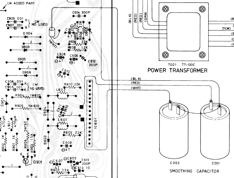

Is it possible to replace the amplifier section of an old Rotel 404 receiver with a 3116 red board that I have? If so, how difficult would it be? Has anyone done this on an old receiver?

RX404? == IC601 is SI1135HD -- a power SIP. you could probably rewire an LM4780 which will handle the +/- 34V rails, although you'll have to rejigger the mute circuitry. LM4780 is a staggered DIP.
