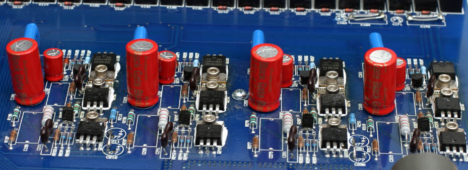

Picture of the modification
Here is a picture showing the changes I made. That section is seven inches wide, showing the active circuit for both channels. Very compact, not allowing convenient use of large capacitors.
The red caps are Black Gate N types. The larger one is 47u/50v replaces a 100u/100v output cap. The empty space in front of it was its 2.2uf polyester bypass. The smaller BG is 10u/50v and the empty space in front of it and to the right of the larger BG is where its 1uf polyester bypass had been.
To the right of the first and third FETs on the bottom row are two circles where electrolytic caps in the gain setting network were. I put jumpers across where the negative leads were to maintain continuity.
In the top, right there are two sets of a circle and a square. This is where the DC blocking caps on the input for mono mode were. I cut out the electrolytics, leaving the circles, and also the polyester bypasses, leaving the squares. Then I soldered jumpers across what leads I left sticking up from the bypasses. This again takes capacitors out of the circuit and signal flows through jumpers instead. The black boxes across the top are the input relays.
The remaining (blue) polyester capacitors behind the larger BGs are 1uf/100v polyester power supply bypasses - one near each symmetrical half of each channel. I may upgrade these another time.
