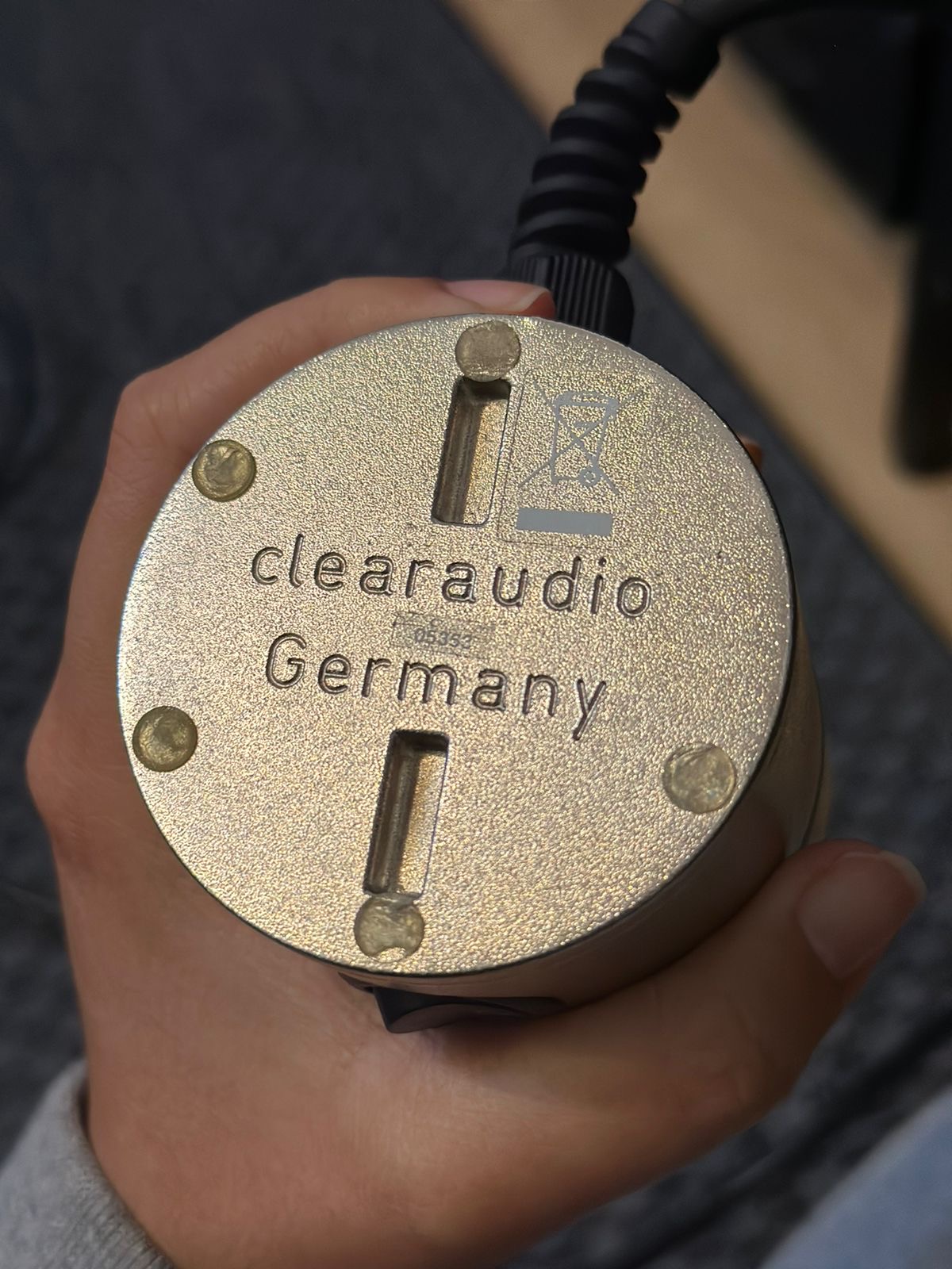

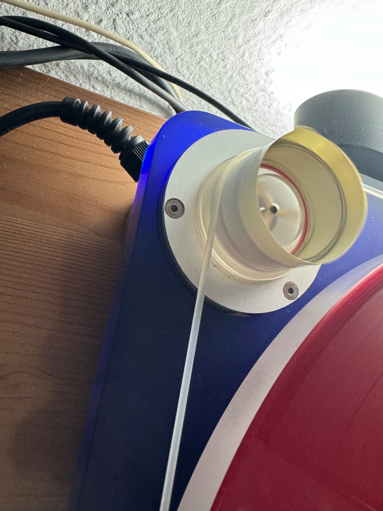

Hi Ralph! I have a similar problem: My wife has a Clearaudio Bluemotion from USA and we brought it to Germany. Looking online I've seen you solved the problem with a pulley, could you please sell me the same pulley? So far we make a little arrangement with tape so it turns at about 33.33, looks terrible but works well 🙂 Much appreciated you sharing knowledge here!! Cheers!
