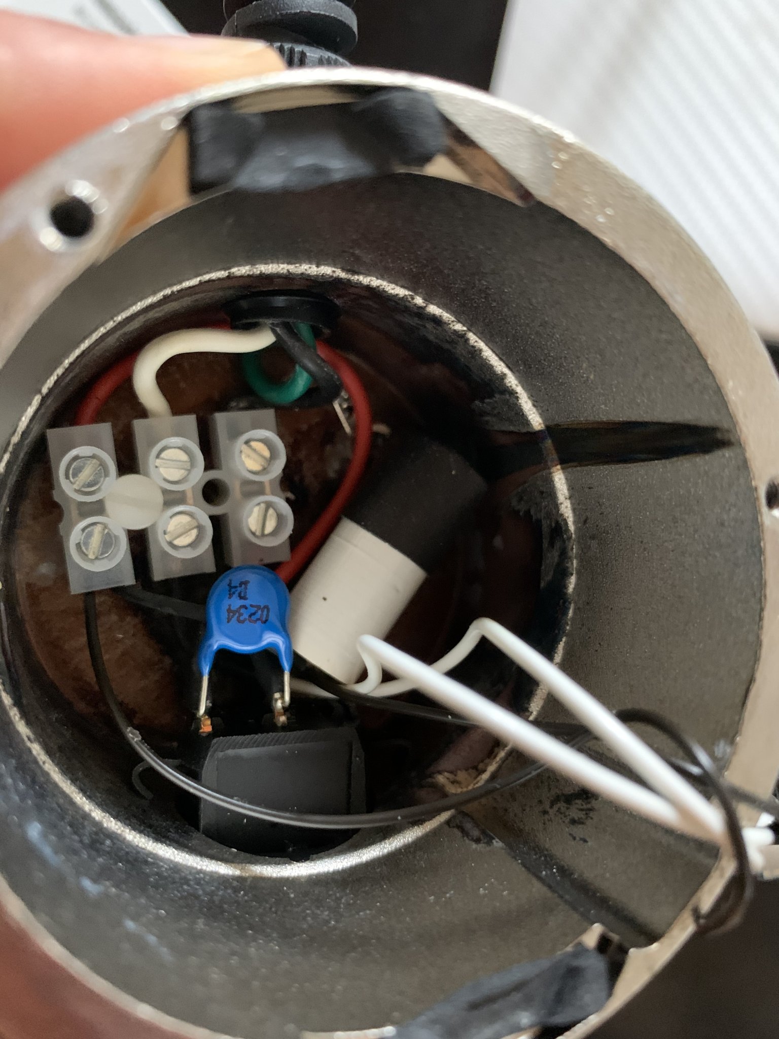

Here is what the motor looks like

If you do this you should also change the capacitor from the current 0.3uF to 0.47uF in order to reduce any vibration.

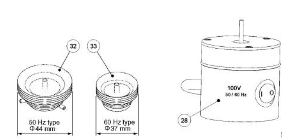

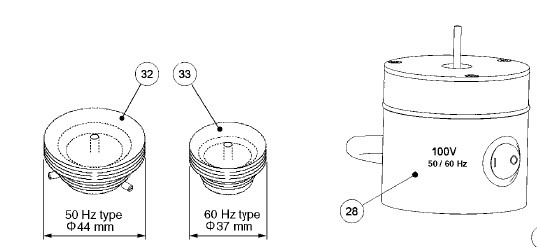

Here is an image extracted from the Japanese service manual

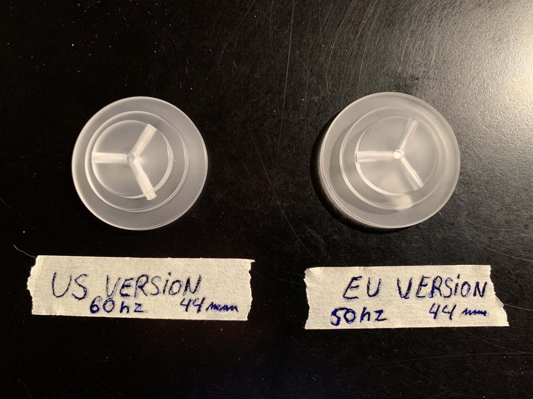

Ralph, the issue that I still can't wrap my head around is that the ''bigger pulley'' is the 50Hz which measures 44mm one and it is the same one that came with my original US table and the one that I received from a shop in EU. I measured them and they are both identical at 44mmm. there's not a bigger pulley, only a smaller one for the japan market.
The EU Marantz table manual as well as the EU one indicates only one size pulley. Besides if replace the current US motor with a EU one, I still don't get why I would need to change the ''standard bigger 44mm pulley'', my table would be equal to a EU bought one .
I am confused , assuming the speed was correct in the US using a 44 mm pulley running at 60 Hz you would need a (44 x 60) /50 = 52.8 mm pulley to get the same speed when running at 50 Hz .
The size ratio between the smaller pulley ( 37mm ) and the bigger pulley ( 44 mm ) is 1 : 1.2 which is the same as the ratio between the mains frequencies .
As these can be bought , I presume that these sizes are correct .
This however means that the US version should have been fitted with a " small " ( 37 mm ) pulley .

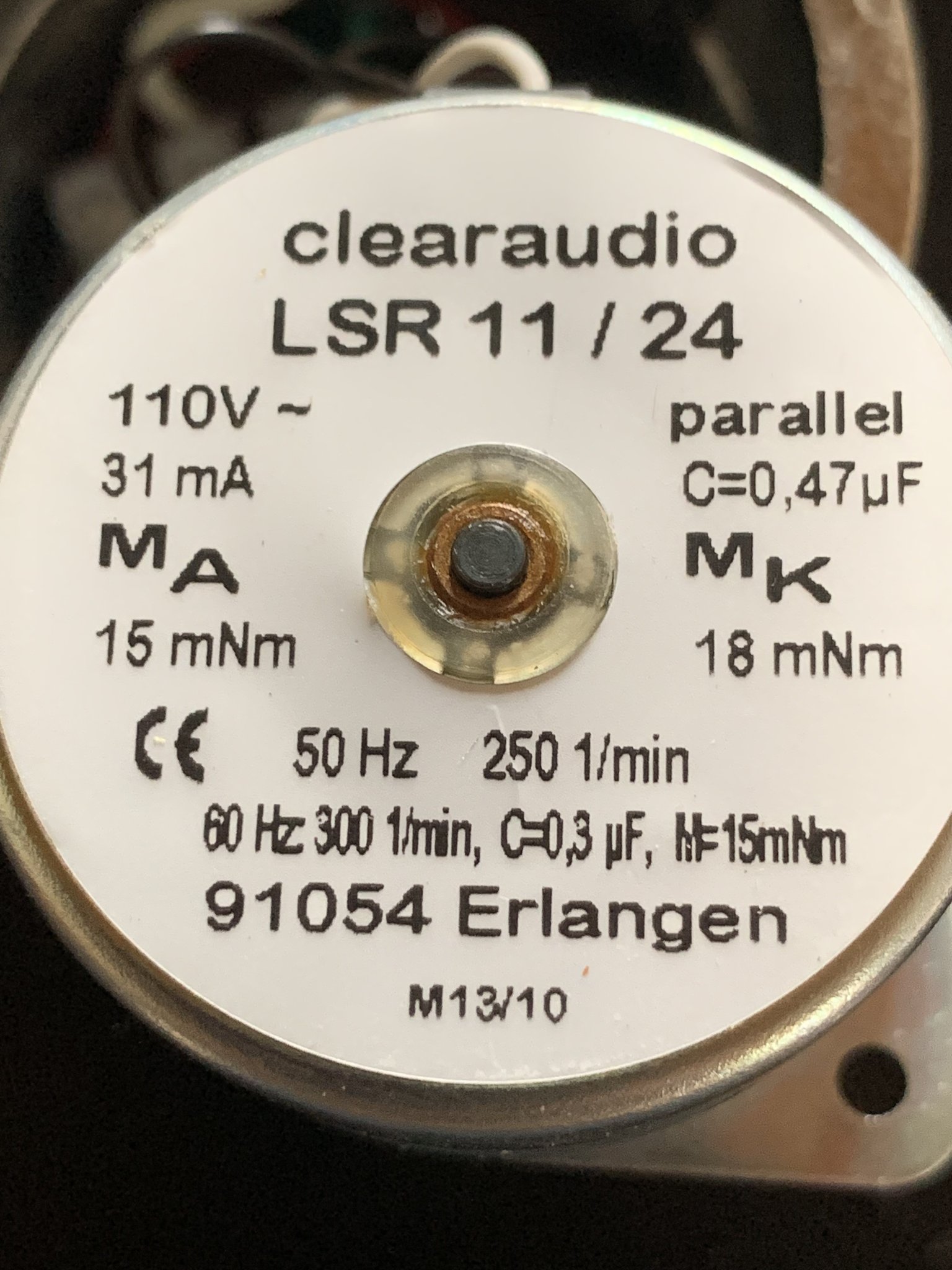

The premotec /airpax motor can run at 50 Hz / 250 rpm and at 60 Hz / 300 rpm , 220 v and 110 v versions are available .
The one you have got shows this on the label ( you have got a 110v version )
To run the table at 33.3 rpm the belt has to be on the smaller diameter of the stepped pulley

On that basis it would appear that a 20 pole motor is used when the supply is at 50Hz, and the much more common 24 pole
for 60 Hz. This would be consistent with the Japanese market being fitted with the 20 pole motor, but a 'special' smaller
pulley for 60 Hz areas which would run at 360 rpm.
