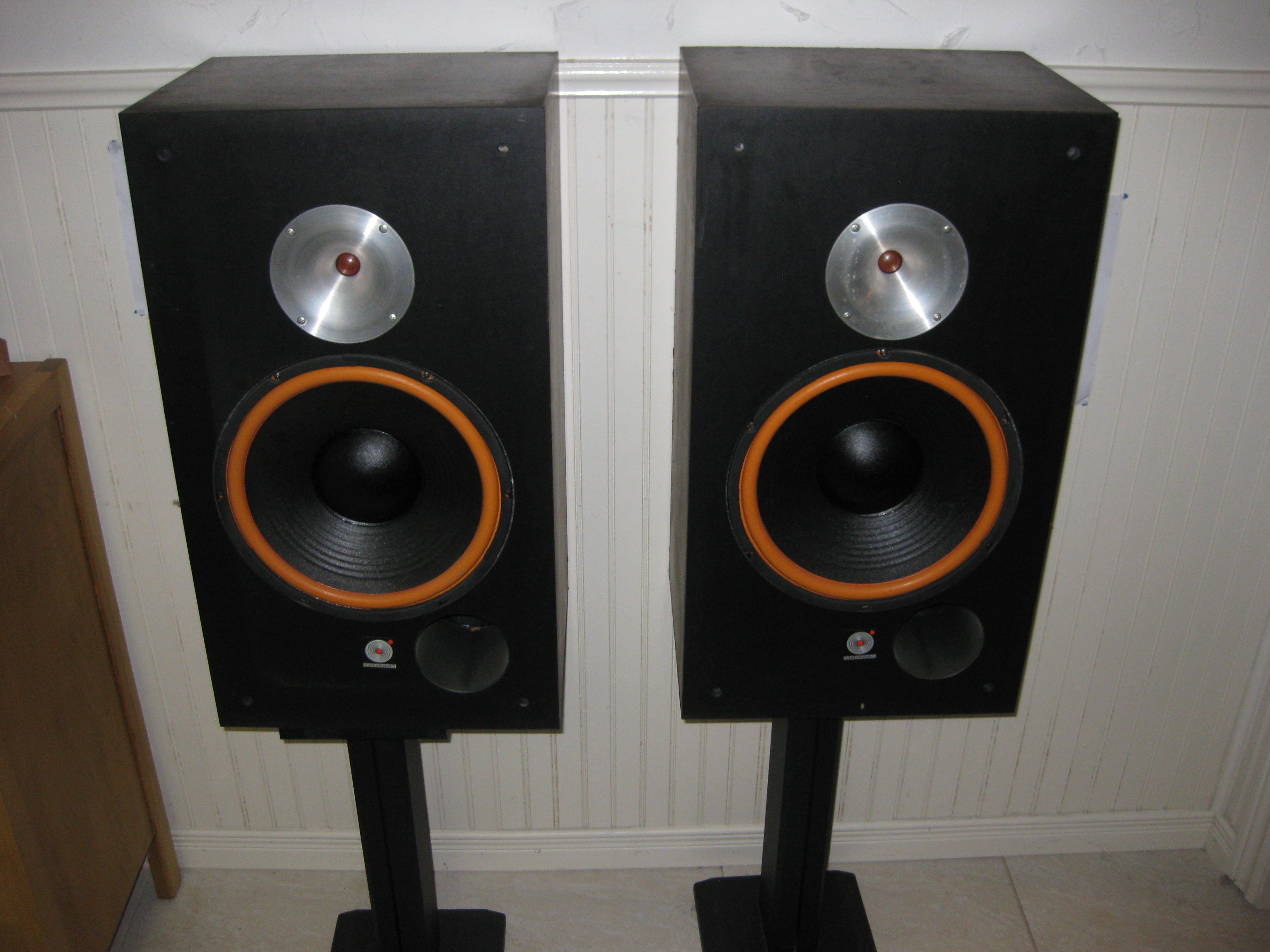

I bought a set of Sound Dynamics 12 s speakers a while back and the lady who sold them to me said that the woofers were replaced back in the 90's. I asked if they were replaced by the same Sound Dynamics woofers and she assured me they were. Of course it turns out they weren't (which explains why they didn't sound as efficient/sensitive as I was expecting them to be). The only markings on the replacement woofers is PMBWC1228. They are light and seem of modest quality from what I can tell (they look like coated paper--I'll post a picture of the generic woofers later).
1) Does anyone know anything about the 12" woofer that were used as replacements in my 12s cabinets? They are marked PMBWC1228.
2) I have a set of Sound Dynamics Signature Series s45's with a blown tweeter (these are three ways). Would the 12" woofer in those work in the 12s, or would they likely be deficient in the mid-range?
3) Does anyone know of a viable replacement for the 12" woofers in the Sound Dynamics 12s (which have high sensitivity)?
4) If there is no viable replacement for the 12s woofers, does anyone know of a good way to use the old spun aluminum horn tweeters in the 12s, perhaps an alternative DIY design, for example, that I might try?
Note: Unfortunately I have no idea of the specifications of either the 12s woofers or the spun aluminum horn tweeters, but was hoping someone here might already be familiar with them.
Thanks.

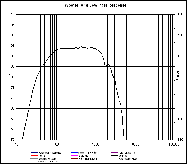

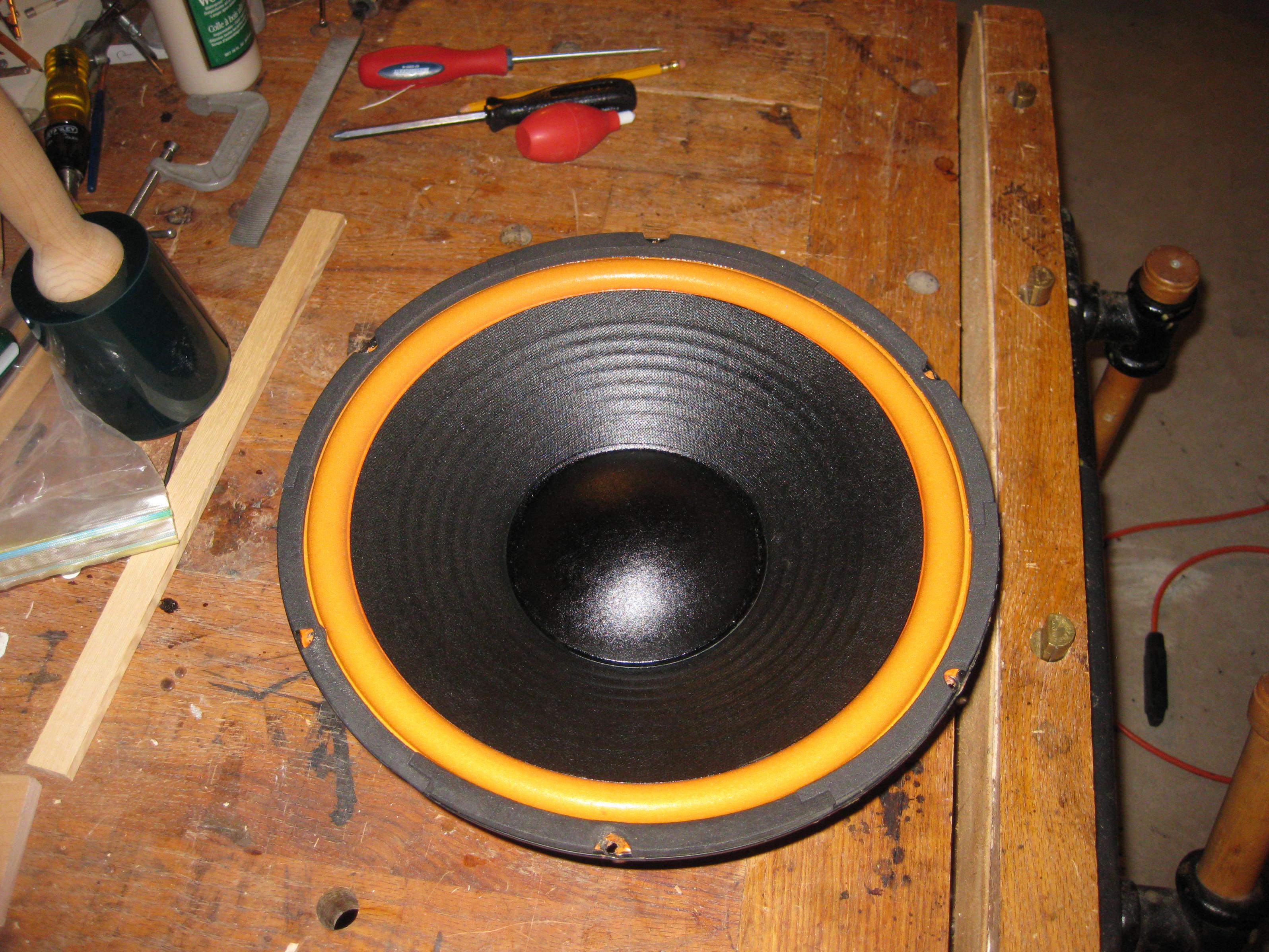

Those yellow/orange surround paper cone woofers you posted on canuck look
like a decent replacement units. Probably made to be sealed. Of course, this has
to be verified by measuring the parameters and response. I suppose they would be
about 88-89 dB in the box with filter on which suits the waveguided tweeter well.
BTW, tweeter looks very good in the waveguide.

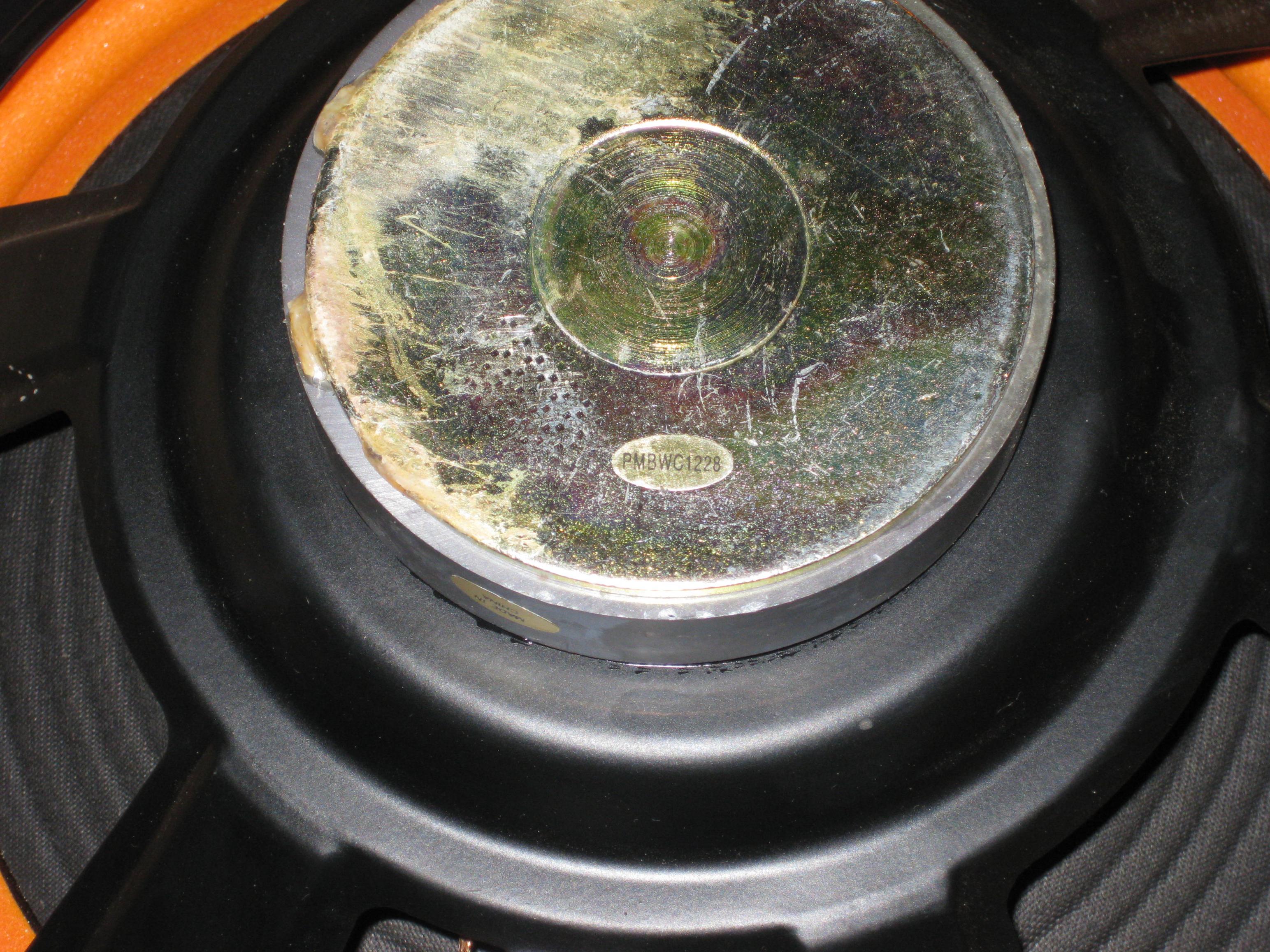

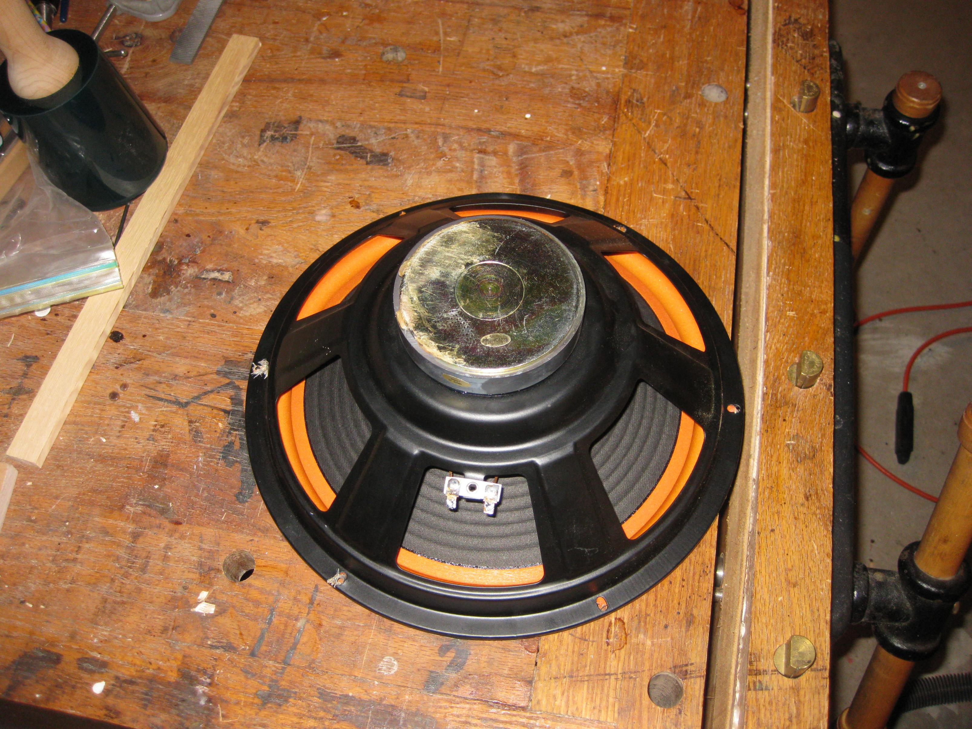

Thanks for the observations. If I knew that the 'orange' woofers were properly matched to the tweeters (and cabinet) I would just continue to use them and be done with it. But they don't seem to be as sensitive as I would expect the 12s to be (which is typically noted as having a sensitivity of 101 or 102 db). They are definitely not as sensitive as the other pair of Sound Dynamics speakers that I own (the sd 45s, which also seem to have a higher sensitivity than the normal range of speakers), which leads me to wonder if the woofers are not properly matched to the tweeters.
For those who haven't seen the pics on the other site Lojzek mentioned, here are a few of the drivers in question.
Hi Phil,
only PA drivers with powerful motors can come close to higher sensitivity
values. No way your SD 45 would ever come anywhere near that, maybe
around 90 db tops. An example of Eminence Beta 12A-2 in100 litre vented
cabinet, low passed. Manufacturer says 98 db,the break-up region exceeds
100 dB, the usable level is rather 94 dB in open space.

The horn tweeters in those 12s have what appears to be an L-pad at the rear of the cabinet. How would this relate to lowering the tweeter to match the woofer (in the current set up I find them a little harsh when turned up, and better when turned down).
Okay, so another quick scan of that article suggests that waveguides increase efficiency within a certain frequency range, and also increases directivity. When the frequency range is tamed with a filter the general result is lower distortion. Is this correct?
If so, then taming the 12s waveguide a little might actually result in a better overall sound? If so, then I would be interested in experimenting with that.

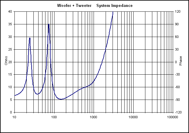

For what it's worth, here are the measured specs for a pair of 12S that I just took in. 12" woofer runs full range and likely rolls off naturally at the crossover point.
Piston dia = 10.375"
SPL = 91.64 (calculated)
Re = 3.809
Fs = 35.66
Qts = 0.5446
Qes = 0.6355
Qms = 3.809
Le = 0.4244
Mms = 63.08
Vas = 4.667 cu ft
Re = 3.809
Fs = 35.66
Qts = 0.5446
Qes = 0.6355
Qms = 3.809
Le = 0.4244
Mms = 63.08
Vas = 4.667 cu ft
