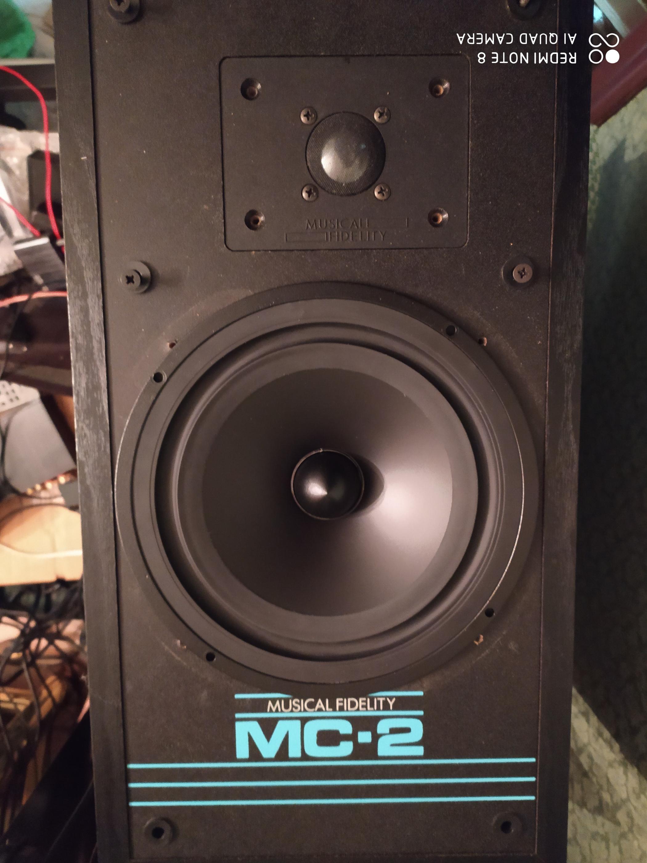

So this is where we are now. I did like the look of that polycone SEAS woofer at Falcon Acoustics:
Seas P21RE/P H0942-08 Woofer. H0313 2015 remake

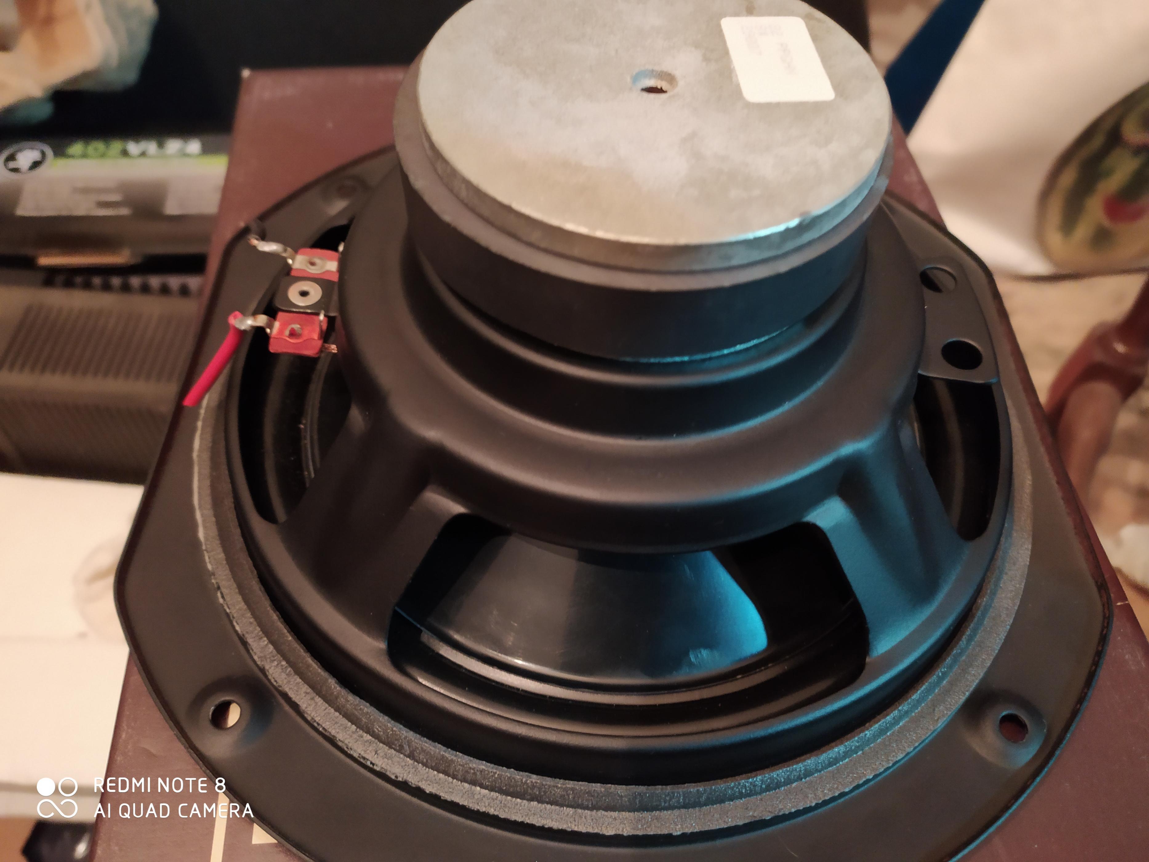

I think the old scraping woofers were Elac or Audax. Hard to tell really. Rotating them DOES work with a bit of experimenting on pushing the cones in at various points, just mark an arrow so you know where you are, but whatever.
This is an Elac with 217mm diameter on mounting bolts:
I can decipher the metal tweeter type:
SEAS type 25TAFC/G-MF
That's 25mm, Tweeter, Aluminium , Ferrofluid, Chambered / Grille, Musical Fidelity Bespoke.
About the same thing as this Aluminium/Magnesium dome (B) with a rectangular faceplate: H1212-06 27TBFC/G.

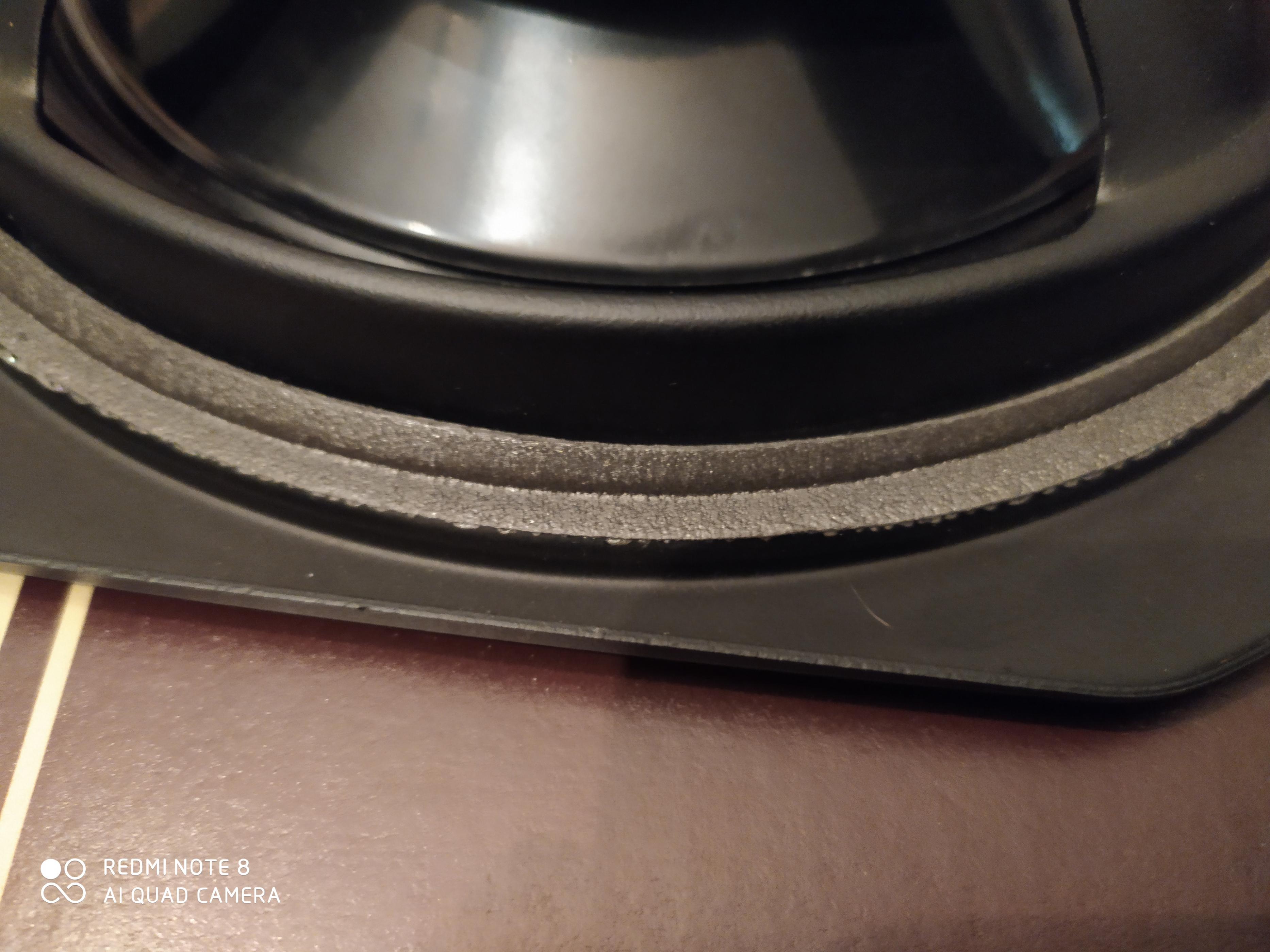

Anyway. All good, IMO. No reason not to just screw the new woofer in, with some sort of cardboard or foam gasket. I'd drill pilot holes and maybe put some PVA wood glue around them to keep the chipboard intact if you are close to the edge of the cutout.

Without a gasket there is a possibility of some small leaks, however as it is a ported speaker it is not as important as a sealed speaker, not perfect but a lower priority issue.
Because of the somewhat higher pressure generated internally in a sealed design, the leak will lead to less than perfect performance in terms of the bass tuning. Possibly worse from a listening point of view, it can cause hissing or other spurious noises.
Even the 1mm cardboard cut from a breakfast cereal box or some such can make a temporary gasket.
Ideally if after a few days listening you should be able to understand if the mounting and sealing is adequate or if you will need to cut another piece of wood to make a better/stronger baffle for the new woofer.
Hi ! i tried to rotate it while gently pushing the cone but the scraping is quite evident. I think that the coil could be detached from its support ?
I am quite hopeless to recover them. I have a friend who has more experience with drivers repair. He will have a look at them
Also the cone surrounds are not even ... maybe he will be able to replace the surrounds with new ones ... i do not know now.
So it must be at least of very decent quality. I respect Monitor Audio brand a lot indeed. The crossover is unbelievable ...
