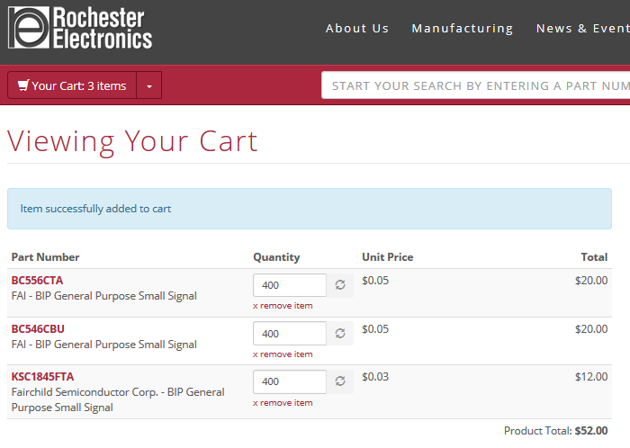

I looked them up on Octopart; it appears that Rochester has those devices in stock.

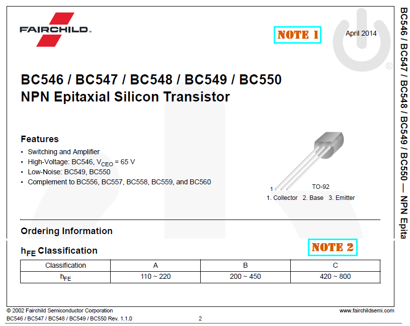

Rochester lists them as "Fairchild BC546C" devices, leading me to believe the parts were made by Fairchild. Incidentally, Fairchild refreshed their datasheet very recently {see Note 1}, which may suggest the parts are still rolling off the manufacturing line as long as you order sufficient quantity from the factory. Rochester will sell you quantity=one (at USD 0.05) if you wish; however their minimum order is USD 50.00.
Over the long term, the shrewd strategy might be to assemble a $50 total order, of a dozen various difficult-to-source parts that have always annoyed you. Then sit on your monstrous stash heap and guffaw at the poor devils in 2017 who can't find any, at all, at any price. For perspective, that same fifty dollars could purchase three or four bottles of mid-grade table wine instead, whoopie. It isn't a budget-busting expense requiring a shift to ramen noodles and canned beans for 3 months.
Another possibility might be to purchase the BC550C + BC560C instead. They are identical in every respect, except max collector voltage, and are widely available at numerous distributors. Then cobble together a little lab setup that allows you to measure VCBO and/or VCEO. You may find that the vast bulk of the BC550C population distribution meets the high-VCBO spec (BC546C), but some parts are sold as low-VCBO devices (BC550C) to meet market demand. At lower prices to boot!
