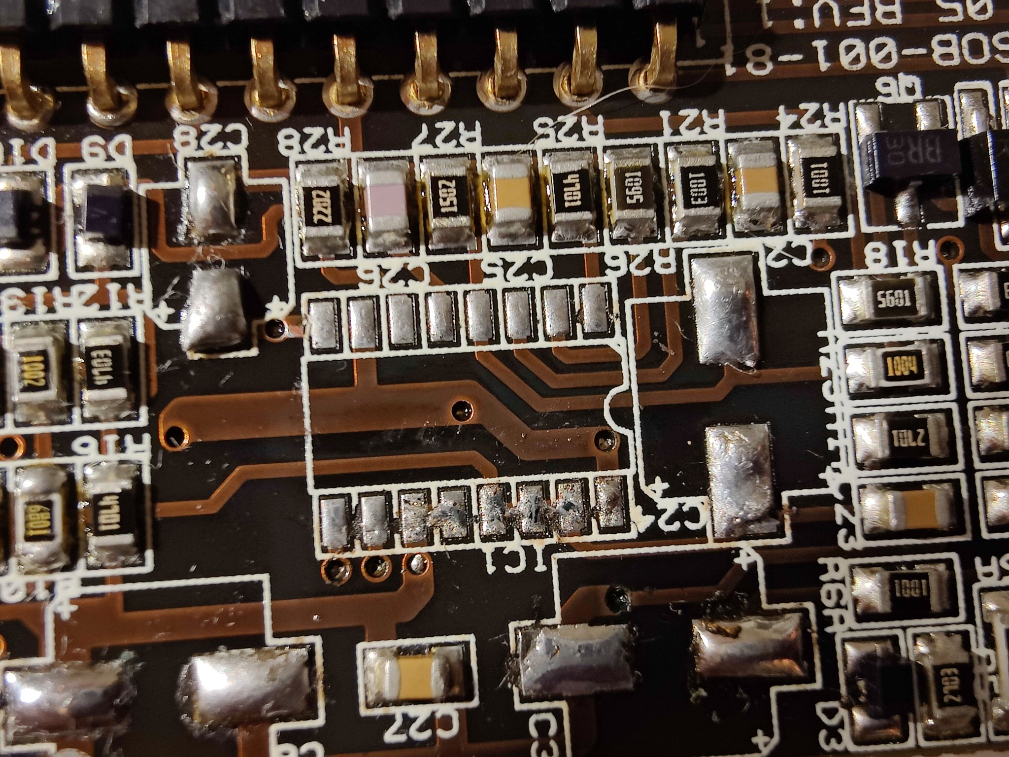

Back again & sad day for me today, I messed up on my driver board and damaged the pad for pin 12 on the ka7500, anyone selling one or know where I can find a replacement?
Also, on the aq2200 diagram I noticed pin 11 and 12 appear to be in parallel, could I just bridge them together instead?

8, 11 and 12 are generally all directly connected on this board but the 3-pin header makes it a bit different. You should be able to easily see if the traces were connected on the board before the damage.
8&11 are together, 12 is completely damaged so I can't trace it, it appears that it doesn't connect to anything unless the trace is in the board itself where i cant see it, if I jump 11 with 12 then the board powers up and gives me both outputs but only if I have the jumper removed. I suppose I could install the driver card and test the drivers.
With the shunt removed, does any of the 3 pins read 0 ohms to ground?
With the shunt removed, does any of the 3 pins read 0 ohms to pin 12 of the driver IC?
I also broke the trace on pin 15, once I fixed that the idle current dropped back down to 22ma, the three pins show open,open & capacitance to ground, but I think Im all good now.
Thank you once again for your help perry, have a great day bro.

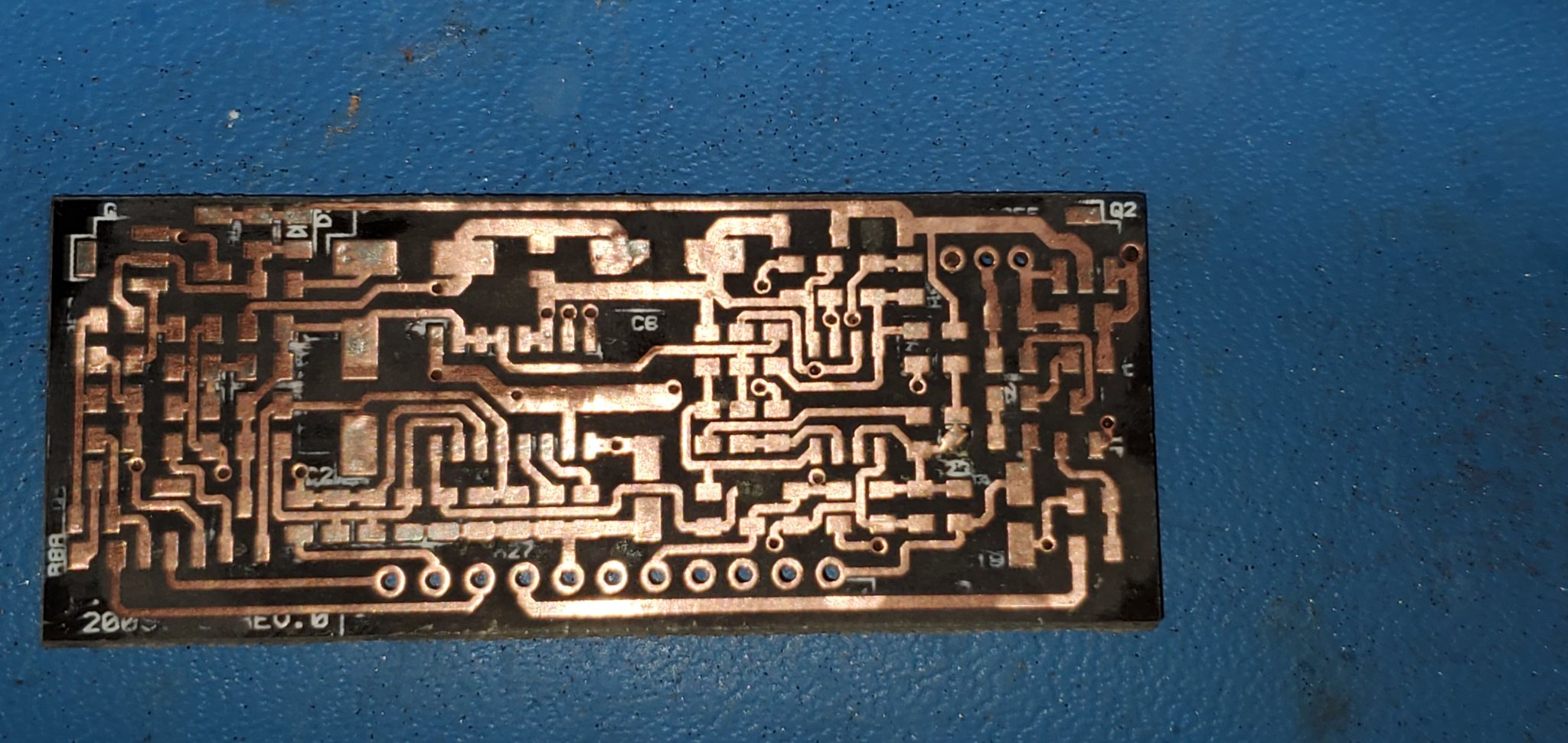

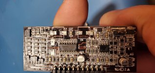

Its not pretty because I drew it. I did build the layout off of this schematic though and its tested and working in a DC 5K.
The rev of the board is different (EOB-004-70) from his but does contain the 3 pin header. From quick glance, this version just has a diode between the collector of Q2 and the REM net.

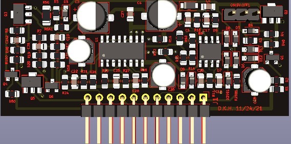

  • SOB-004-70.pdf
    SOB-004-70.pdf
