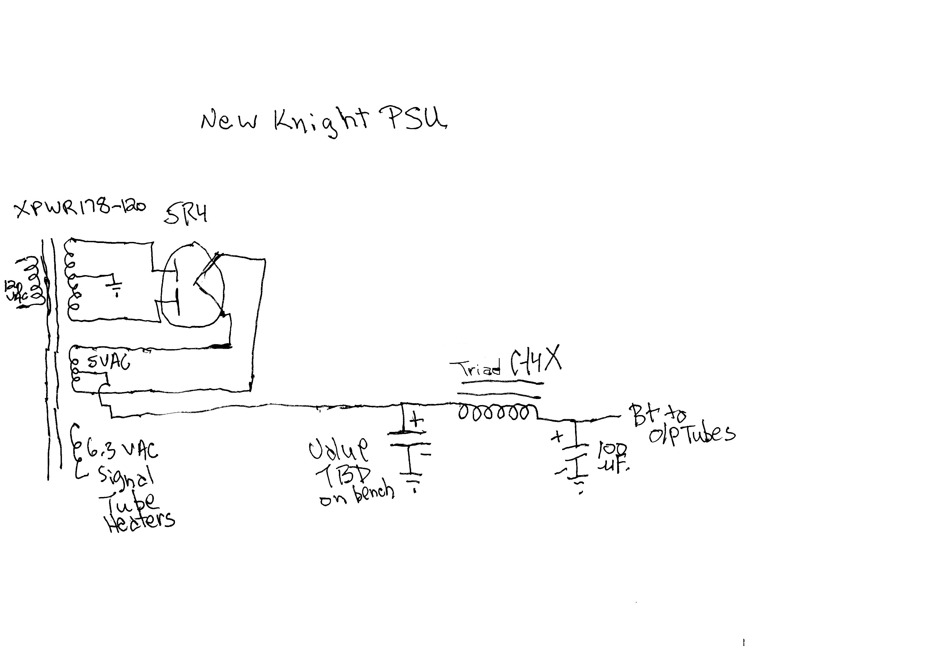

Hey Eli,
I'm not sure I understand this completely. I'll do a sketch and if you can tell me if I'm on the right track.
thanks
I've prepared some "hen scratches" that show how the B+ PSU should be rebuilt.
BTW, the 6.3 VAC winding of the XPWR178-120 has more than enough "sock" to provide for DC on the phono section heaters. 😉

This is great, thanks Eli. I actually had it right. But I do have one more question. After the 100uf cap, do I continue with the rest of the power supply as it is? Meaning this will connect to R64 and everything else will stay the same?
R65 and everything to its right stay. R64 and C1A are replaced by the CLC filter shown on the crude drawing I provided. The new 100 μF. part is the "380" V. source. As you work, if that number is a bit on the low side, it's good. The amp's designer beat the living guano out of everything. 🙁
Make certain to replace ALL electrolytic capacitors. Waxed paper caps. are candidates for replacement too.
Talk to McShane about tubes, caps., and an Octal socket. His prices are fair and he doesn't screw you on shipping. 😉 Good advice is forthcoming too.
Mouser stock # 553-C14X is the filter choke you need. As piecemeal shipping charges can "eat you alive", now (IMO) is a good time to order a new source selector switch too. Depending on the knob you use, either Mouser stock # 105-14572 (round shaft) or 10WA125 ("D" shaft) is appropriate.
