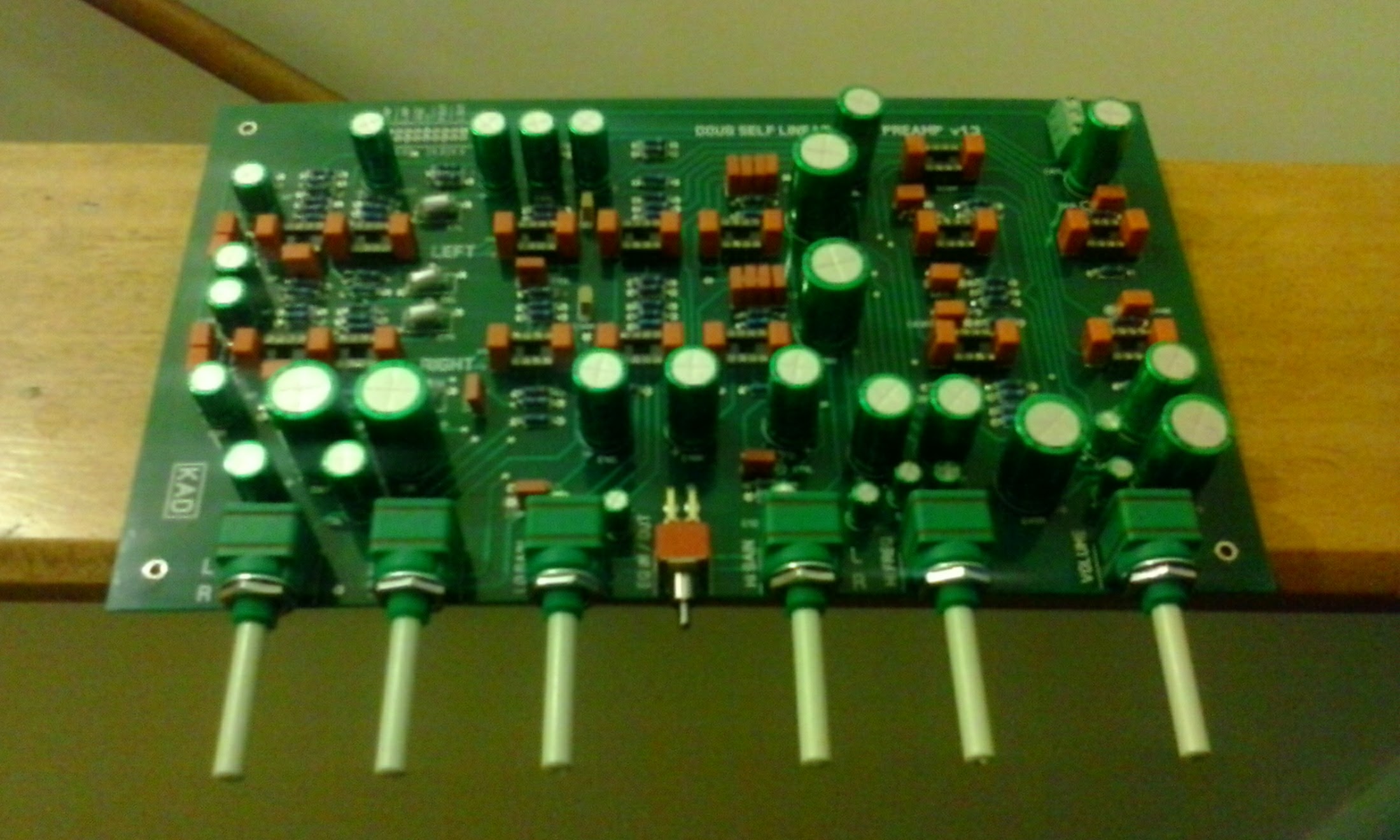

Here you are then............behold audio beauty.........
Are all those greens Nicichon muse es?

BTW if you need 10 uF 50V it will be MKS2-XL so polyester caps. AFAIK there are no 10 uF MKP caps in 5 mm pitch.
There is a 1 or 2uF Limit with MKS/MKP. Beyond that, you have to use Elkos. Mr. Self found out that 100uF caps produce more THD than 220uF caps. Keep that in mind.
They are good for signal path but for power supply hmm...i don't think so!!!
Huh ? I think I misunderstand. There exist 10 µF MKS caps. Are you saying that electrolytic caps are better ? Seems unlikely. Maybe better price/quality ratio ....
