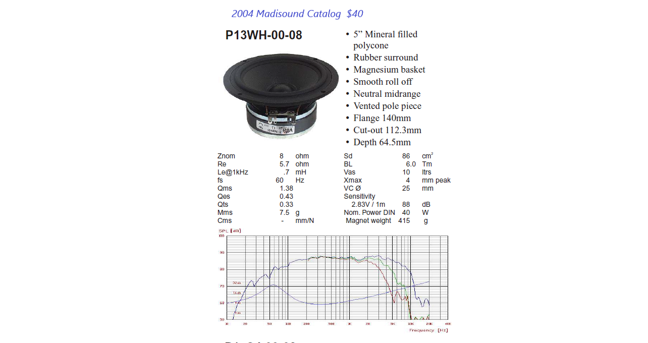

When I still had this speaker system, I had thought about replacement drivers. I thought the Seas CA15RLY-H1216 would have been a good replacement. It is slightly larger frame size (146mm vs 140 mm), but the same size cutout (112 mm), similar Re, similar Le, similar sensitivity, and similar on-axis frequency response. I attached the 2004 catalog listing for the Vifa P13 driver and the current spec sheet for the Seas driver.
