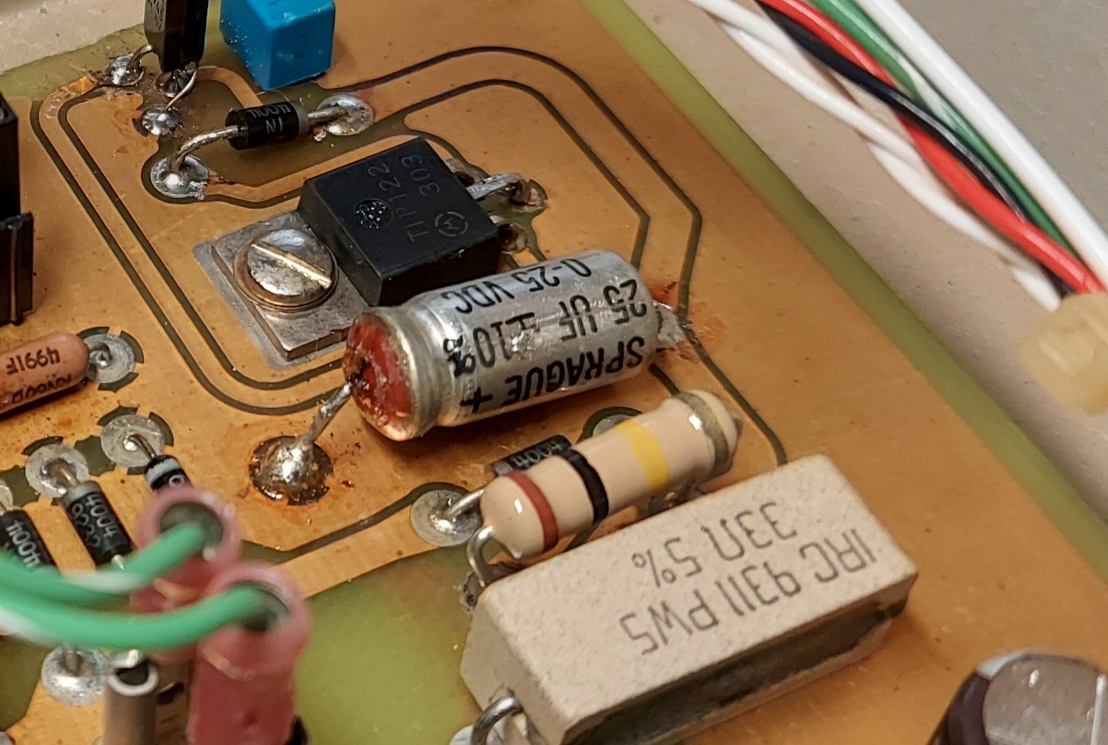

Hi, I need some help. I have done some research but still can't find enough information about this Sprague 25uF 0-25VDC axial capacitor.
It looks like it needs to be replaced. Any suggestion is most welcome.

Its in an amplifier I bought 30 years ago. I suspect the cap is even older. It looks like the red cap/seal is breaking or melting and since I already have it opened up, I just might do some work to make it last longer. It is running alright.
If you can, check for leakage with resistance range in 10k or so with a meter.
Also, if you have one, check its capacitance with a meter.
Could be age related break down of the casing.
Sprague are good, I don't know what kind of capacitor this is.
You looked for a replacement in axial construction?
What is its function in the circuit?
Thank you Naresh. This is in a power supply board. Not sure what's its function though. I have a regular meter and can check the capacitance but don't have a ESR meter. I know Sprague is good so I want to get a good replacement. For peace of mind.
