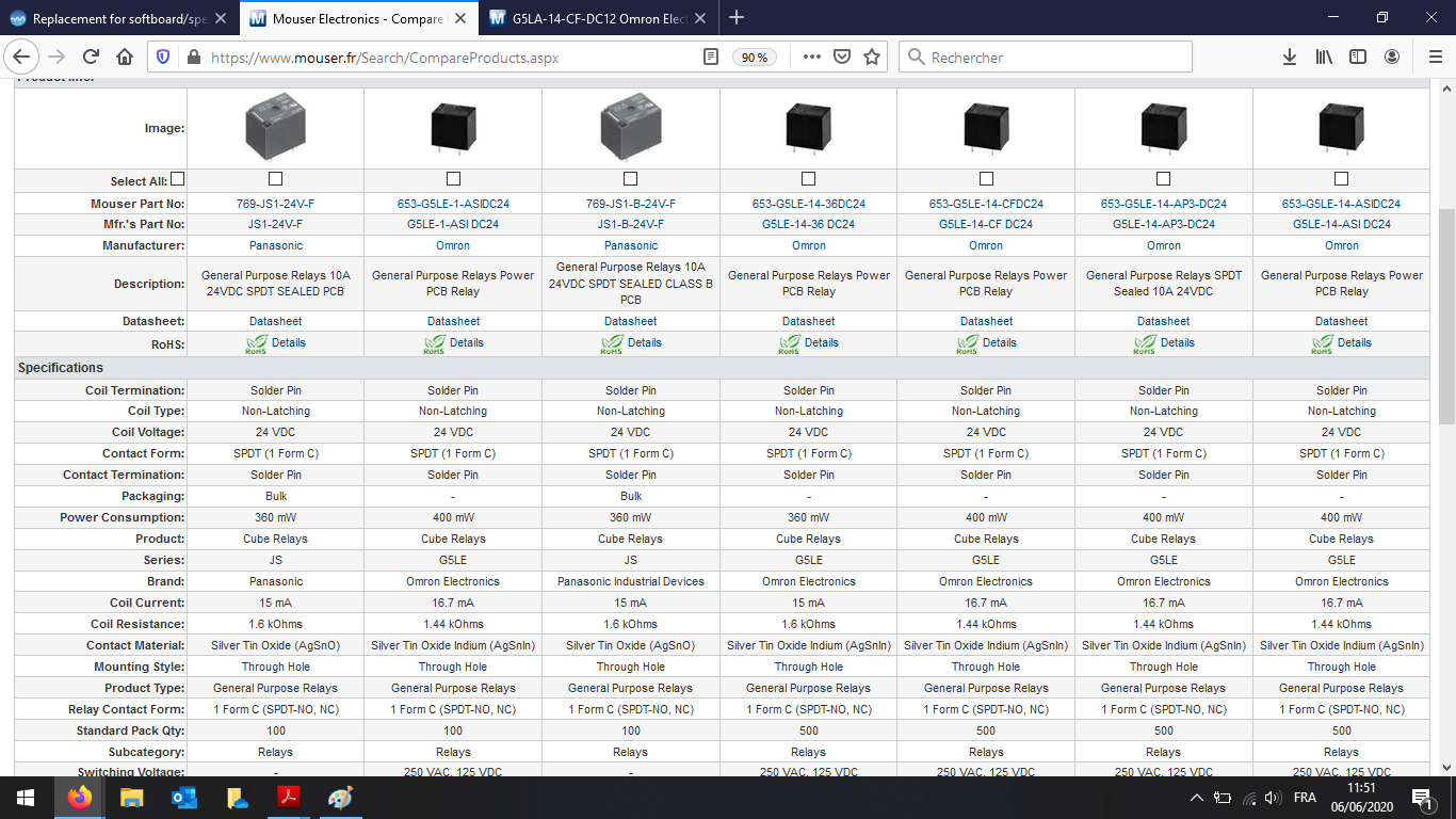

hi - i just bought and soldered the speaker protection board from Diyaudio. The relay 653-G5LA-14-CF-DC12 from the BOM is obsolete (I do not know why they do not inform the users before purchase). I have informed the store but they said they are not technical and cannot help.
The suggested replacement part from mouser does not fit the pins. Does anyone know the correct replacement part? I need the 24vdc one.

I was bored while having my first coffee, so had a quick look... to me those should all fit, but PLEASE double-check the datasheets before ordering. Easiest would be to go with the G5LE instead of the G5LA, make you your get the right "suffixes" for instance SPDT vs. SPDT-NO ... identify the exact spec using the obsolote part numer and transpose to the similar G5LE series

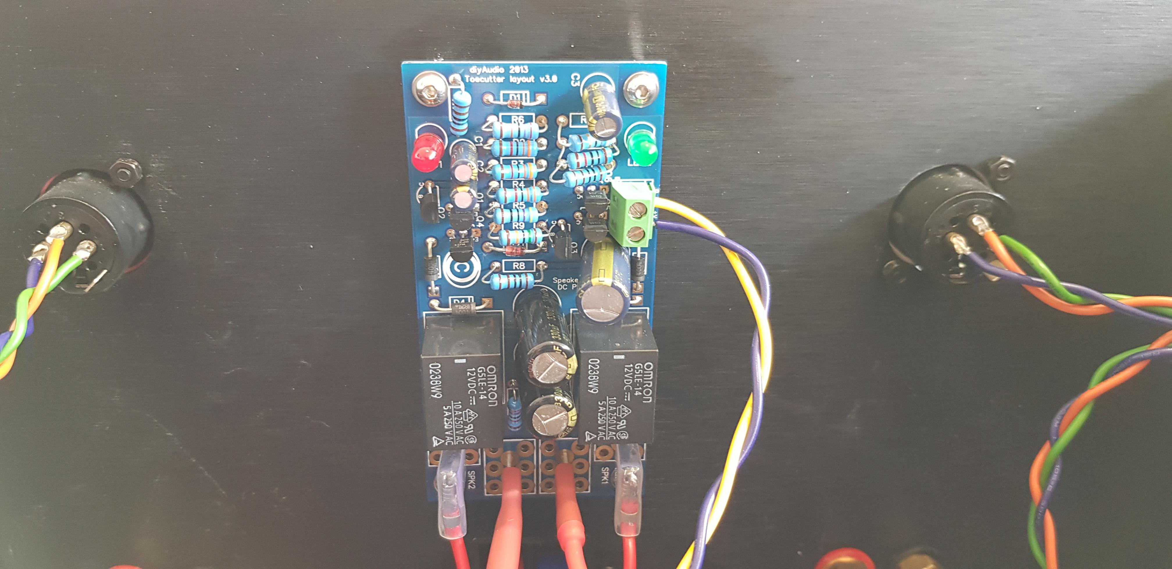

My Aleph J is built with a +/-24VDC supply and my notes tell me that I used 2 x Omron G5LE1A4CFDC12 for the store speaker protection rig that's running inside it.

hi - i am not sure that these would work. The pins do not look right
Refer attached pic.
You can double check the component data in the shot against the info I provided. They fit and were purchased back at the start of 2019. There are still plenty on offer around the place if you use Octopart as a go-by.
Haven't tested them in anger though and no plan to try.
