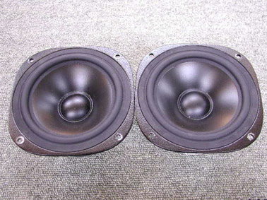

Some excellent SEAS transducers, that I prefer for service and replacement at old Chartwell and other british loudspeakers, are out of production and no longer available.
Here are an overview about this types:
1) H 352 (H0352, WP171, P17RCY), go to
http://www.seas.no/images/stories/vintage/pdfdataheet/h0352_p17rcy.pdf
2) H 435 (H0435, WP171NP, special made for IT electronic, not to find by seas website)
3) H 452 (H0452, M14NP, special made for IT electronic, not to find by seas website)
4) H 434 (H0434 W140NP, special made for IT electronic, not to find by seas website)
http://www.lautsprechershop.de/hifi/images/w140np.jpg
5) H 393 (H0393 P14RCY) go to
http://www.seas.no/images/stories/vintage/pdfdataheet/h0393_p14rcy.pdf and
http://shiroiharu.blog.eonet.jp/photos/uncategorized/2009/04/23/dsc_00091172000.jpg
6) H395 (H0395 P14RC) go to
http://www.seas.no/images/stories/vintage/pdfdataheet/h0395_p14rc.pdf
7) H702 (H0702, H0822, T14RCY, XP cone, for IT electr: H696 MT14) go to
http://www.seas.no/images/stories/vintage/pdfdataheet/h0702_t14rcyp-h.pdf
Please note, that I am not a good friend of phase plugs so as aluminium-, titan- an magnesium diaphragms. I prefer only materials like paper (also coated), polypropylene, kevlar and carbon.
Perhaps there are additional drivers on the marked with similar character.
For service and maintenance especially the models H0452 and H0434 I have often use as replacement for also no longer available Harbeth transducer's in older british hifi boxes e. g. like Chartwell, Harbeth (LF-5) and Rogers - see
http://www.zenn.com.sg/Chartwell_PM110.JPG and
http://shackman-electrostatic-loudspeakers.reromanus.net/Harbeth-ML-BBC-Monitor-12.JPG
What type of currently available ones likely I could use as a replacement?

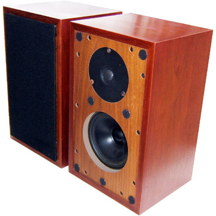

In the moment of most interest is the SEAS WP140 (XP cone) for repair Chartwell's PM110.

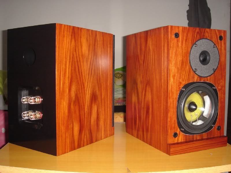

To 4) H 434 (H0434 W140NP, special made for IT electronic, not to find by seas website)
used in intertechnik monitor model No "MS2" (MS-II") MK1 (MK-I)
Strassacker: Lautsprecher - Boxen - Selbstbau

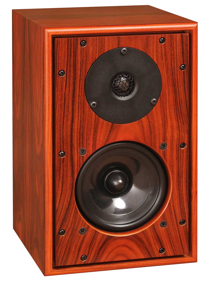

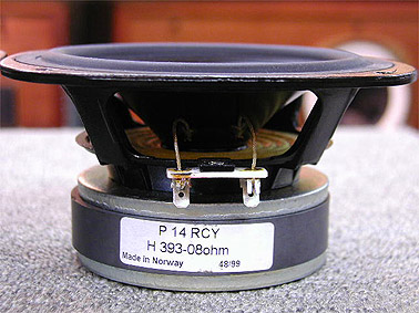

To 5) H 393 (H0393 P14RCY) go to
???????? McIntosh/JBL/audio-technica/Jeff Rowland/Accuphase/?/?¾?????
used in various Harbeth models
Quote about
Stereophile: CES 2009 Show Report
"The SEAS tweeter is unchanged, but the woofer had to be changed, due to SEAS discontinuing the original's driver"
This means SEAS H393 inside in model "HL-P3" and no SEAS inside in "HL-P3-R"

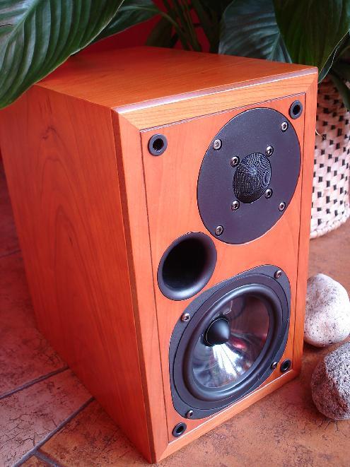

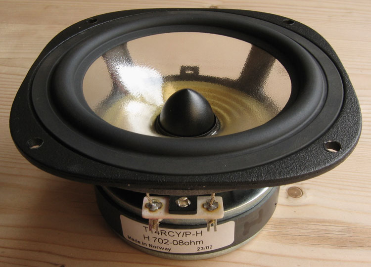

To 7) H702 (H0702, H0822, T14RCY, XP cone, for IT electr: H696 MT14) go to
inside in ProAc
ProAc Response 1SC | AUDIOCONCEPT
and ProAc Clones
The ProAc Response 1S Clone
http://www.tubeamparts.com/docs/1sc.19111223.jpg
PROAC 1SC

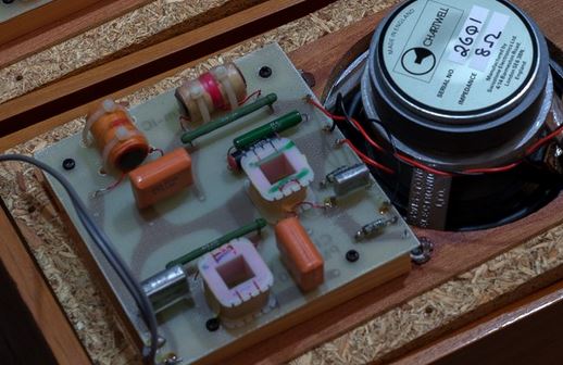

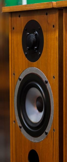

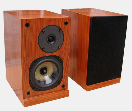

In the moment of most interest is the SEAS WP140 (intertechnik, XP cone) for repair Chartwell's PM110.
the seas genuine type is follow:
this pdf I have found here:
http://www.seas.no/index.php?option...fers&catid=25:seas-vintage-drivers&Itemid=426
Tiefbassuebertr, are you looking for physical or electrical equivalents, or do you want a drop in replacement? Electrically, I would have thought that there's plenty of choice in the current 15Cm SEAS range, although that may require some xover tweaking. Physically may be more difficult with the shape of that t14 surround. What's the usual failure mode of these drivers, is re-coning not an option? cheers,
I am looking for electrical equivalents - most importing thing is getting similar Sound Charakter. I don't like phase-plugs, thus follow chassis would be the right choice:
http://www.seas.no/images/stories/vintage/pdfdataheet/h0822_t14rcy.pdf
reconing isn't posible due no longer available recone kits. But the re-wound of the voice coil is possible, but too expensive cause a lot of additional work steps therefore, which are necessary.
what means the abbrevation "XP" ?
Which other terms exist additional in colloquial english for this transparent polypropylene cones ?
Is this a very special kind of polypropylene?
Which manufacturers uses still this material for diaphragms except Tangband?
Unfortunately, I am unable to get the same sound with replacement speakers, which have the normal (black) polypropylene cones, despite identical frequency response (create by tuning/adjusting of the present crossover network)

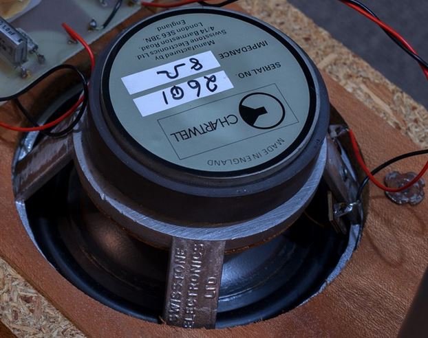

I think SEAS use XP to say polypropylene bass.
T14RCY-P
Looks a hard driver,that. Needs a 1 kHz notch.
Looking at the Chartwell PM110, which I have heard, as it goes.
It's a Rogers/swisstone clear polypropylene 5". Heavy cast chassis.
Probably cardboard not metal former, hence high Qms around 4 I'd guess.
Chartwell have used Rogers/BBC type 4th order filters here by the look of them. Good news is they haven't needed a notch. So I think the Monacor MONACOR INTERNATIONAL : SPH-135/AD is worth a try.
KEF and Dalesford drivers were pressed steel chassis and quite distinctive to look at. Black coated bextrene.
