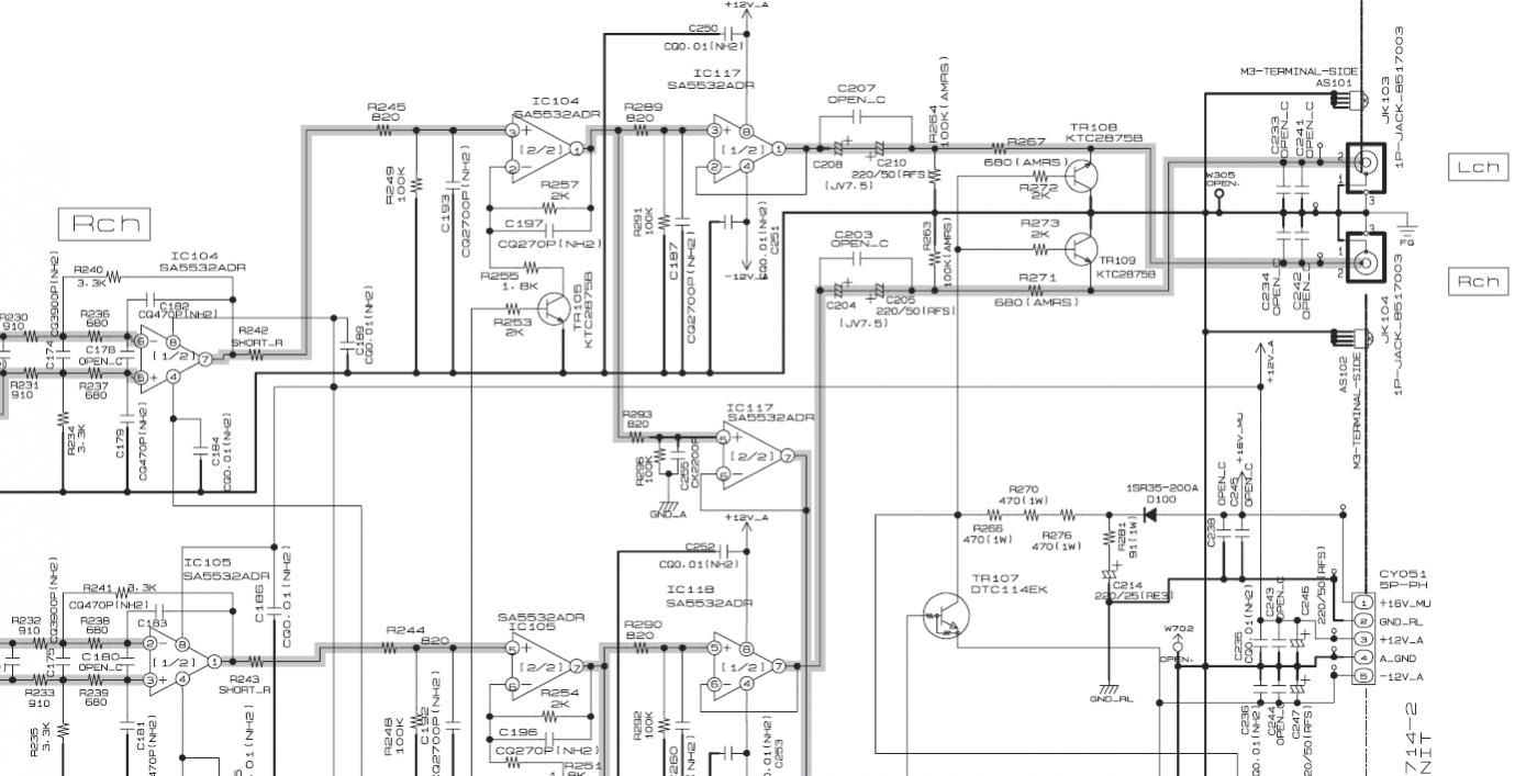

Schematic with NE5532
So here's the schematic - would LM4562 work ok in this circuit? would very much like to get it right from the first attempl, since devices are SMD-type and i don't believe i can do much de-soldering / re-soldering without damaging the pcb...

If you like you must excange all the opamps. Put the JFET's opamps. OPA2134 it is an ideal for you in that configuration. You don't need to modify the power supply, it is possible to be stable without another caps. In that schematic, you have a lot of series resistance , like 820 ohm, and that will rise up the source impedance. It is not good for the input signal currents of the BJT's opamps like 5532's. So, you can exchance it with OPA2134 wich has a huge input impedance. Don't put there a too fast opamp, one with slew-rate of 20V/us it is perfect.

The LM4562 would work perfectly, so to the OPA2604, both of which are available in SMD. The 2604 remains a personal favourite for me.

Replacing of the mute transistors with FET's is something you might consider. These are TR108 and TR109. You can run the player with these disconnected too, to see if you can detect any difference.

TBH that circuit looks just fine for a '5532. Inverting (which eliminates several major distortion sources), not an awful lot of gain or loading. Measurable improvements, maybe, audible ones, hell no.
I would rather look into installing some bypass caps for the "no_use" parts (C4233 et.al.), and C4226 et.al. seem like a skimpy beancounter's choice as well (10µ / 25V+ bipolars would be more appropriate).
