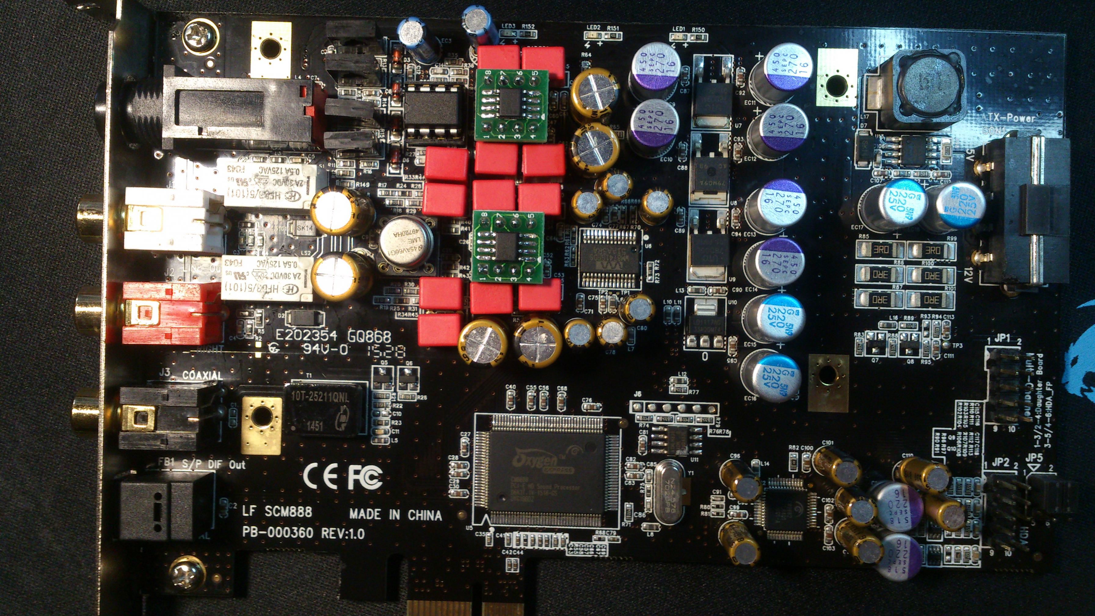

The soundcard uses the Wolfson WM8741 DAC
here is a picture of the soundcard
Besides instability you need to check that the chosen opamps can work with the supply voltages used on the card. 99.9% chance there isn't an issue here although the 4580 is one of the few that can work at very low voltages (-/+2 volts). It can also drive low impedance loads well (it has a relatively high output current capability of -/+50ma) and so if its used as headphone amplifier this is important.
If you just want to experiment to see if you can discern audible differences then try the NJM4558 or JRC4558 and the TL072 or TL082. These cost peanuts and it would be an informative exercise fitting them. You might like them. Keep an open mind and listen. The other two to try are the LM4562 and the OPA2604.

Based on the components on the board, the 1/4" jack have emitter follower boosted outputs, so the loading on the opamp might not be so big.
I can't tell what the regulators are so uncertain what the voltage might be. You can measure it directly from the legs of the opamps though.
It would appear a LM4562 is already fitted on the line output stage.
Aside from the already suggested, one that I might try on what presumably is the I/V stages after the DAC would be the ADA4075.

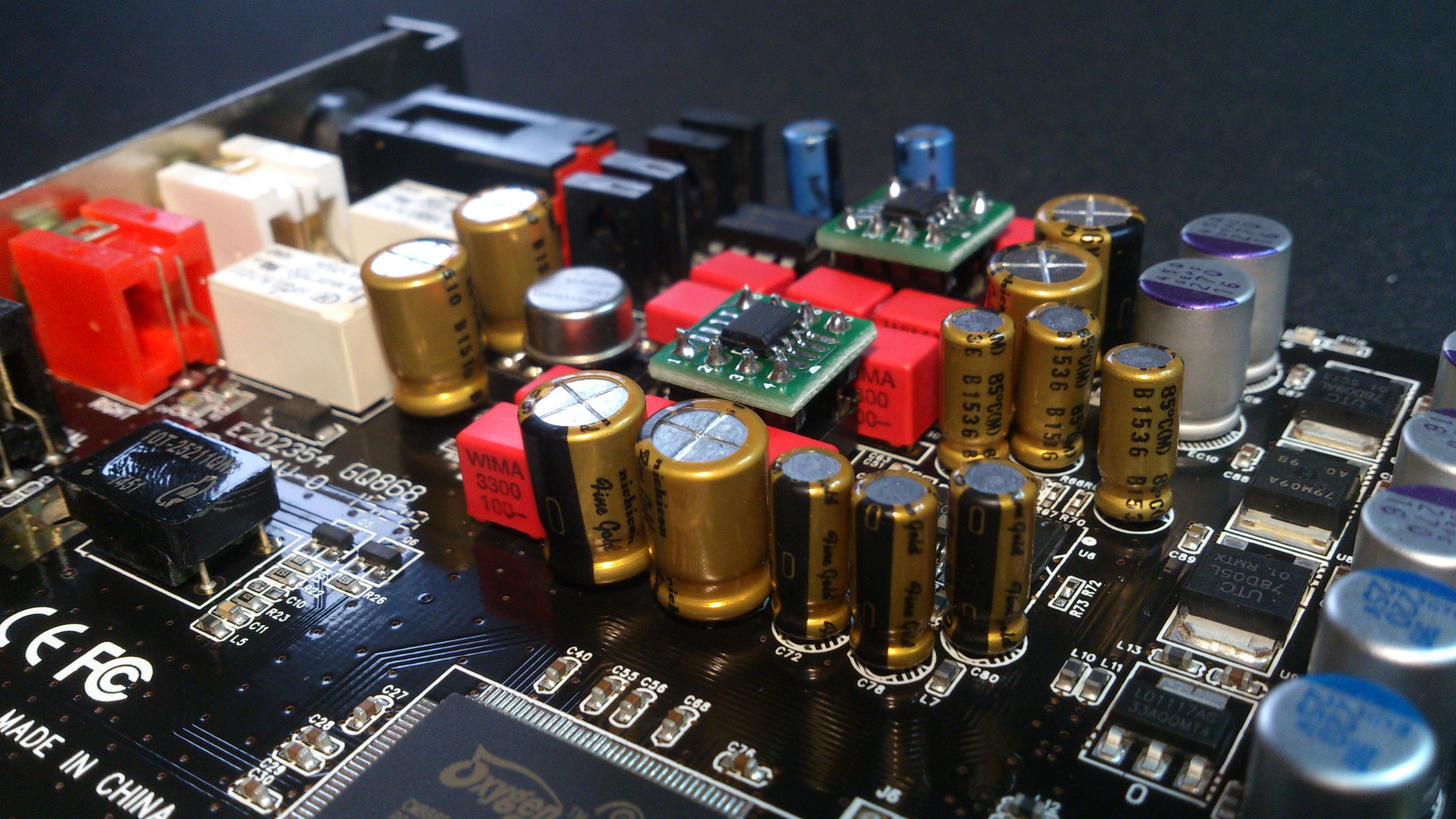

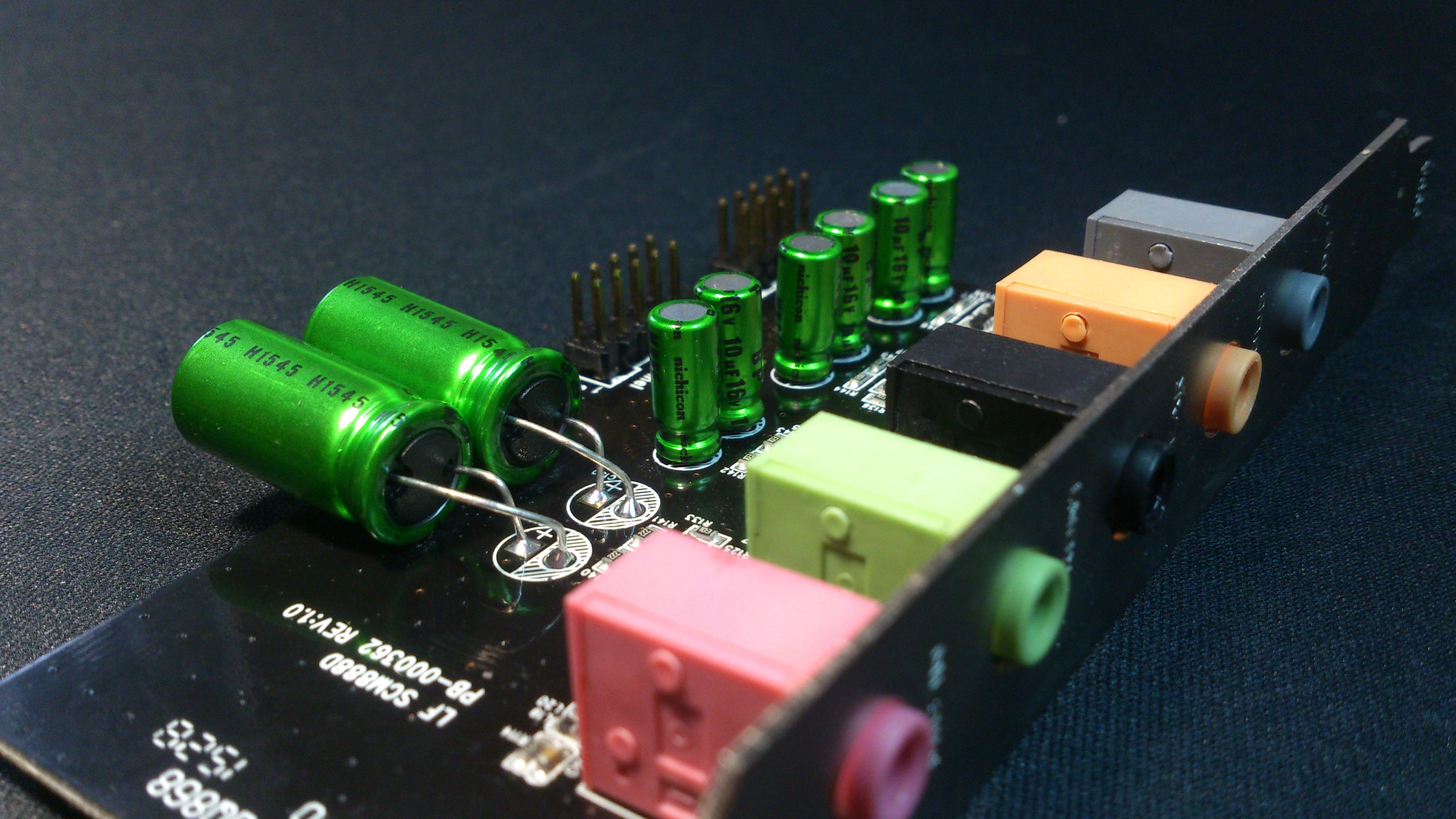

Hey guys, Hey Mooly!
this is a great forum! i learned so much the last few weeks reading threads here.
I bought a semi professional smd soldering station with iron and hot air blower and have done my very first electronic soldering. You got me, i think im f**kin into it 🙂
I reworked the whole card lol.
On the main card I have used Nichicon "Finegold", Nichicon KA, OSCONs and Chemicon APSG. The film capacitors have been replaced with WIMA FKP2(with tighter tolerances)
Also placed an additional DIP socket where the LM4562 was soldered into the pcb.
The opamps replaced: changed the LM4562 to LME49720HA - replaced the 4580D with AD8599.
the sound dramatically improved after changing the caps (tested with the original opamps at first)
On the daughter card: Nichicon MUSE Bipolar
