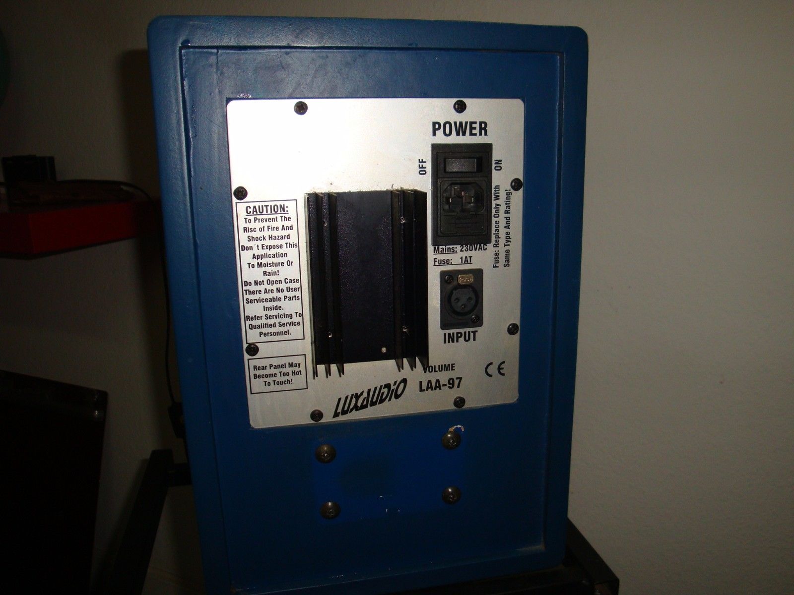

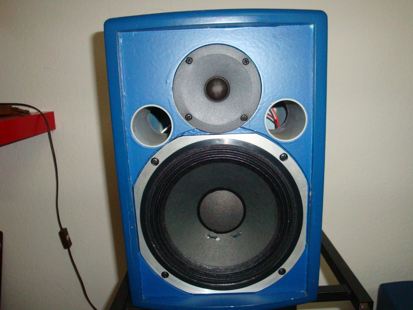

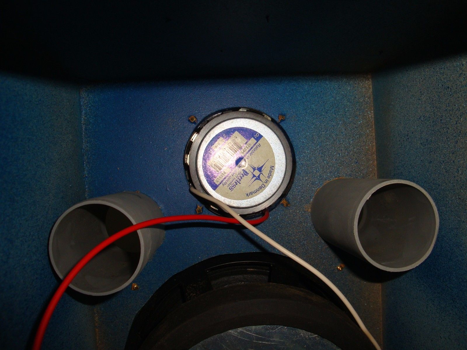

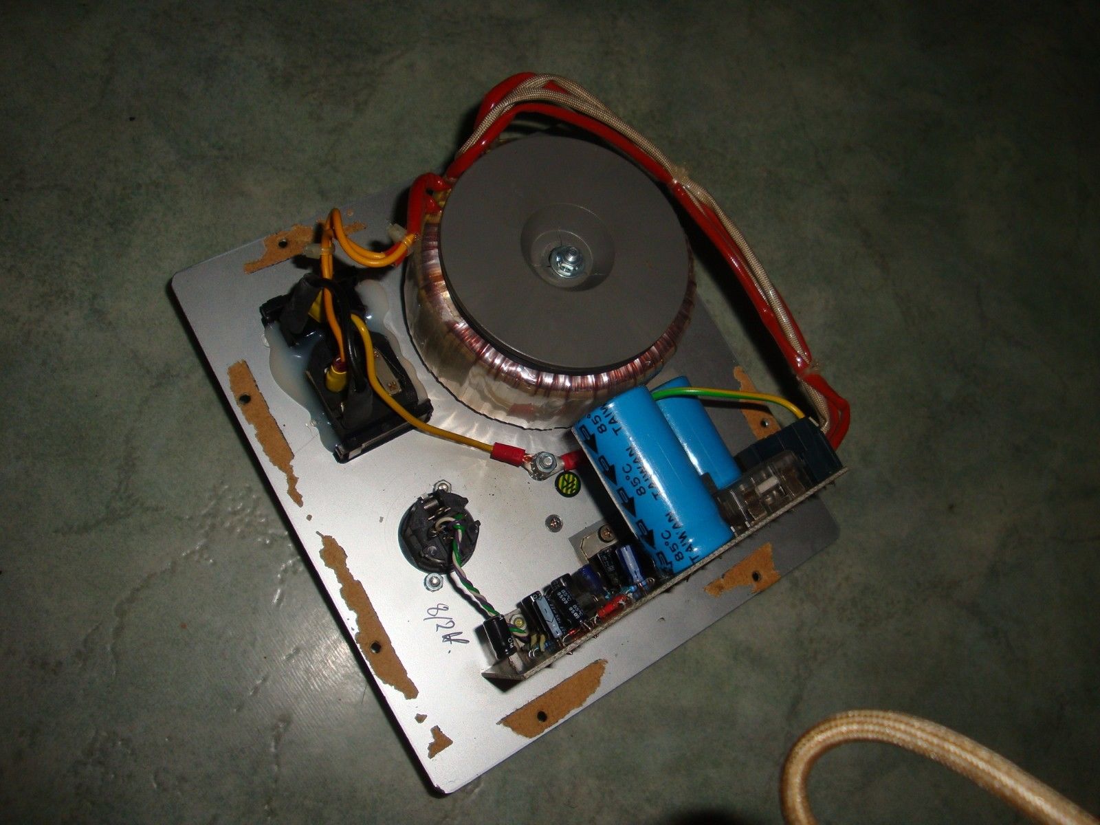

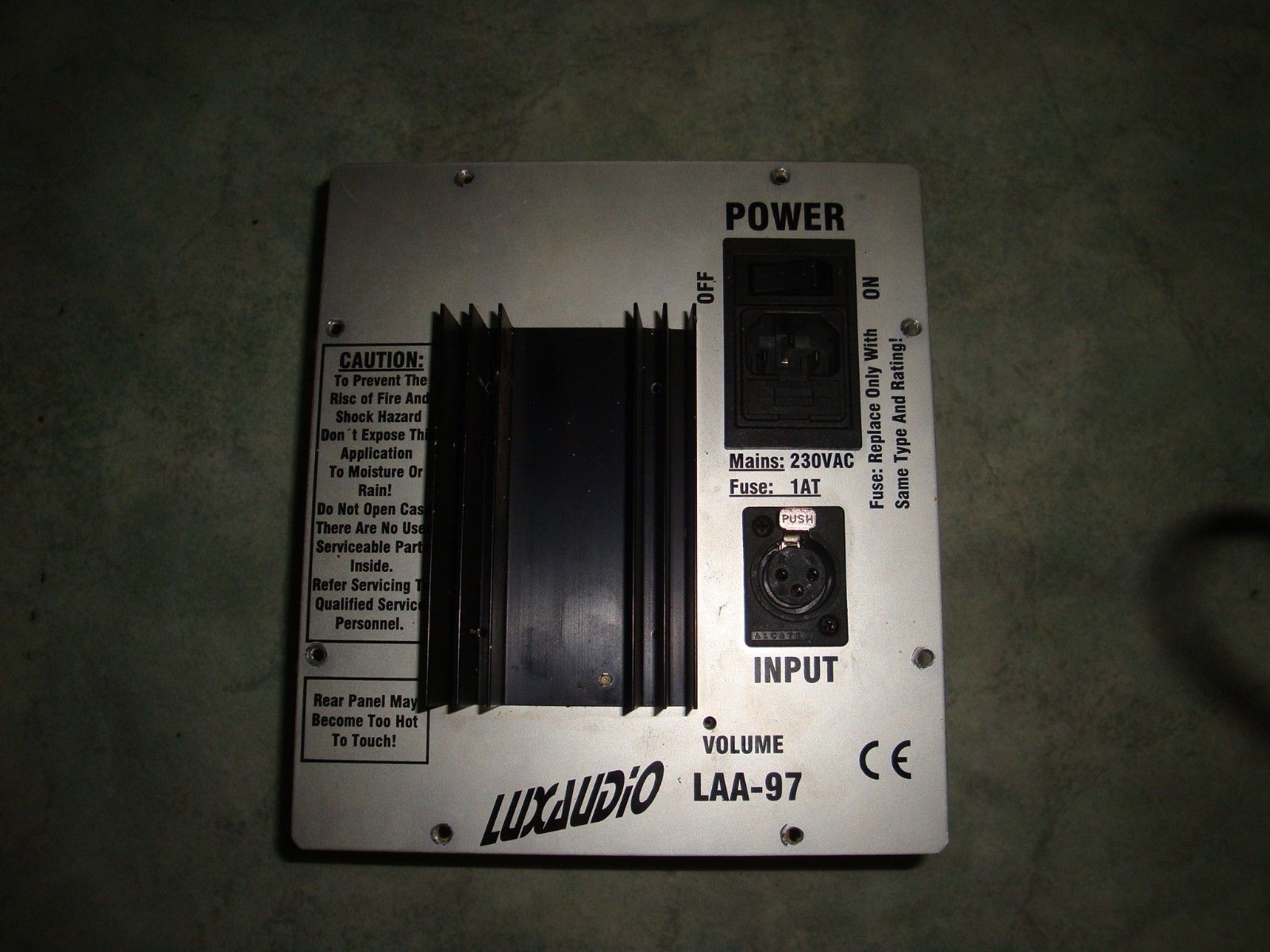

LuxAUDiO LAA-97 equipped with Fane Studio 8M - Schematic wanted
For performing some upgrades I want to have a service manual. Who know trhe manufacturer from this active loudspeaker with passive crossover ?
