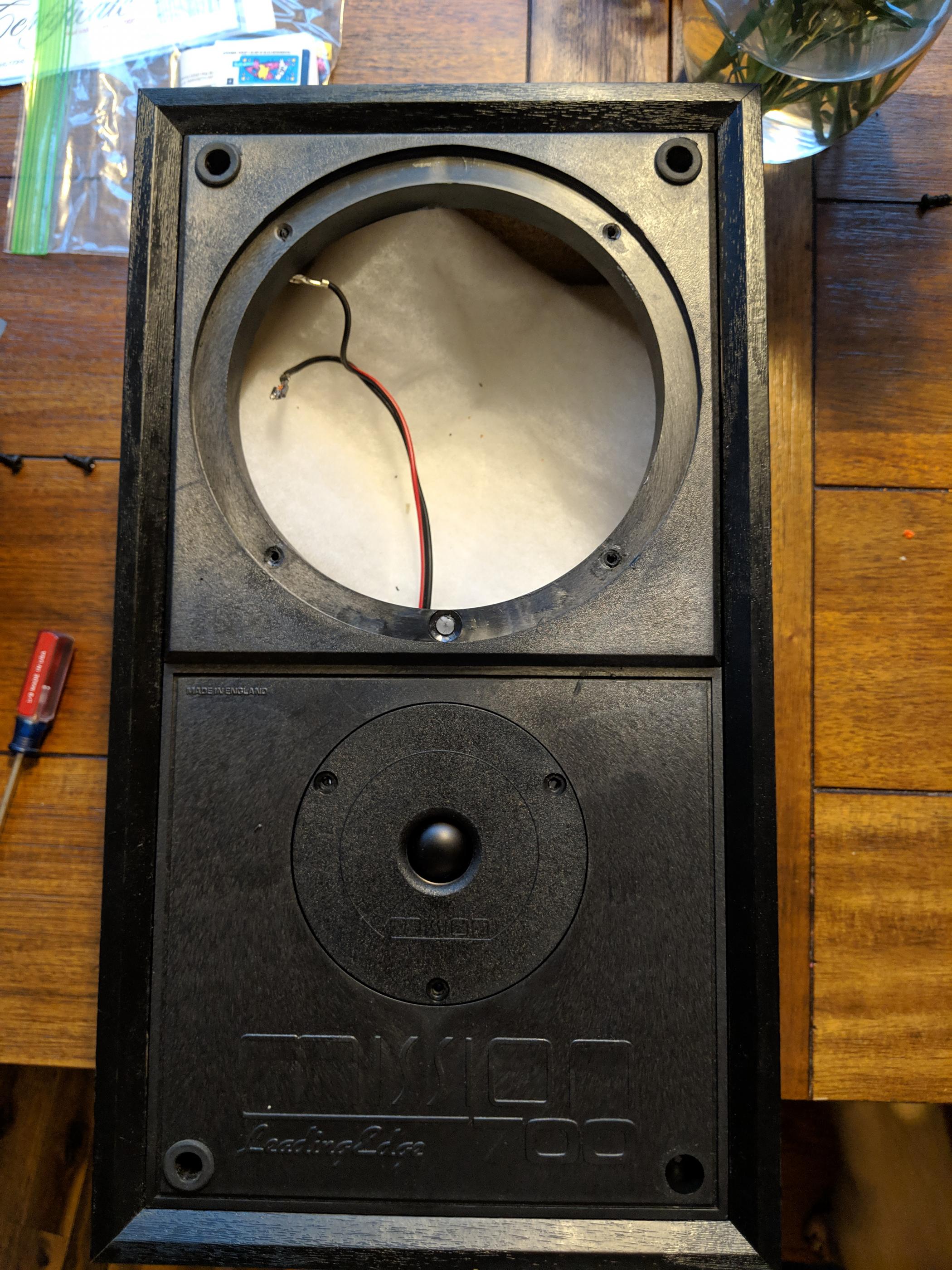

Hi, I have a pair of Mission 701 speakers, and one of them has developed a rattle when playing certain low frequencies. It's particularly noticeable when watching movies. The affected speaker got pushed off its stand once or twice by children (now firmly mounted on the wall), and I guess there's now a misalignment somewhere in the driver.
So, if I wanted to replace the affected driver, does anyone have any suggestions for similar drivers that I could swap in? I'm guessing that I'd probably need to replace the one in the other speaker too, unless I can source an identical unit to the broken one?

I've found reference to the "Infamous Mission 700 Series baffle rattle", caused apparently by the water based glue used to glue the driver mounting baffle to the cabinets giving up after a few years.
This may be your problem and not a faulty mid/bass driver after all. It's worth investigating this possibility.
The solution is to re-glue the baffle to the cabinet.
Instructions re removing the baffle are in this link: Mission 701 rattle | AVForums
