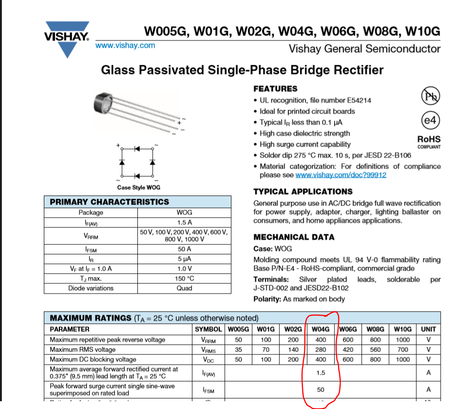

A 400 volt bridge is specced for up to 280 vrms input. Look up some official manufacturer data sheets. These were standard fitment in VCR, satellite receivers etc etc.
That makes it quite clear.
stating both the DC output rating and the AC input rating leaves no ambiguity.
Whereas stating 400V confirms nothing.
