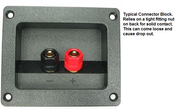

a local homebrew studio has some of these they concluded the same (blown woofer) when in fact the binding post needed to be tightened (not making proper contact)

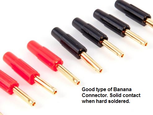

If the nut behind the plug gets loose, you lose the bass output, which happens when you turn the grip thing. The image below is not biwired, but the plugs work the same way. And if you're like me, you don't have any decent tiny spanners anyway. For all that, solder joints shake themselves loose too.
