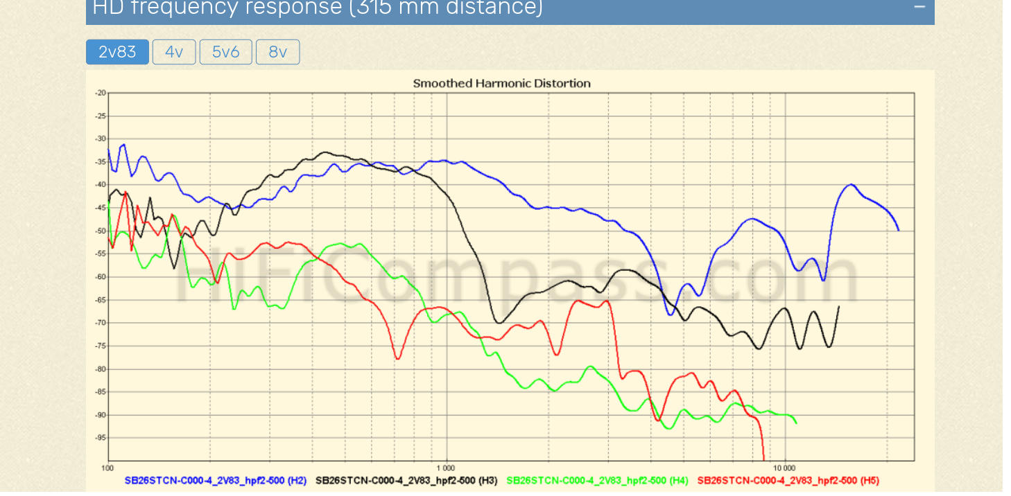

I thought I'd "improve" the tweeter, OD 78mm, by using the well reviewed SB26STCN which is the same compact size. Result was different but not better. The highs were smoother and less stressed, but quite a bit of detail was lost, specially apparent in orchestral music in e.g. the woodwinds where the individual timbres were somewhat blurred. I don't have measuring equipment, but the frequency response sounded similar except that the highs were maybe more rolled off.

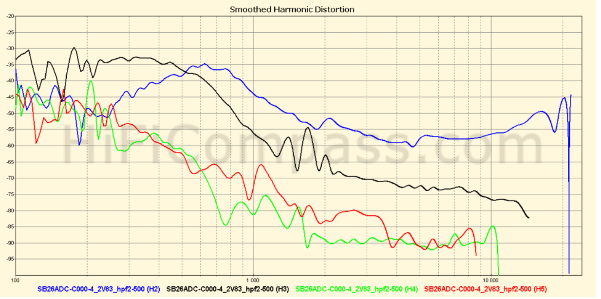

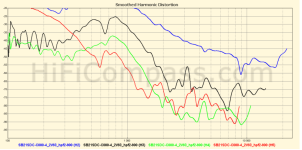

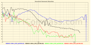

In terms of harder domes, what would you expect from SB26ADC or SB26CDC ceramic? I'd imagine plenty of detail?

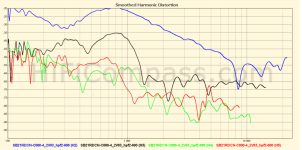

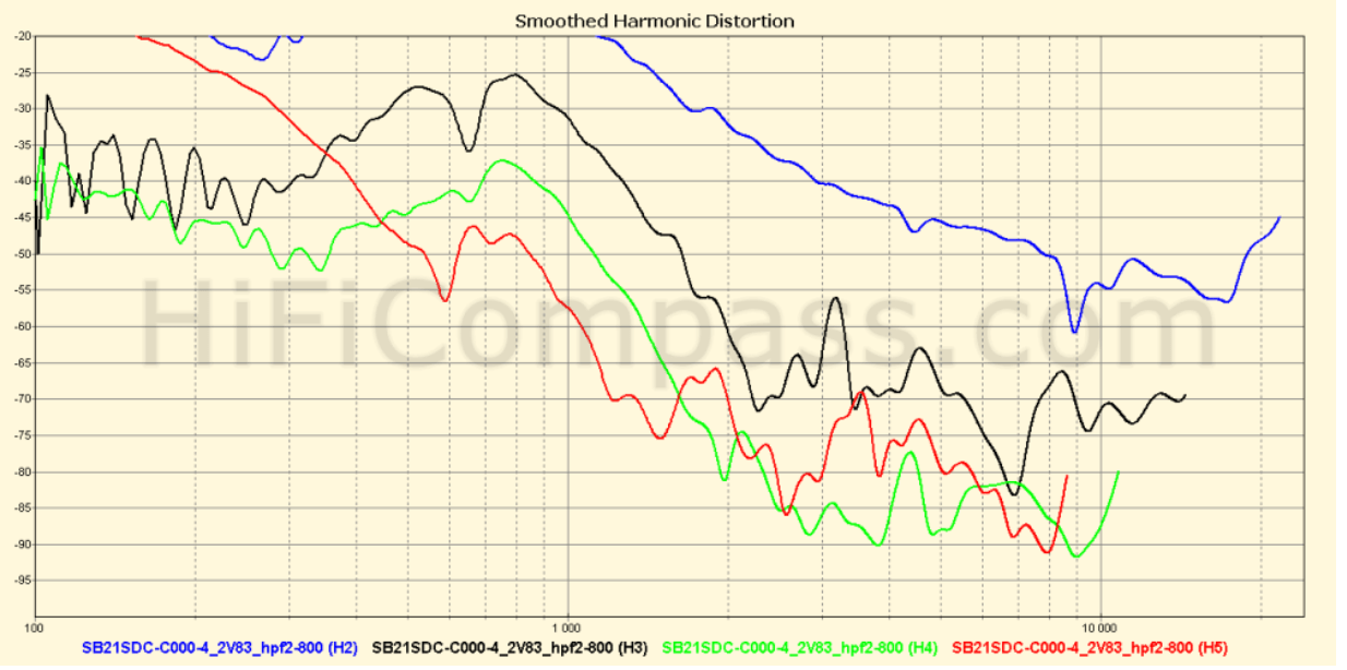

Do you know the SB21SDCN? How detailed is that?
The SB Acoustics SB26STCN has a nominal impedance of 4 ohm and a DC resistance of 3.2 ohm.
https://willys-hifi.com/products/sb-acoustics-sb26stcn-c000-4-tweeter?variant=40658270060718
I've seen the Wharfedale 0316H quoted as having a nominal impedance of 8 ohm and a DC resistance of 6.3 ohm.
In consequence, substituting the SB Acoustic for the Wharfedale without redesigning the crossover will alter the sound balance of the speaker.

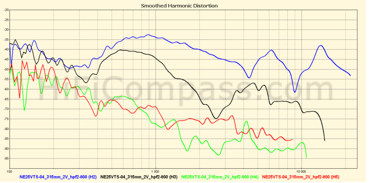

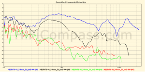

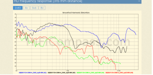

Try a non-ferrofluid tweeter. Recently I've been using & liking the detail & immediacy of a pair of Peerless NE25VTS-04

yep but some time can be too much ,I dont like SS D2008 but lowed D2010 and a problem for xo....Try a non-ferrofluid tweeter. Recently I've been using & liking the detail & immediacy of a pair of Peerless NE25VTS-04

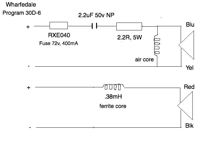

For info the air core on the HF is 300uH.
Edit....mind you the XO I have here from a 30D has a 4r7
A 2.2 uF capacitor and 0.3 mH air core inductor indicates a crossover frequency of 6,000 Hz when used with an 8 ohm tweeter (the Wharfedale 0316H).
To achieve the same crossover frequency with a 4 ohm tweeter (the SB Acoustics SB26STCN) would require a 4.4 uF capacitor and a 0.15 mH inductor.
Adding a 3.3 ohm resistor would fix that issue and you'll drop 4 to 5 dB in output, which will put you at 88 - 89 dB/2.83V = with DCR of 6.6 ohms. You'll need to pad that 3 or so dB further to get close to the midrange efficiency.The SB Acoustics SB26STCN has a nominal impedance of 4 ohm and a DC resistance of 3.2 ohm.
