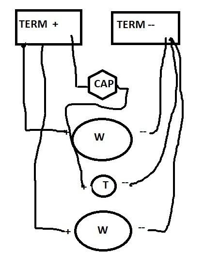

Okay guys, I checked the ohms and made a diagram of the crossover, such as it is.
The Kenwood woofers measured between 14 - 15 ohms. The MCM woofers (both) measured dead on at 7 ohms.
As far as the crossover is concerned it's about as simple as I've ever looked at. As you can see in my diagram, the negative wires from both woofers and the tweeter go directly to the negative terminal connector. The woofers positive wires go directly to the positive terminal connector. The tweeter positive passes through the cap then on to the positive terminal connector. I still haven't been able to determine the values for that little cap. I can't see it well enough to get the numbers.
Hopefully this will suffice. If still unclear I'll do as Tony suggested and hand draw one and take a digital pic.

Perfectly clear 🙂 So when you wire in both of the MCM's you are going to get an impedance of nominally 4 ohms, with a dip to possibly as low as 3.5 ohms. This is not too bad. I don't know anything about the lepai amps, but suspect that most amps that are rated to 4 ohms should be able to cope with that.
So I think that wiring the speakers as per the originals should be fine, and is the most sensible way to do it (without getting into the benefits of putting a proper crossover on the drivers rather than running full range)..

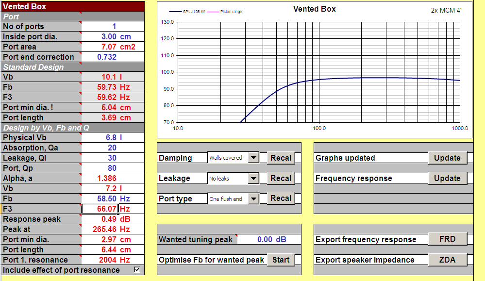

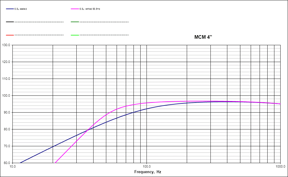

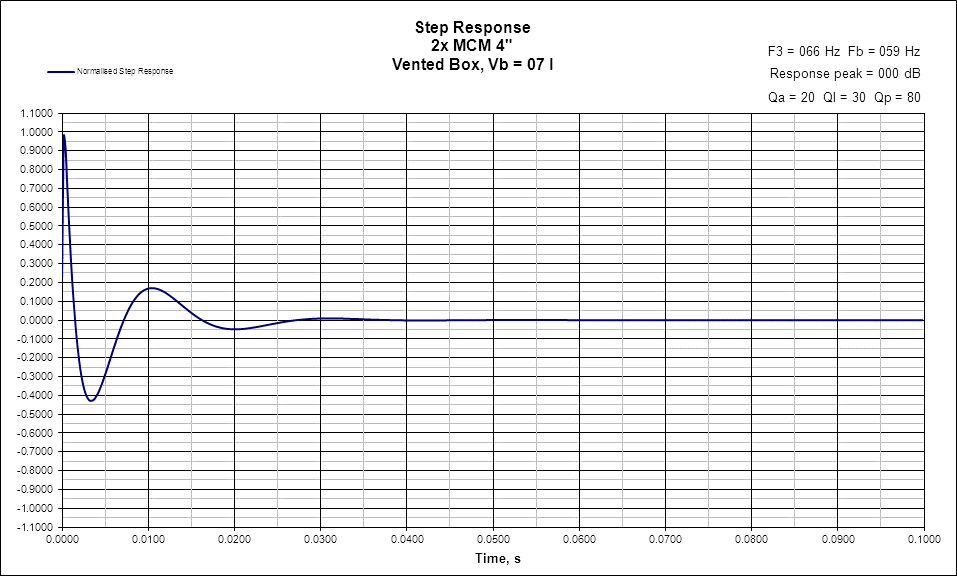

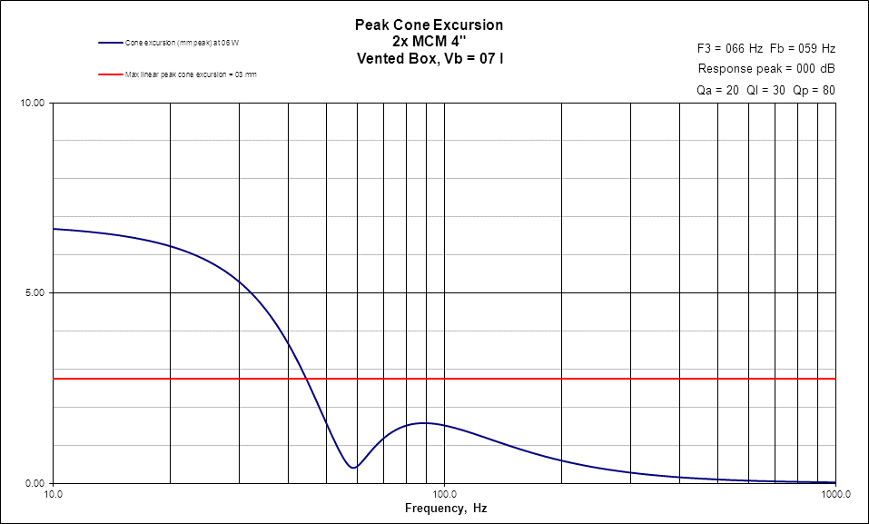

I just modeled based on the assumed size above (and an estimated sd of 50cm). Attached is a graph comparing sealed with vented in 6.8L enclosure.
I've also included step response and excursion graphs. Step response looks very good!
This all assumes that the volume I modeled with is accurate (which it probably isn't). The box tuning was 58.5 Hz. port was 3cm diameter and 6.44cm long. This could probably be placed in the back of the box. last attachment shows the unibox parameters.
Tony.

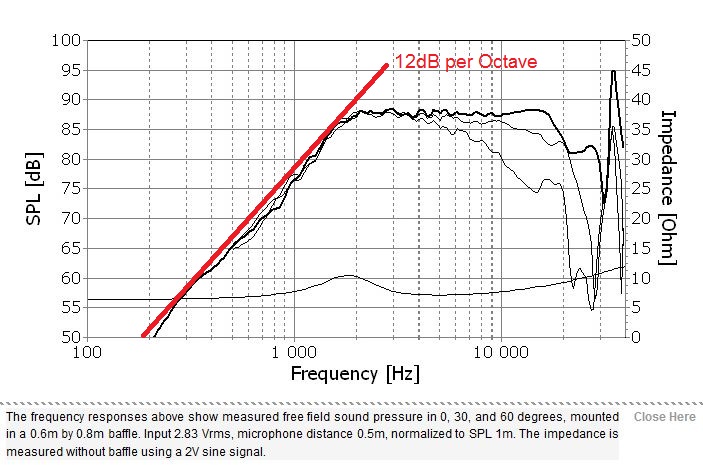

Your current kenwood crossover is about as simple as it gets, and can almost definitely be improved.
The original kenwood drivers may have a very smooth rollof allowing them to run full range. The MCM's have some breakup due to the metal cones, which could probably benefit from a notch filter, if run full range (based on zaph's measurements)

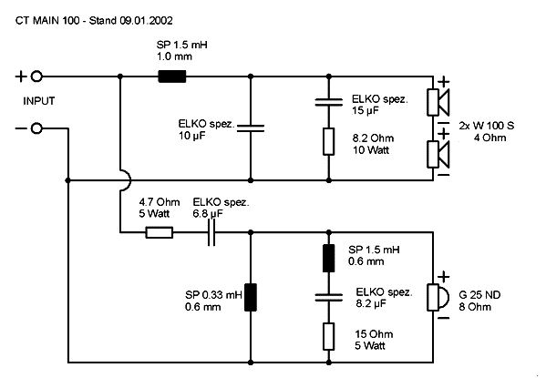

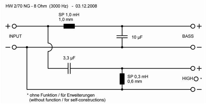

I do wonder quite what problem is being solved here. Do you really know where you are going on this?
Here, for interest and education is an old Visaton MTM kit using 2X 40hm paper woofers. A lowish 2kHz crossover which needs some consequent allowance for the nearby Fs 1500Hz tweeter resonance. Hence the unusual LCR tweeter notch.
CT MAIN 100
The whole thing is 8 ohms overall. The 1.5mH bafflestep coil boosts the relative bass level at the expense of pure efficiency. As ever, losing efficiency creates a smoother overall sound. For comparison, I enclose the 3Khz standard Visaton crossover which may need some simple tweeter attenuation. And a Fs 1700Hz SEAS tweeter so you might spot the typical Fs resonance. Since you have no idea of the specs of the tweeter, you can just sidestep the Fs resonance with a higher crossover point.
Despite what people say, a rough and ready crossover with well behaved drivers can work well. Unfortunately, metal drivers are rarely well behaved, tending to harsh cone breakup around 5kHz. 🙂
You will notice that the capacitor value doubles with the 2kHz crossover over the 3kHz crossover. This is because the crossover point changes roughly as the SQUARE ROOT of the tweeter capacitor and bass coil value. 😎
