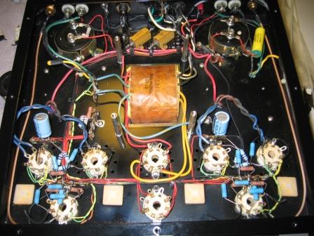

Pedigree aside, any tube can have shelf life issues and that is indeed a possibility that should not be overlooked. But if you have a first smoothing cap sized so far beyond reasonable design practice, you will probably continue to short rectifier tubes. You should crawl in there and have a look for yourself. Make a drawing. Maybe post some photos.
Here's a pic of the innards. (The coupling caps were being swapped out which is why they aren't there). Yes, I don't see a choke either. Only a C and R across the filter caps.

Looks like you have room for one of these chokes.
Hi Dave. My expertise is limited here. Exactly how would I wire in the choke? Mounting shouldn't be an issue. Thanks.
