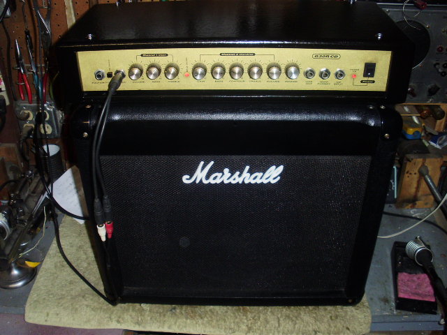

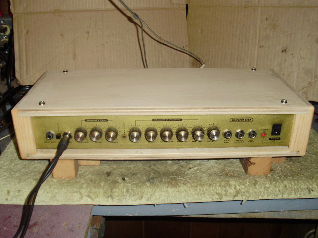

Still plan to build the 20W tube chassis, but now we got an option...

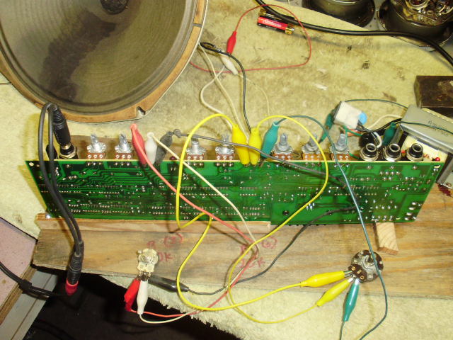

I got a chance to order the broken pots,,, just to see if they are the only problem with this SS chassis,,, I got the A1M pots yesterday, and got them installed,,, the other two are are "on their way!!!" So I clipped a couple pots in to try the amp and it seems to work fine,,, I'm going to build a more stable mounting system for the PCB, so it won't be so easily damaged...Here's the broken pots,,, lugs are all snapped off clean,,, not sure where they ended up,, they aren't in the amp...
